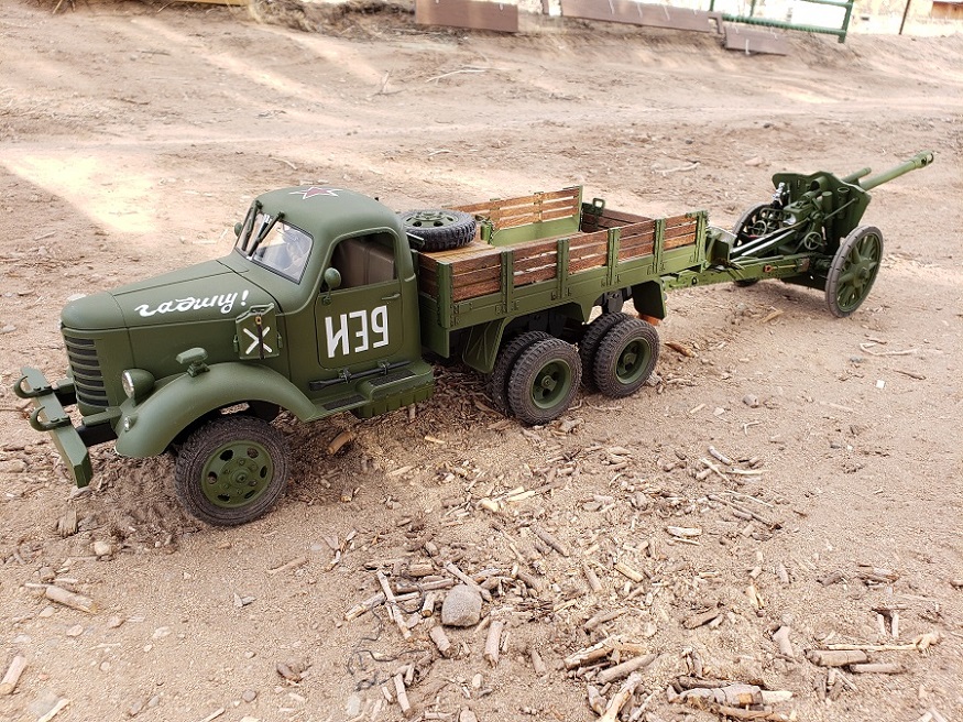

I found the JJRC trucks and transporters do not have nearly the proportional drive train or steering as the WPL. They look good but do not perform as well. I'm actually transforming a JJRC transporter into a tractor/trailer rig to pull my tanks around. I have purchased a heavy duty 2 speed transfer case with an 370 motor. I am also upgrading the drive shafts and axles to steel as well as upgrading to large dualies tires on both rear axles. I have spent far more on the upgrades than the original price of the transporter hopefully it will be worn it.

It takes some work but the end result is worth it.
44 International Harvester KR-11 Lend Lease Truck and 36 leFH 18 10.5 cm Field Piece.jpg
