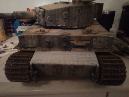

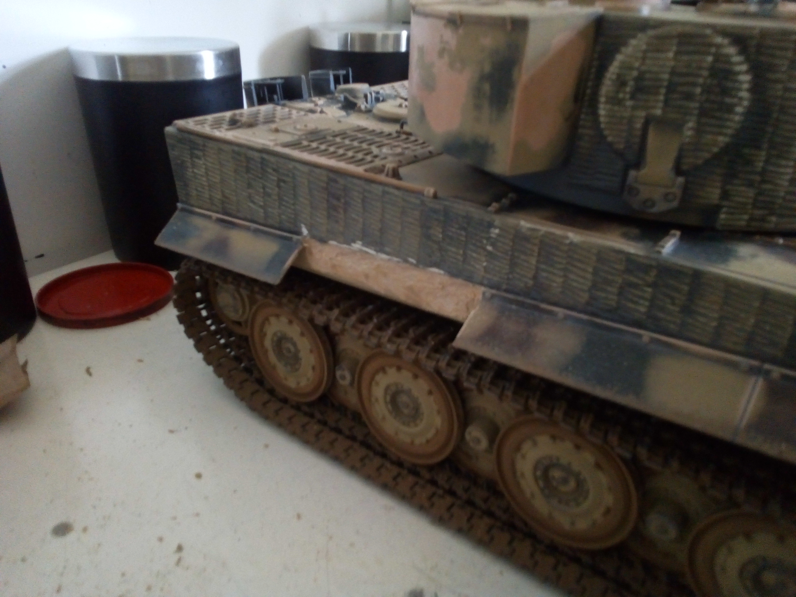

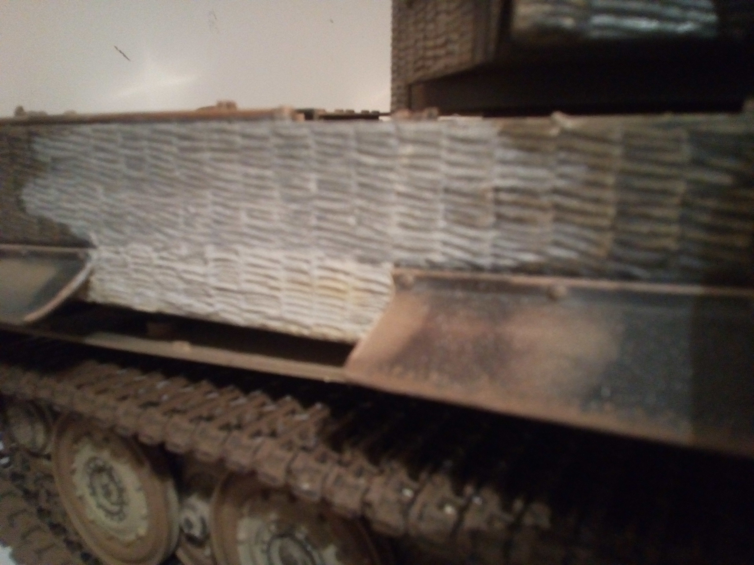

Removed the front track guards, and a couple of side ones. Roughed up the area behind the side ones so that I can apply milliput and extend the zimmerit down. When it was applied at the factory they did the whole of the sides and then put the guards on, so with the guards gone the zimmerit would be exposed.
It's going to be done as battle weary late war Tiger so will need to look as though as if it has been through a few battles....but not 'too' rough.

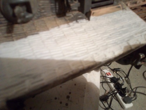

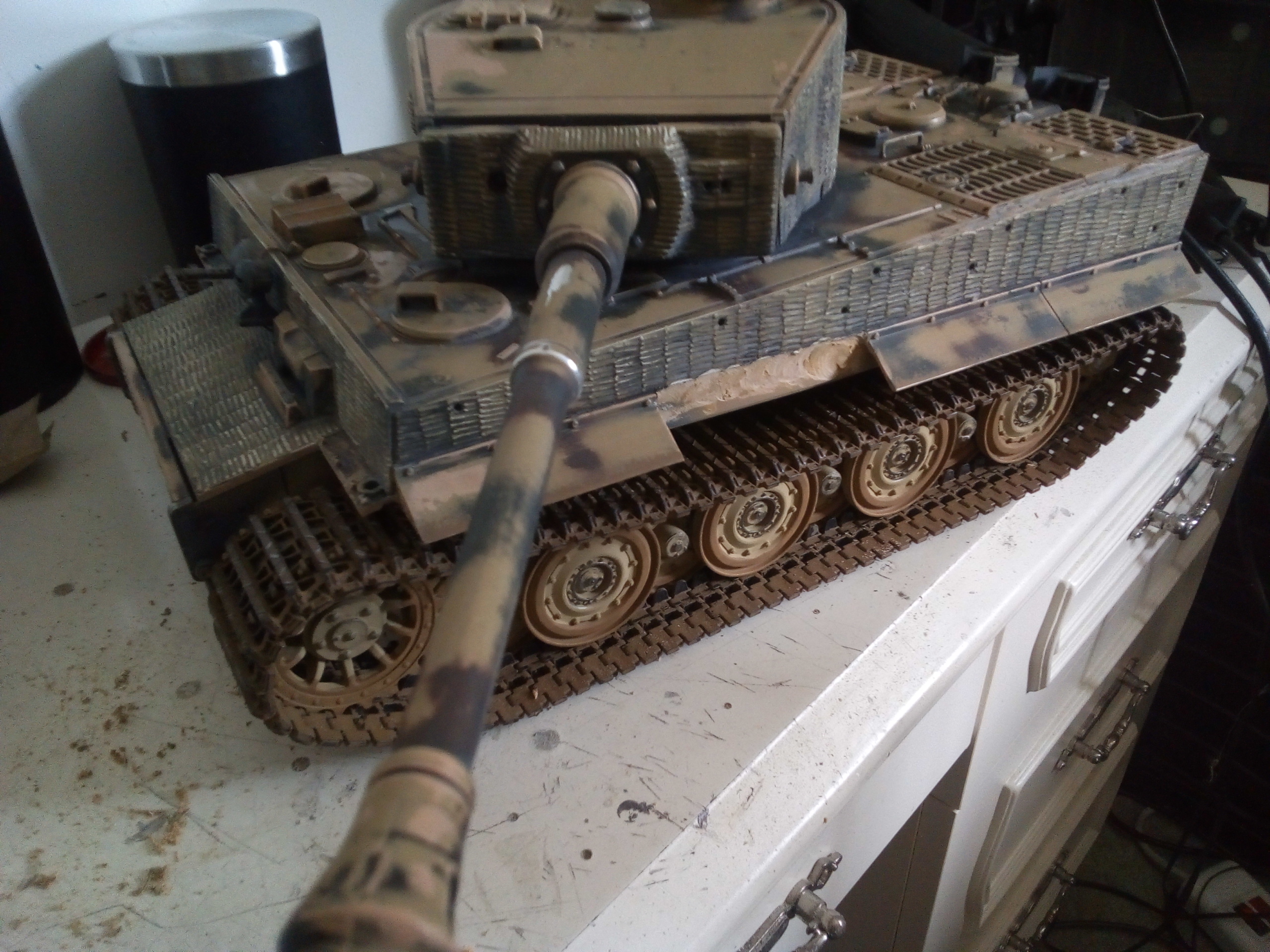

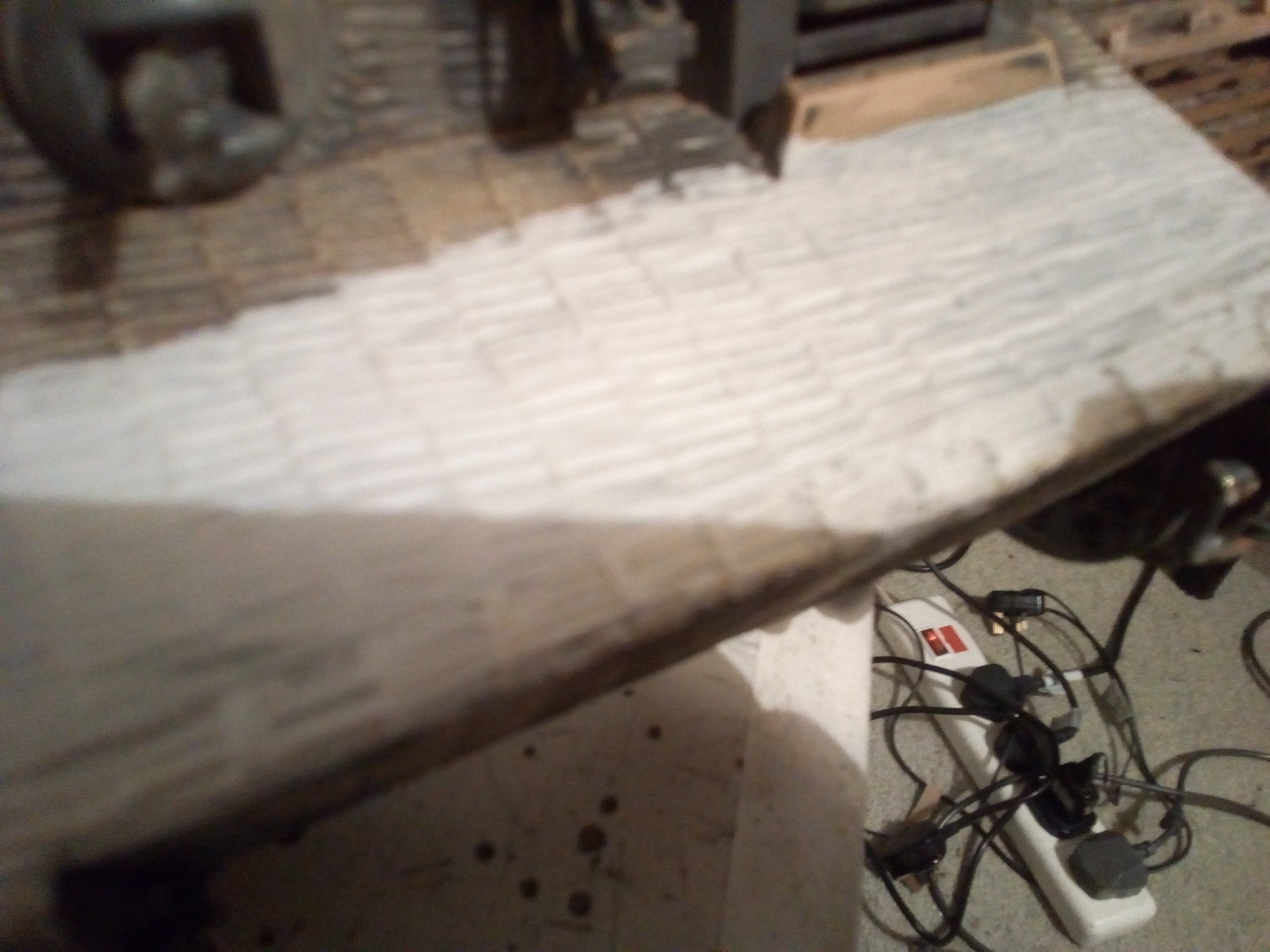

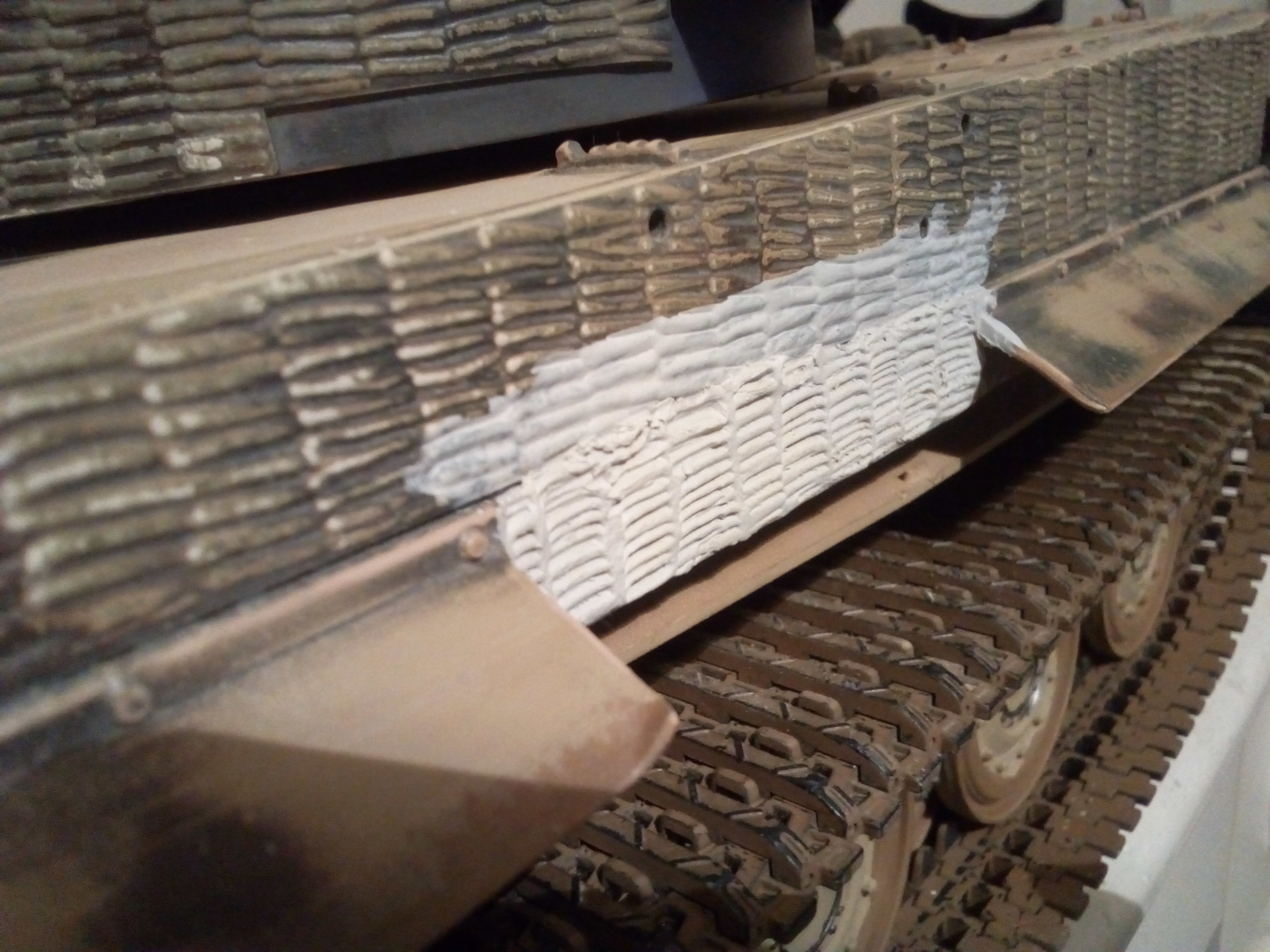

All of the zimmerit now applied, and I managed to find a screwdriver that is the same width as the original indents, so that came out quite nicely. All of the tools and the jackblock have been sanded off and all surfaces smoothed. Used a hot gun to bend the fenders slightly as well. I also did the bit that most miss, the ends of the vertical glacis should be sloped, Tamiya is the only manufacturer that did it properly, the Heng Long original fault has been copied across all the other manufacturers who copied their mistake.
The ariel stowage has gone, but needs some filler to neaten it up a bit.
I'll get hold of some brass strips and make replacement brackets etc, but do them a bit mangled with no tools. Looking at pics none of those pristine tools lasted very long in the real world.
Re: Torro Late Production Tiger 1 Restoration
Hate doing zimmerit with a passion, that looks great and matches the kit applied really well!

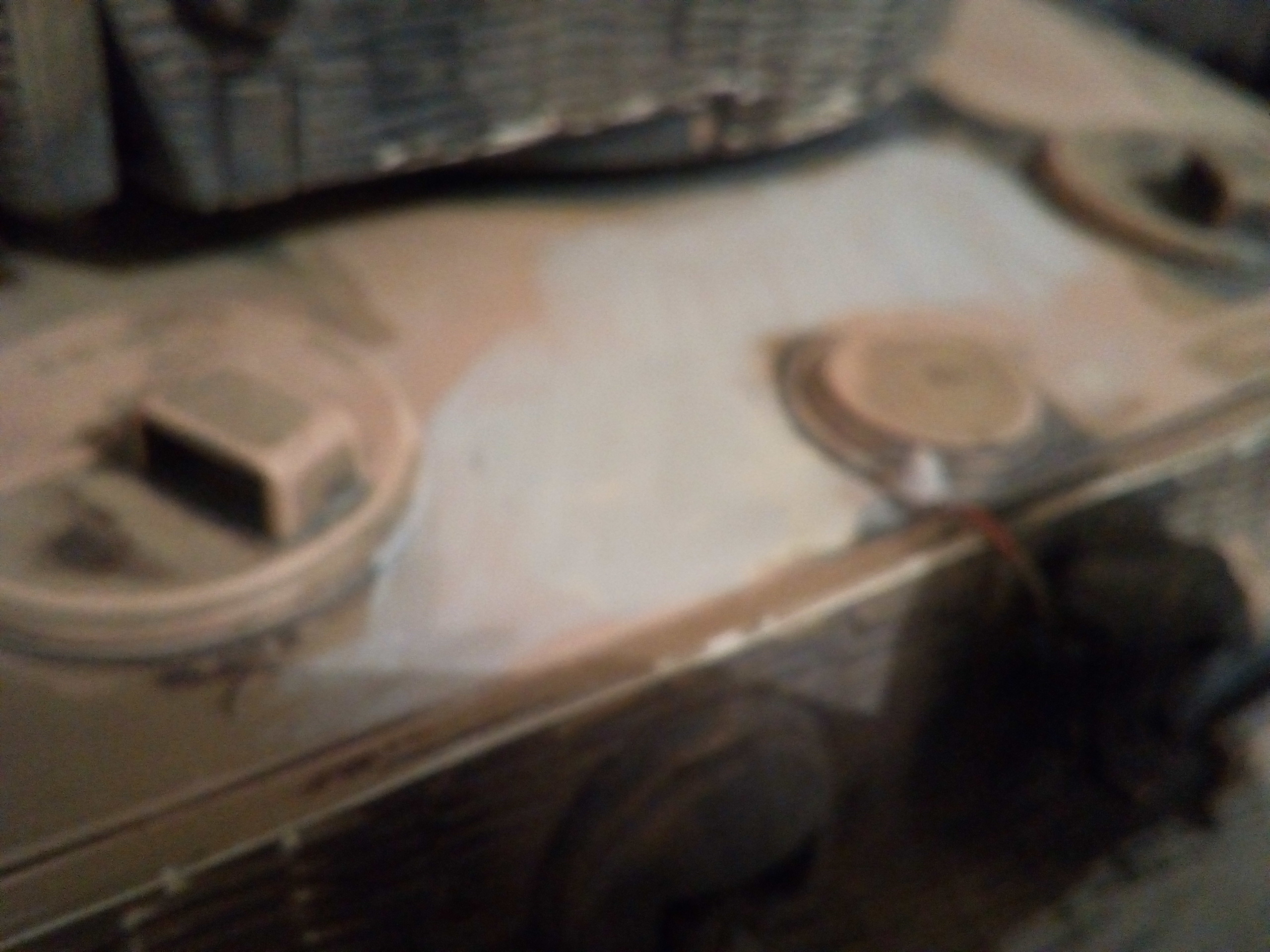

I just realised from looking at one of my own pics above that zimmerit is missing along the bottom of the rear turret, darn! Out with the milliput again.
