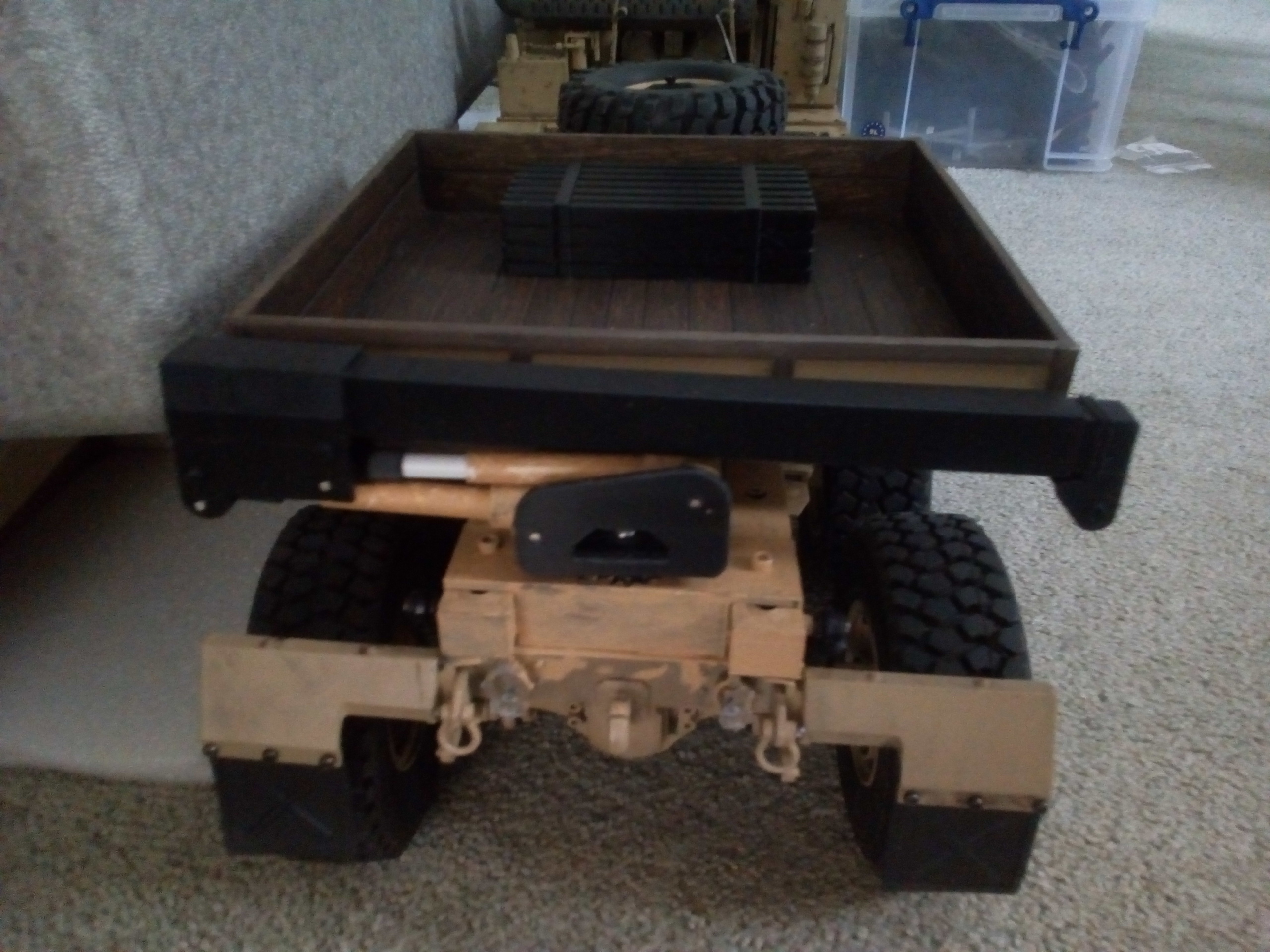

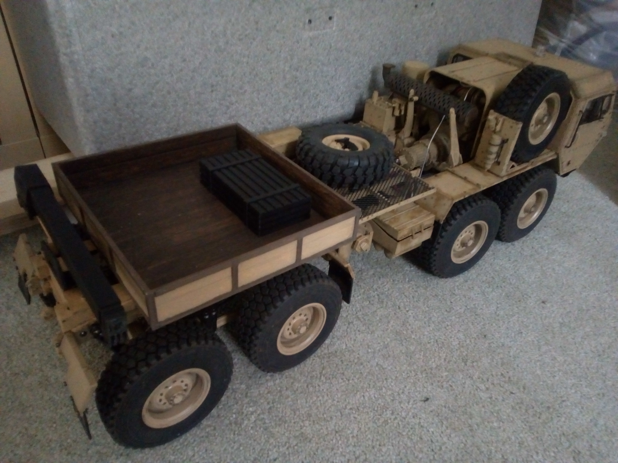

Built a crane, and added a load bed. I can't do the final assembly until some paint is delivered. I may then look at locking the diffs, which I have been told gives it better off road ability.

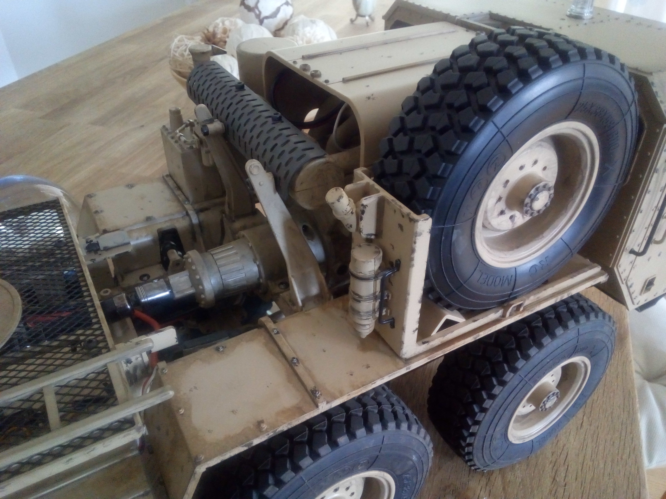

Heck Iain, yet another styrene masterpiece. I went over the truck comparing it to photo's and yes, there are quite a few inaccuracies, but I am guessing that the Chinese have to do this or pay licensing fees to the original designers (and those licences are 'very' expensive, with a limited timespan).
I tend to take my trucks out and run them over challenging terrain, so they have to be built to be pretty rugged. So I go down the route of as much detail as possible, but avoid detail that will get knocked off, or ground out on ascents and descents. It's swings and roundabouts for me.
There are only two things that peeve me. The tyres are too hard, so I will need to change them, and there isn't a huge amount of ground clearance. There is also a weak point in the diffs as they used a plastic diff casing. If I lock the diffs there is a risk of transferring the stress to the plastic and causing failure of the casing...but I will give it a go. Without locked diffs the climbing ability is limited.

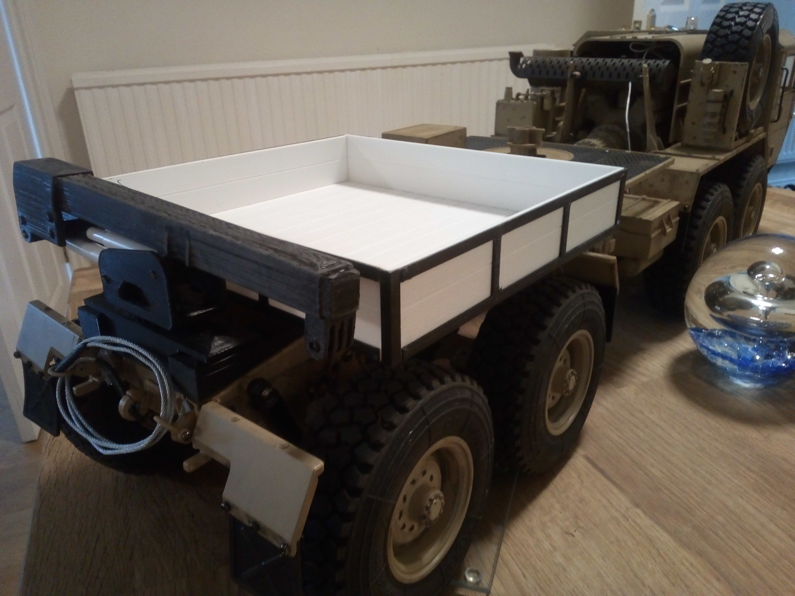

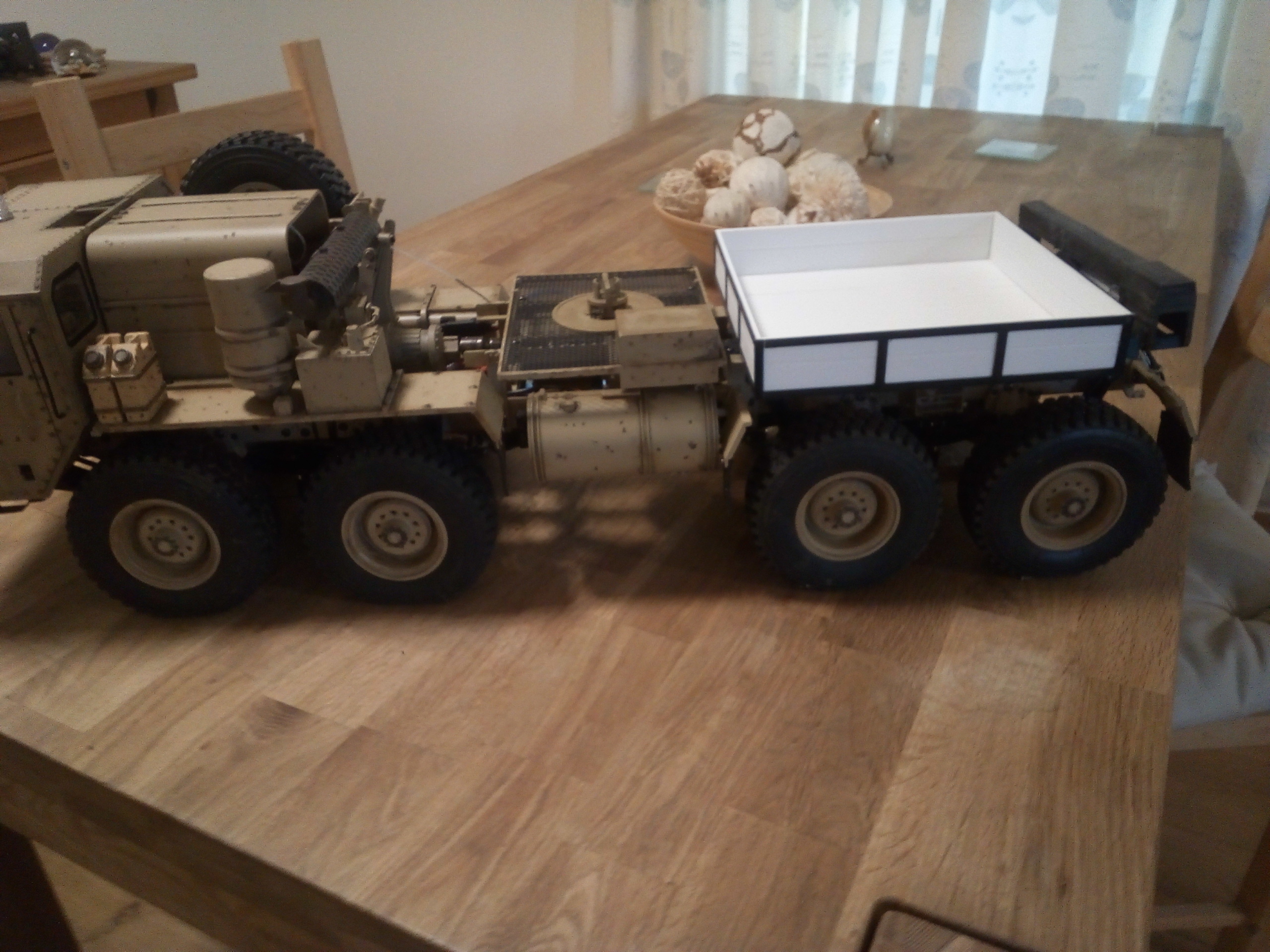

Still in progress, I test printed the crane parts under scale to check that it would all go together, and it does, so I can merge parts and reprint it again.

Is the crane functional?
Richard
- wibblywobbly
- Posts: 6396
Re: HG P802
Only manually, there is an extension arm inside the outer casing, I only printed a short one for the test, but it will extend out. The base rotates as well. The problem is that the hydraulic tubes are styrene and won't support the weight of the crane. I will simply assemble it all and glue everything in place, otherwise there is a risk of bits getting pulled off by undergrowth.

Thank you kind sir, I've designed it so that I could easily detach what I have added, in case I ever decided to build a transporter trailer...which would be huge, hence my reasons for taking this route. After the modelling is complete I intend to lock the diffs on the two middle axles so that I have some decent traction off road.
