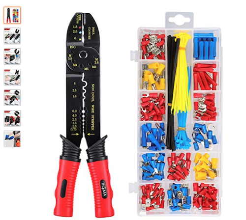

As a footnote to the foregoing, using crimp type bullet connectors to connect the motors to the controller would have been fairly straightforward. A crimping tool and an assortment of connectors can be had online fairly cheaply. They're also fairly easy to use.
This one can be had cheaply on Amazon. Just ensure that the joints are fully insulated, as Sub suggested.
Crimping kit
Crimping kit
Crimping kit.jpg (223.8 KiB) Viewed 7512 times

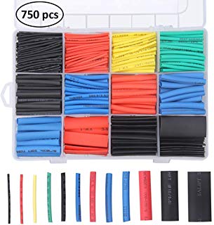

I link that now we will have to resume wiring? To achieve this, you need soldering iron 30/50 watts,
Solder,and thermo sheath for isolated,this seal wiring diagram RX 18 before TK-0.6
