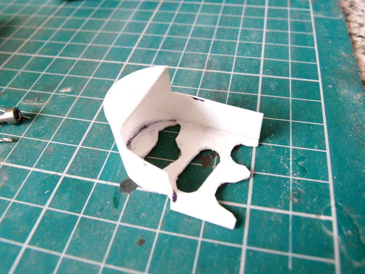

Make one probably zero cost , scrap styrene. One sheet of thin styrene would make about 50.
