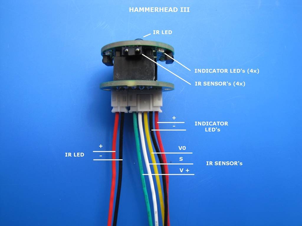

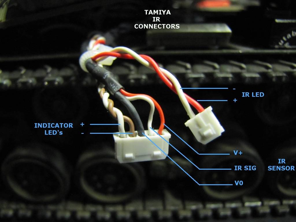

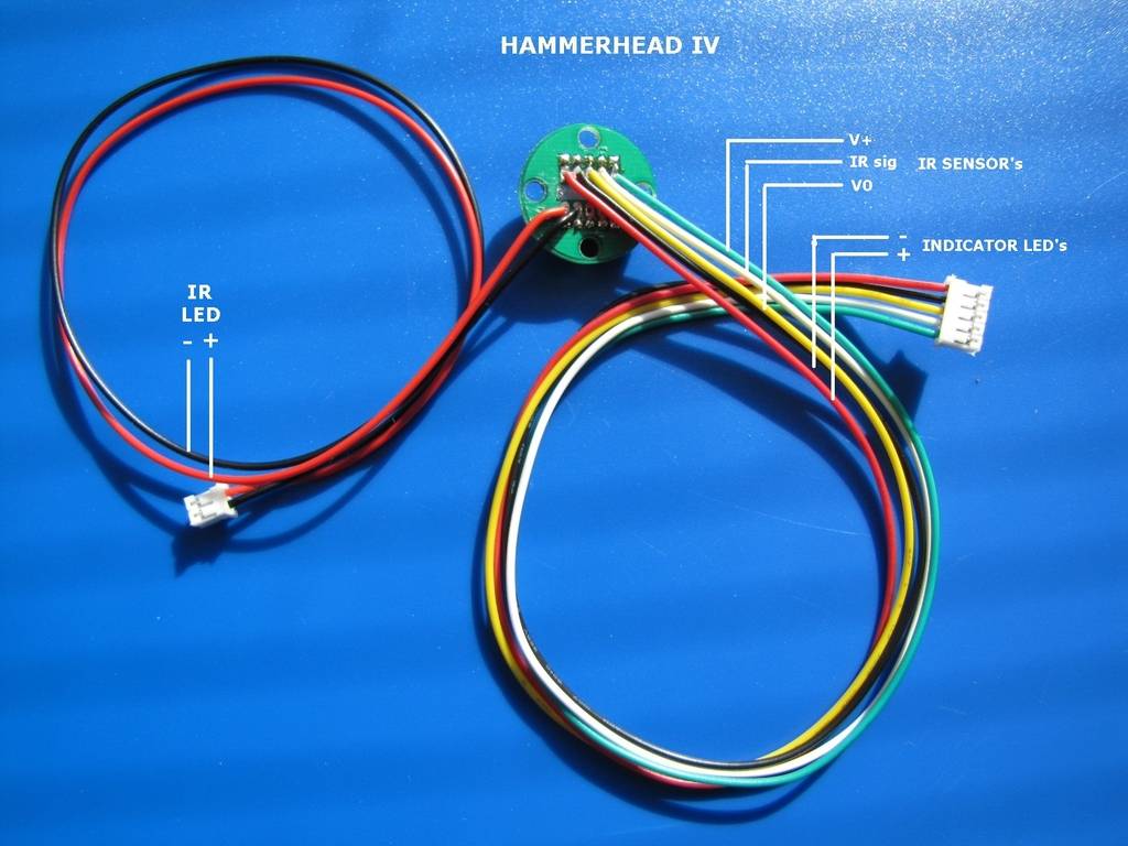

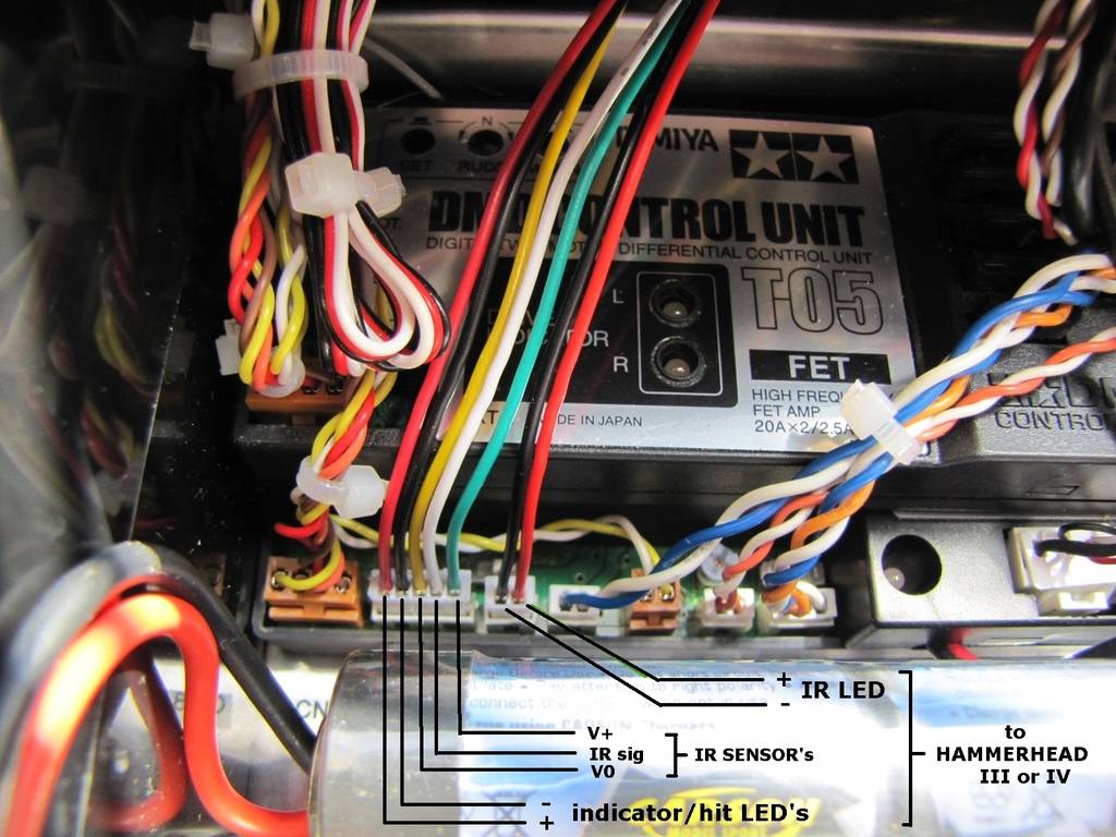

Jofaur86
Posts: 2172
Location: Centre France
Re: Tamiya battle system emitter
Post by Jofaur86 »
Hello :D
I do not know if can help ? But knows never ?
percy1510
Posts: 363
Joined: Sat Oct 04, 2008 5:22 pm
Location: Stoke on Trent
Post by percy1510 »
Great photos
I will have a look to make sure my connections are correct
Sent from my moto e5 plus using Tapatalk
