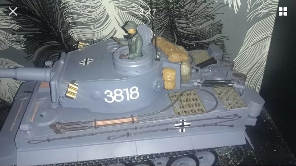

I’m keen to try out zimmerit on this tank as well as a proper camp job on it.
I noticed that the previous owner has also moved the antenna on to the left back of the turret. I’m sure on these they were originally behind, beside the grills.

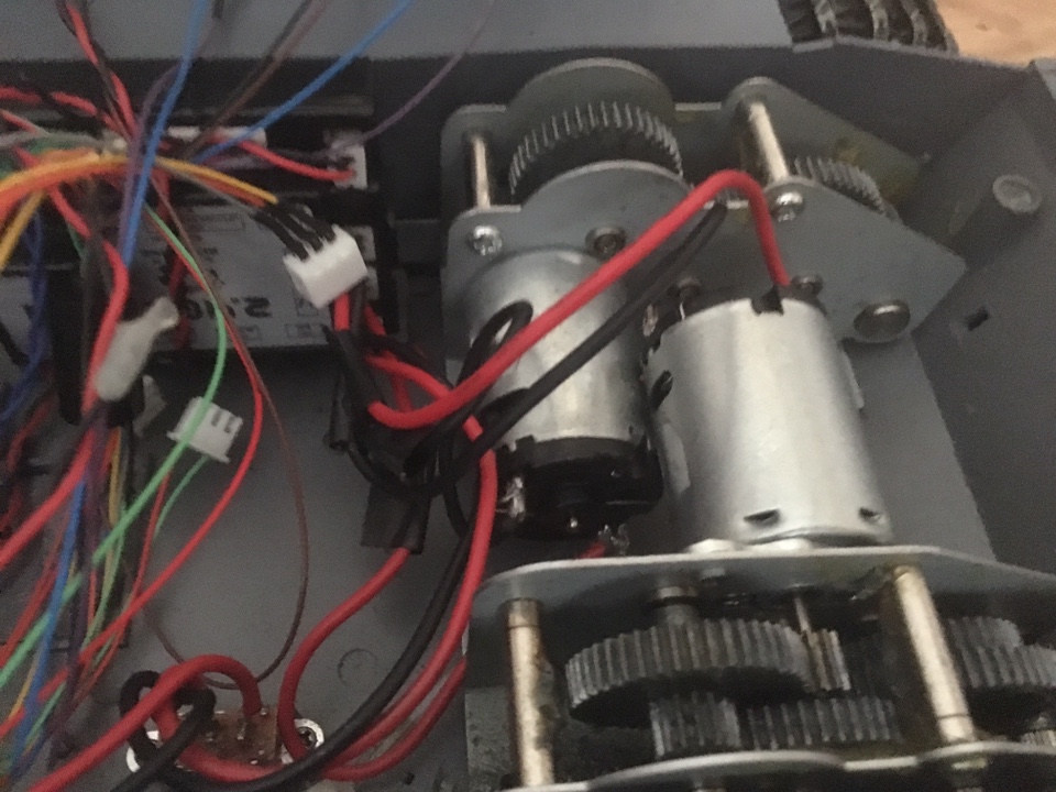

Just re-checked. It has upgraded gears (metal) as well.

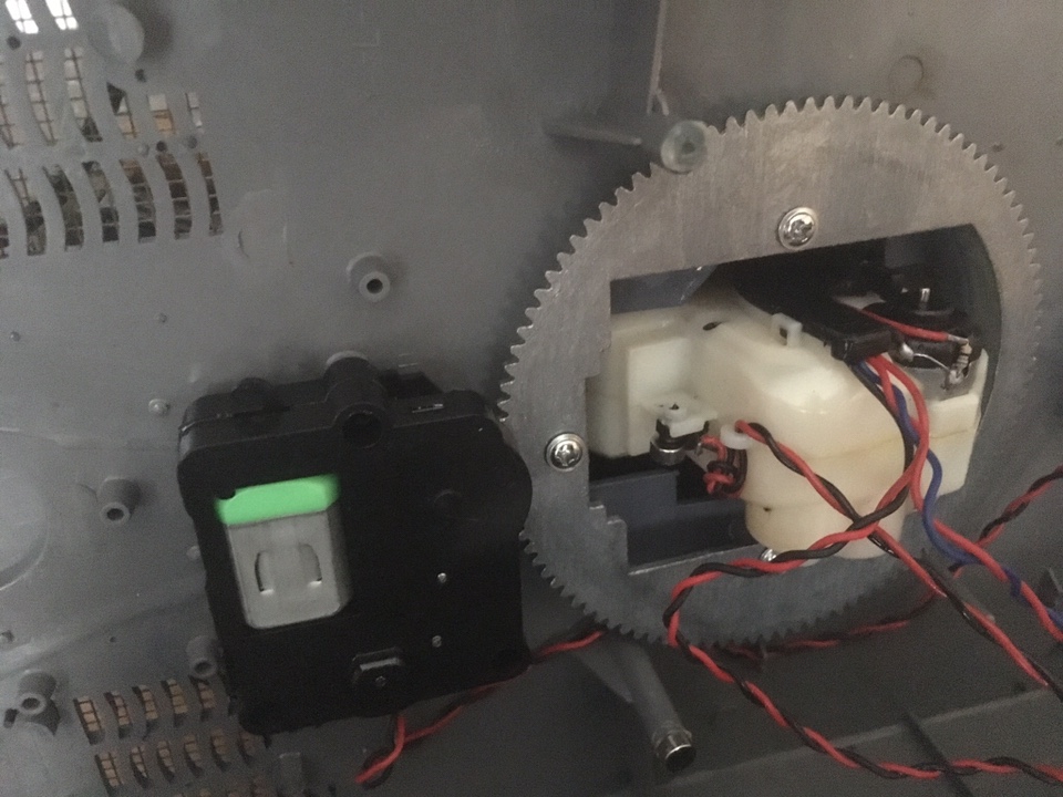

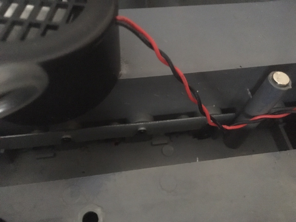

It has arrived and some pictures for you of the upgrades. Turns out it is the MZ Promotion version hence some of the upgrades...
...although I have to say, it’s a proper rats nest of wires inside this one!!!

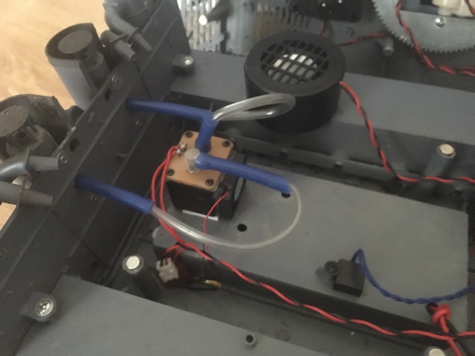

Does anyone recognise the smoker unit in this tank. I can’t seem to find a similar one online to know it’s capabilities.

That looks like a modified original (early) smoker :think:
Looks like someone removed the motor and piston, then did the fan mod.
Edit: it doesn't look like it'll have a small circuit board, so it won't be able to be made proportional without it, but if it's working, it should pump out more smoke than a standard one, but it should be a steady stream.

Thanks for that. Quite a neat mod.

Yes it is neat and smaller, we have a thread about doing it here on the forum somewhere. I've bought a few little fans to try it myself :thumbup:

Here's that smoker mod thread.
HL smoker pump replaced with a fan - RC Tank Warfare
