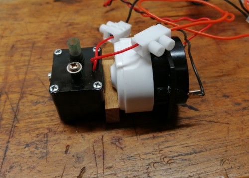

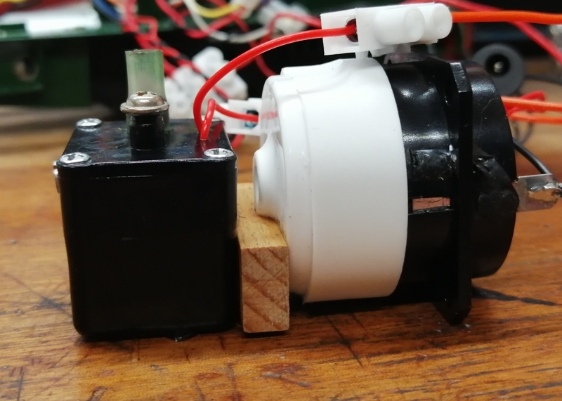

My version of an acoustic smoker is similar to
strmnd54 efforts using the same speaker (Aura Cougar NSW1-205-8A) which has made all the difference from my first attempt!
The smoke unit is cut from a 2018 Heng Long smoker and the only mod on that so far is I screwed the top the other way round so the heating element is not blocking the original air hole on the side (where the piston would be to pump air into the smoke unit).  I am running the heating element at around 7v using JT's Mega Steam.
Once I get it all fitted inside a loco I will see if further adjustments are required but pleased with it so far
