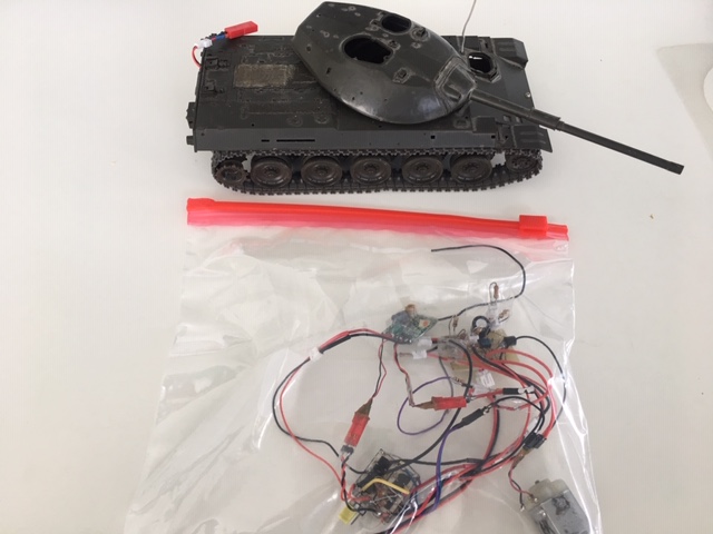

Thanks gunner. Yes it has SUPER low speed control thanks to its custom built ESC enhancement circuit. I developed this circuit about 30 years ago for a wheelchair controller job at that time.
I guess I have an eye for that sort of thing because I have much experience in DC motor control due to the nature of my work experience.

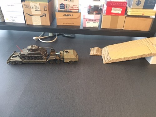

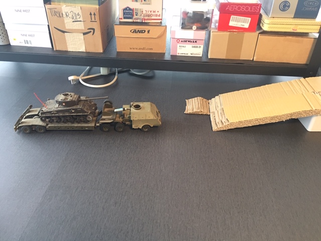

Here is a video of a Japan Type 74 Tank climbing the ramps of the Tank hauler.
https://youtu.be/9kPrA2e3q2U

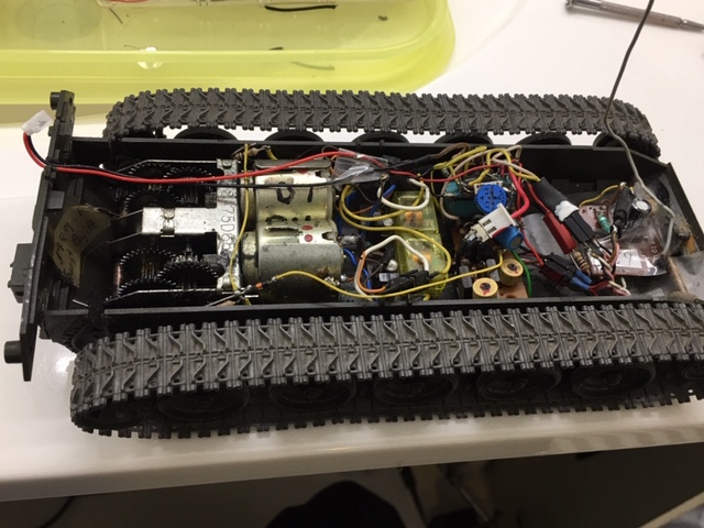

The electronics in here give this Tank SUPER low speed control. This version built in 2000 and has worked good since then.

The circuit that is in the Type 90 is in the bag. I am waiting on new 2 pin micro 1.5 JST connectors.

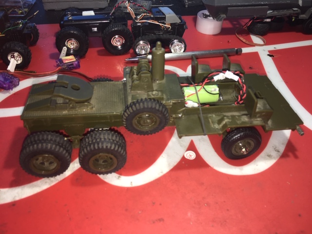

New wiring with ni-cad cell. Tire switch works as stock.

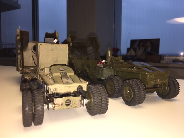

this time the underpinnings will look mostly scale and stock. so far so good with the mods it still looks stock. Soon I will post the underside of the 41 year old Max Tractor to show its front end and working parts. Warning! not pretty lol

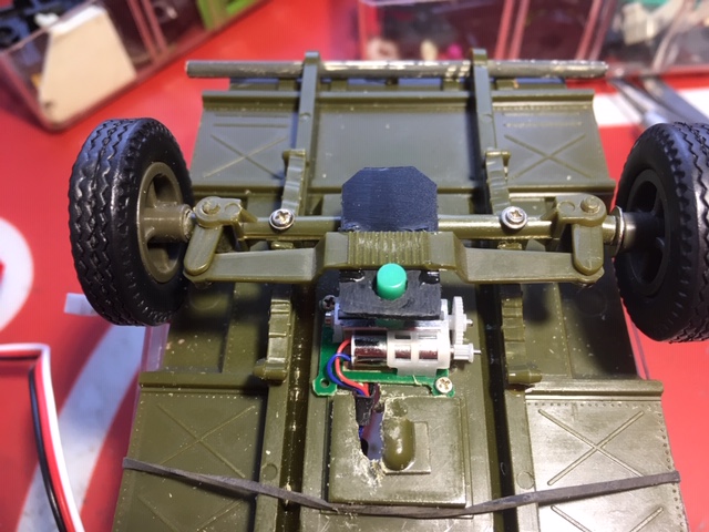

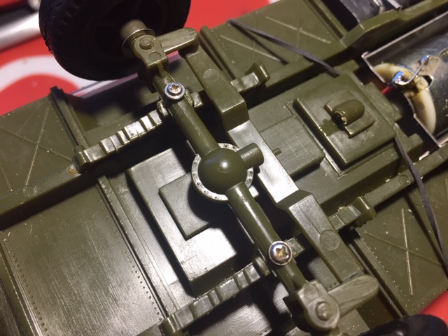

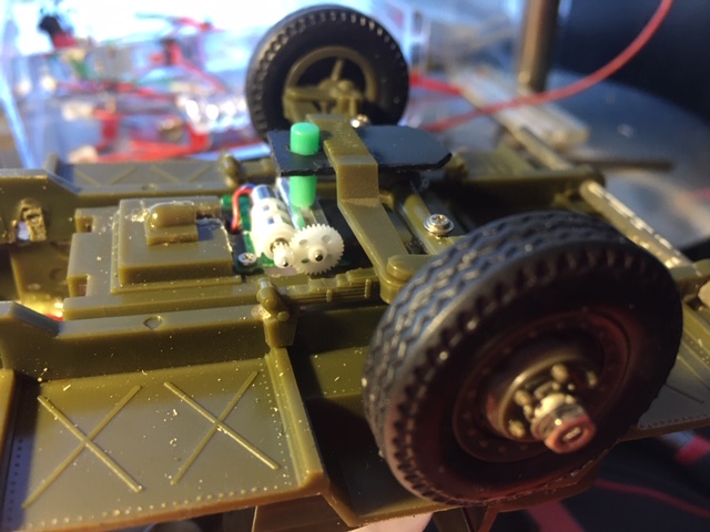

Front axles has been modified but looks scale. Steel axles added and front axle is removable as it is secured with 2 micro screws. Getting it ready to stear via radio control.
The front wheels have been replaced because they would not roll and they were plastic. These are wheels from a 1/35 M3 Half Track. mounted to stock axle with small screws and nuts, steel axles.

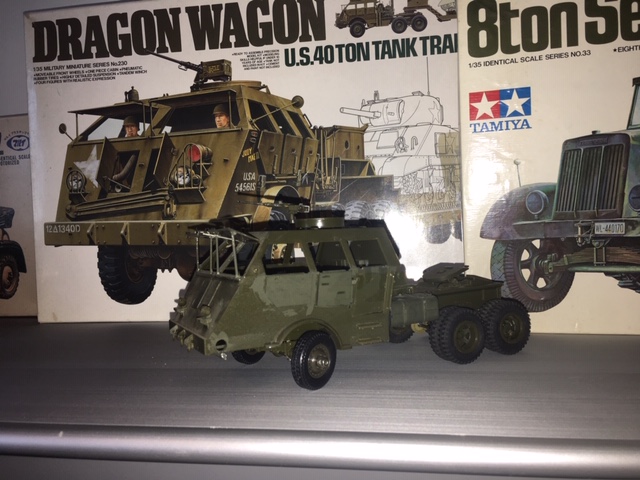

Shown here with a Tamiya model which will eventually be built as a motorized radio control scale model.

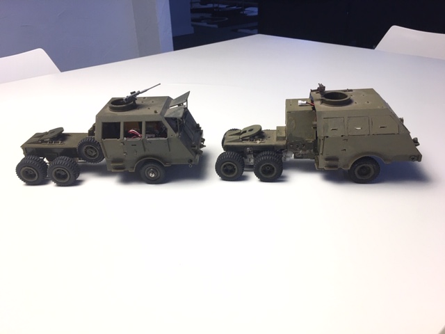

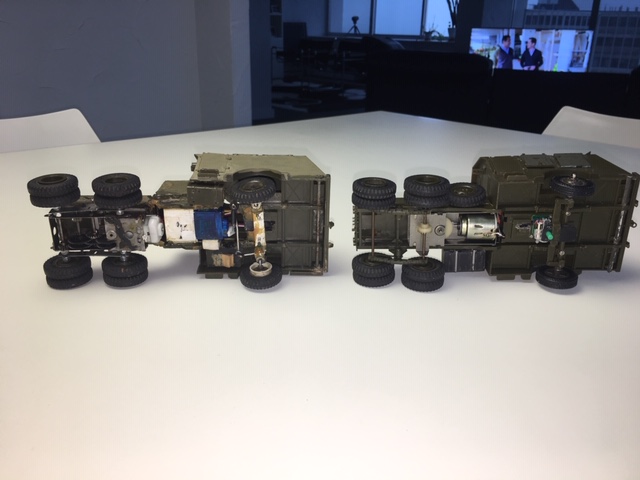

Got the P-max Tractor converted to RRC 8) I will do a picture comparison of both of the models. The first one which is 40+ years old is still running good and I now have two of these models converted to RRC. Both are D-Proportional steering, throttle.

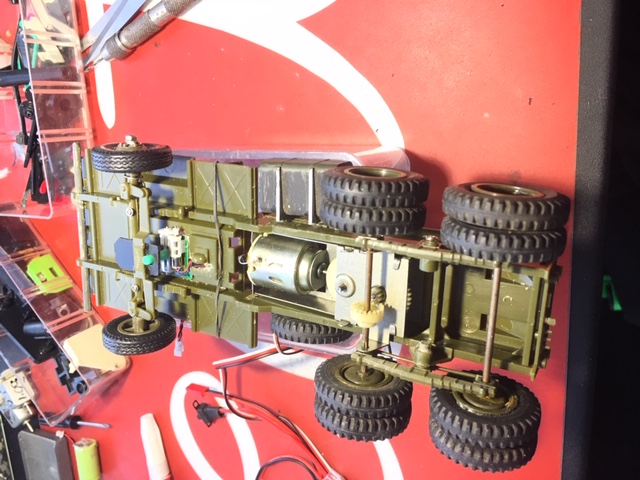

This is the newest Peerless Max in the collection. You can see the stock single axle rear drive system here.

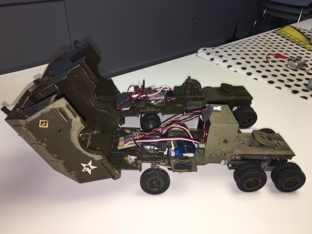

The ebay P-Max Tractor now is fully RRC.

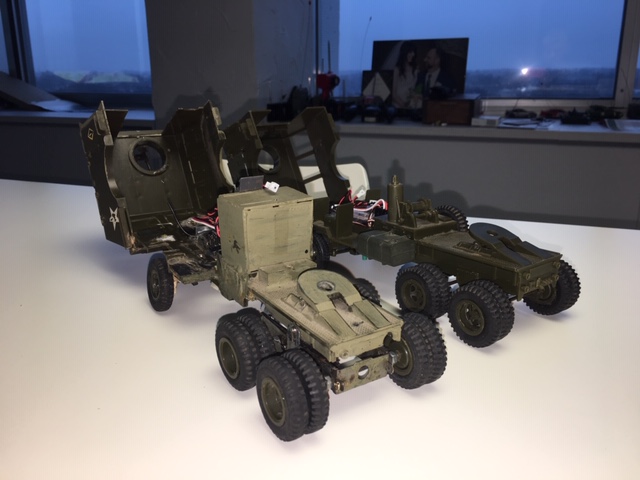

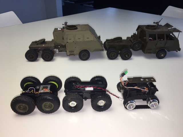

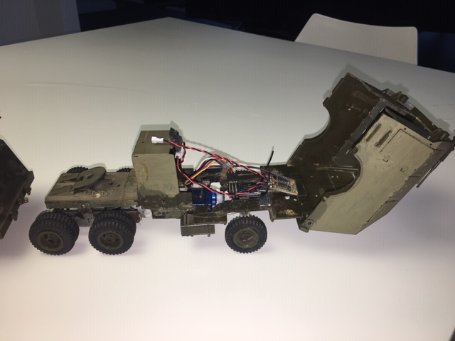

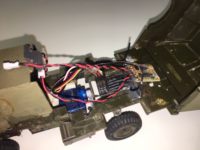

New pictures of both Trucks showing radio gear wiring revisions and underside chassis shots.
Both Trucks are 2CH DSM2 RRC. Proportional throttle and steering.
Can run on 1s, 2s cells. For table top running, I use 1s. ;)

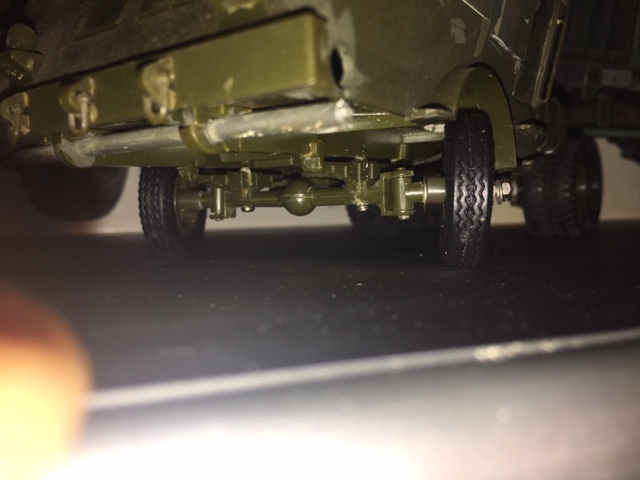

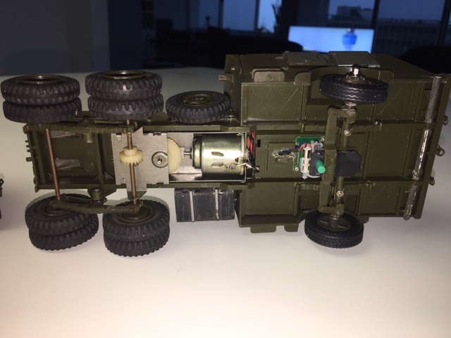

Stock 2WD rear axle with plastic reinforced with metal front end with DP micro servo. Looks more stock and uses stock components<br /> but not as robust as the full mod metal front end on the first M-26 Tractor.

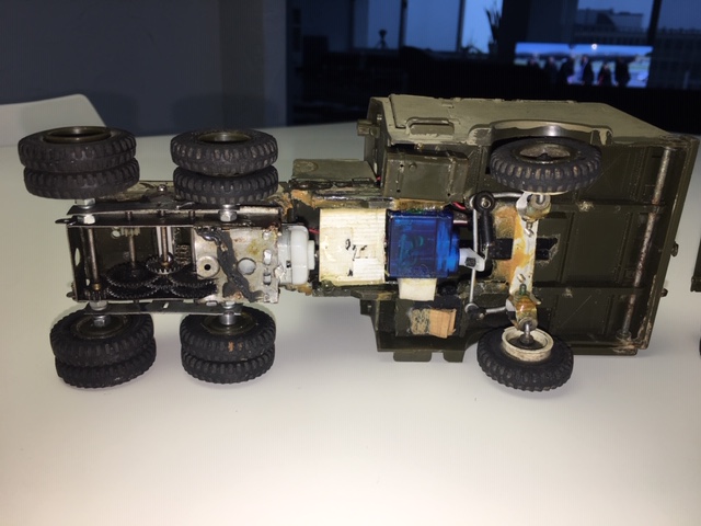

This all metal front end and rear axle is more robust and can run off road and has for many years. The 4WD mod to the axle has just recently been perfected.
On the left shows the original but modified 2WD into 4WD axle. This gives the M-26 Tractor much better traction when hauling a Tank load.

Below are a few 4WD rear axle setups I used on the first model. On the second and latest M-26, I used the stock 2WD axle.
