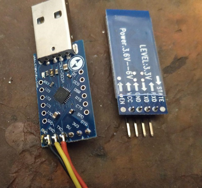

Well, I could not wait more, so I had to experiment. I dont have the elmod bluetooth module, but I do have the USB programming cable. I imagined I was going to find the pin names in the board, so I removed the heatshrink tube and BINGO
On the left, the elmod USB connector.
On the right, the less than two euros-free shipping aliexpress bluetooth module.
The elmod bluetooth module has 4 wires. The fourth is obviously the VCC, and that is the one that powers the module.
So Id say, mistery solved. I will create my own module this weekend, so now we know how to create a bluetooth module for our Elmod, saving some dough on the way.
I hope to not to come back here in some days talking about some magic smoke, lol.

Well, news here, I could now wait until the weekend, lol.
I wired my bluetooth module exactly as the USB plug, and I connected the VCC pin the same way as the Elmod bluetooth module. Then I connected it to the board, installed the phone App, and also powered my computer on.
Then I looked for bluetooth devices, and I could not find the Elmod board...
So I wonder if the module has to be special for Elmod (some kind of propietary module), or if we are missing something. At this point I think I need the help of somebody with propper electronics knowledge...
EDIT: After a while looking for a bluetooth module with the same shape as the elmod one, I belive the module has his own design... So probarbly it will work only with the original board.
EDIT 2: Dont lose hope! The Elmod USB is not self made, I found it in aliexpress: https://www.aliexpress.com/item/USB-2-0 ... 35e71b1600
So that makes me have faith and to think that he is using an existent bluetooth module.

I have a button on my bluetooth module to pair the module with the phone, do you have one?
- Rad_Schuhart
- Posts: 2089
Re: Elmod Bluetooth DIY module
I will say what germans call "Jain" (Ja-nein) (yes-no). Lolwibblywobbly wrote:I have a button on my bluetooth module to pair the module with the phone, do you have one?
I got two of the modules. I used one of them in my radio viewtopic.php?f=81&t=24954
That module had the button, but I had to remove it, and to put a wire from the EN pin, to the called pin 34. (not showed in the picture) Why? I dont know, I just followed some tutorial from the open rc guys. So in my radio, the module is connected with 5 pins and it works, I can detect it with other bluetooth stuff and program it with the computer and so on. So it works.
Then we started talking about this idea, and I decided to order another module... But it seems I screwed it and I ordered a module with no button. Due to in the radio I had to remove the button I thought it was not going to be important. But after seeing it does not work I tried bridging it, and from blinking fast, now it blinks slowly, but I am not sure if I am missing something. I will keep trying different combinations, but I might end ordering another module with the button, but due to the EN is not connected to the elmod board, it might not work. I also tried to connect the EN pin instead of the VCC, but then the module wont switch on.
Meanwhile you can also try and you can tell us... I can assure you the conecction is safe, and it wont blow anything.

On my board with the button, I am guessing that this pin needs to be connected to power it. This leaves the other wires to hook up.
When I get some time I will try to hook mine up, I wish I could have made it to the last tank club meet as I could have looked at a genuine Elmod one and maybe see where the wires go. The next meet is in March, so I might wait till then.
- Rad_Schuhart
- Posts: 2089
Take a look to the back of the board, I think there is a track connecting it to VCCwibblywobbly wrote:Famous last words...Meanwhile you can also try and you can tell us... I can assure you the conecction is safe, and it wont blow anything.![]()

Hi 43rd, all my experience with bluetooth started 4 days ago, so I am green here... But there are several things that can be tweaked in the bluetooth modules, like the baudrate. I have to keep digging on this, I will try experimenting until it works or I set the tank in flames.
So far, it seems the button is quite important, so I ordered another module in aliexpress with it. When it arrives (in 60 days or so, lol) I will try again.
