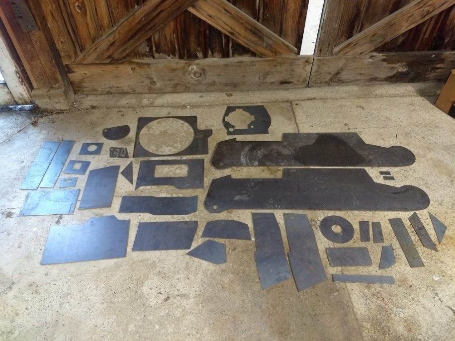

As promised here I present to you plates before I start welding. Hopefully next week I can start putting it together. Still need a few holes drilled for the motor mounts
Plates for the model, cut from 11ga steel

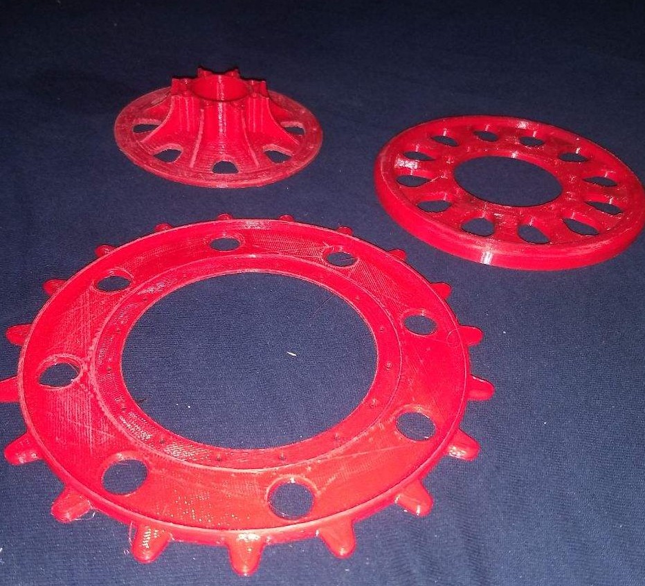

So I had forgotten that I had used up most of my prints in other experiments do all I have left are parts of the drive cog and an idler rim haha
