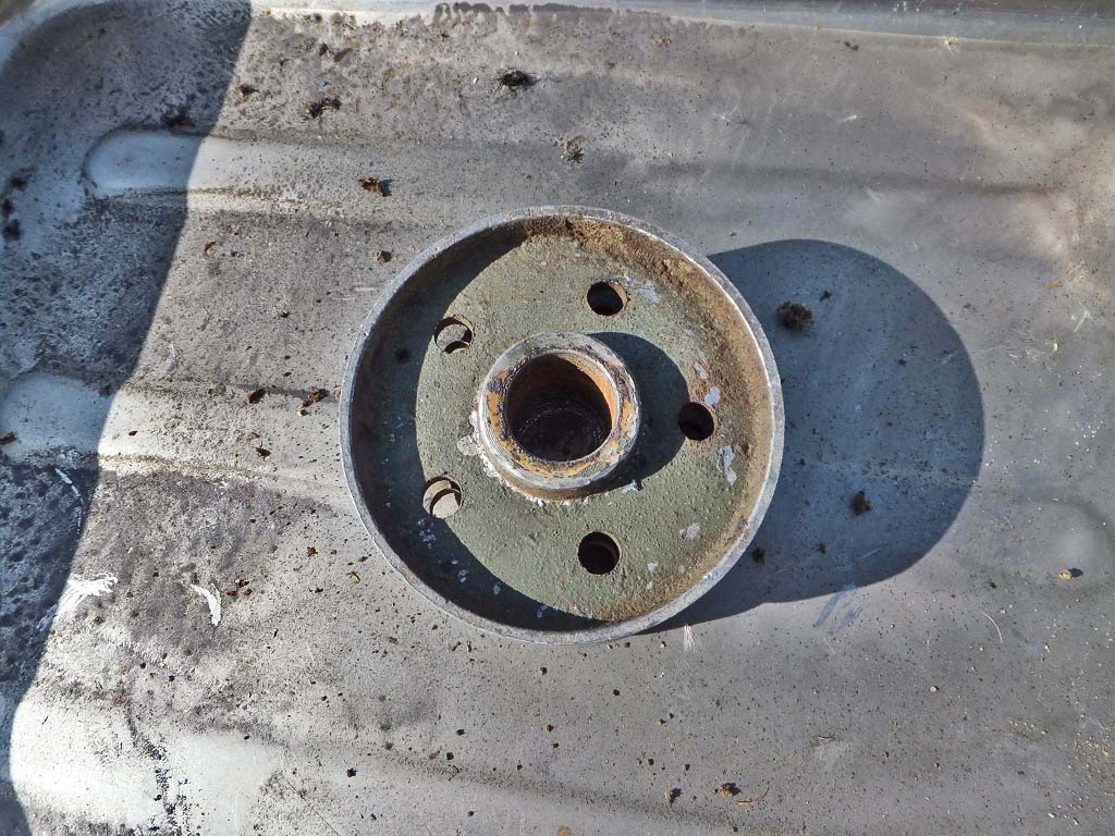

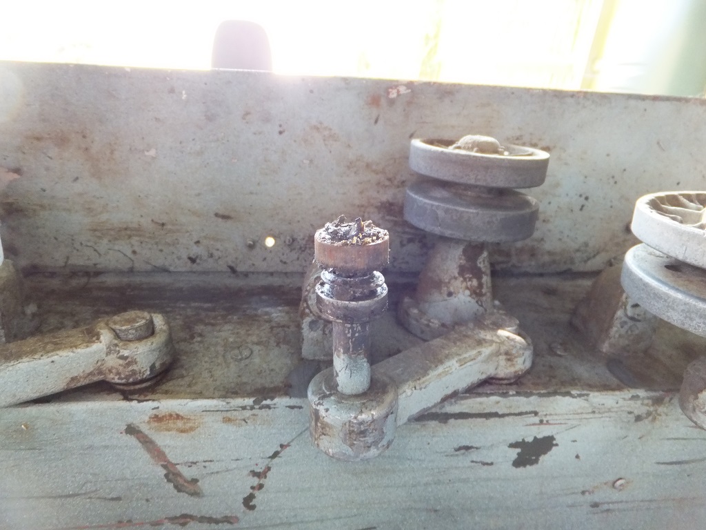

Re: 1/6 t34 project, here we go
The fibreglass had deteriorated and couldn't support the weight of the tank, so all the wheels were splayed out.
This was supposed to be the first step to getting it into a metal lower hull, but then I found so many problems with the wheels, the suspension arms etc, that I just shelved it until I could have a fresh run at it.
There is a lot of hull flex, mainly at the front so I will add braces to help.
Full steel chassis maybe later.
Do you know how to get the road wheels off?

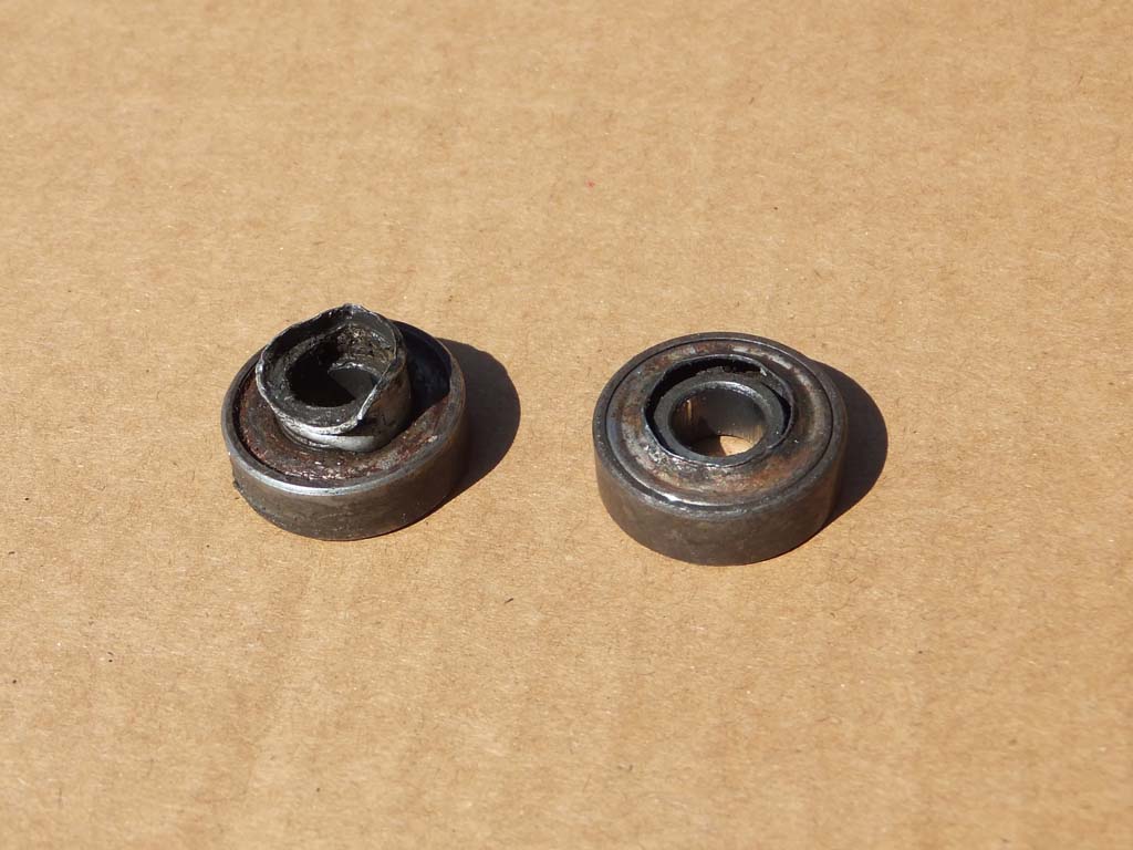

On the ISU-152 they were just epoxied to the bearings. I heated them with a hot air gun to destroy the epoxy and pulled them off.
The bearings are odd paired things. I suppose a pair of new bearings with a spacer would work just the same.
