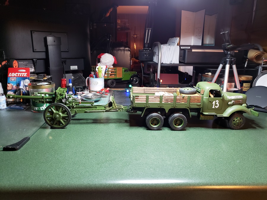

Good Morning,
Will is your man for these truck upgrades. I learned enough poring through the Truck threads to use a 180 motor and a 30amp ESC and some thick grease in the gearbox and differentials so that mine could pull a scale field gun through some rough going.
