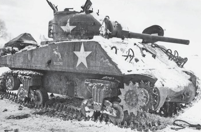

That is one sharp looking Sherman,
Nice job! I believe I have seen real pictures of "Caballelo" in some book somewhere.

Thank you for your comment. You've seen the actual photo of "Caballelo". My Sherman tank is failing on appliqué armor. The mistake is that the actual 105mm howitzer tank does not have appliqué armor, and that it has two appliqué armors on the left side of the tank. However, I don't have the energy to remove these appliqué armors anymore.

EAO
Posts: 1162
Re: M4A3 Sherman detailing
Post by EAO »
Thanks Jofaur86,
That's the picture I was thinking of! :thumbup:
Kintaroukinji,
Regardless of the applique' armor issue, it's still a very sharp looking Sherman! :clap:
