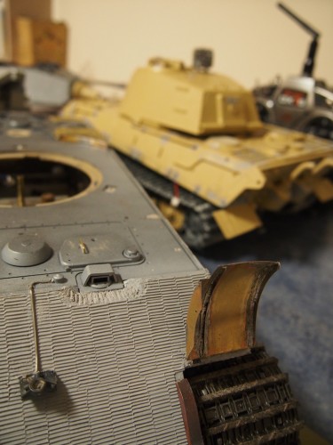

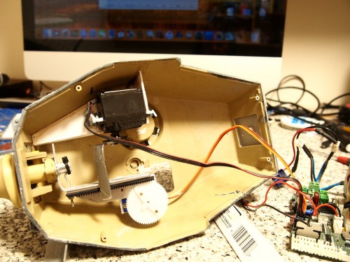

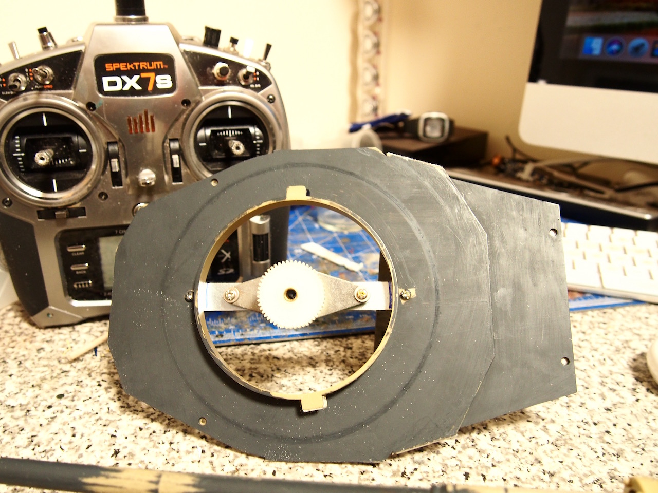

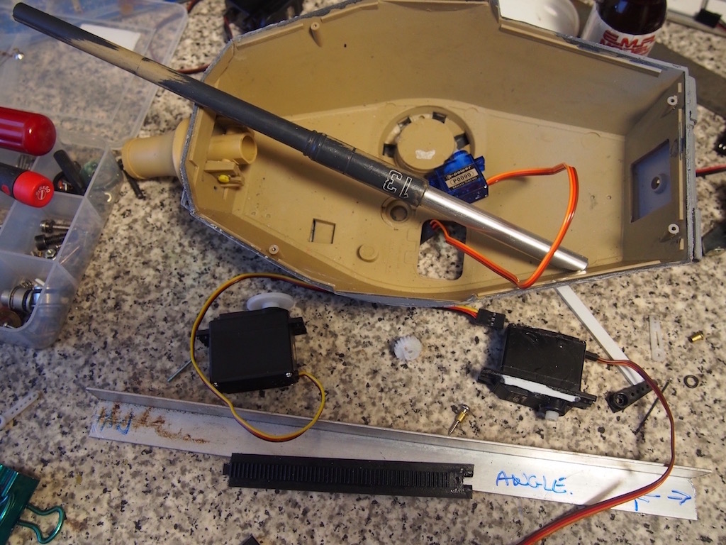

Thanks for info on Zimmerit tools, now onto getting turret functional. Trying an offset recoil as i would like to retain original turret rotation.
Re: 1st generation rc king tiger

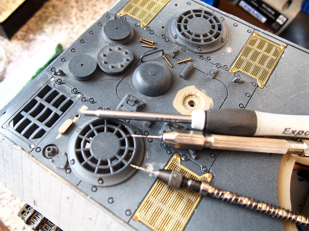

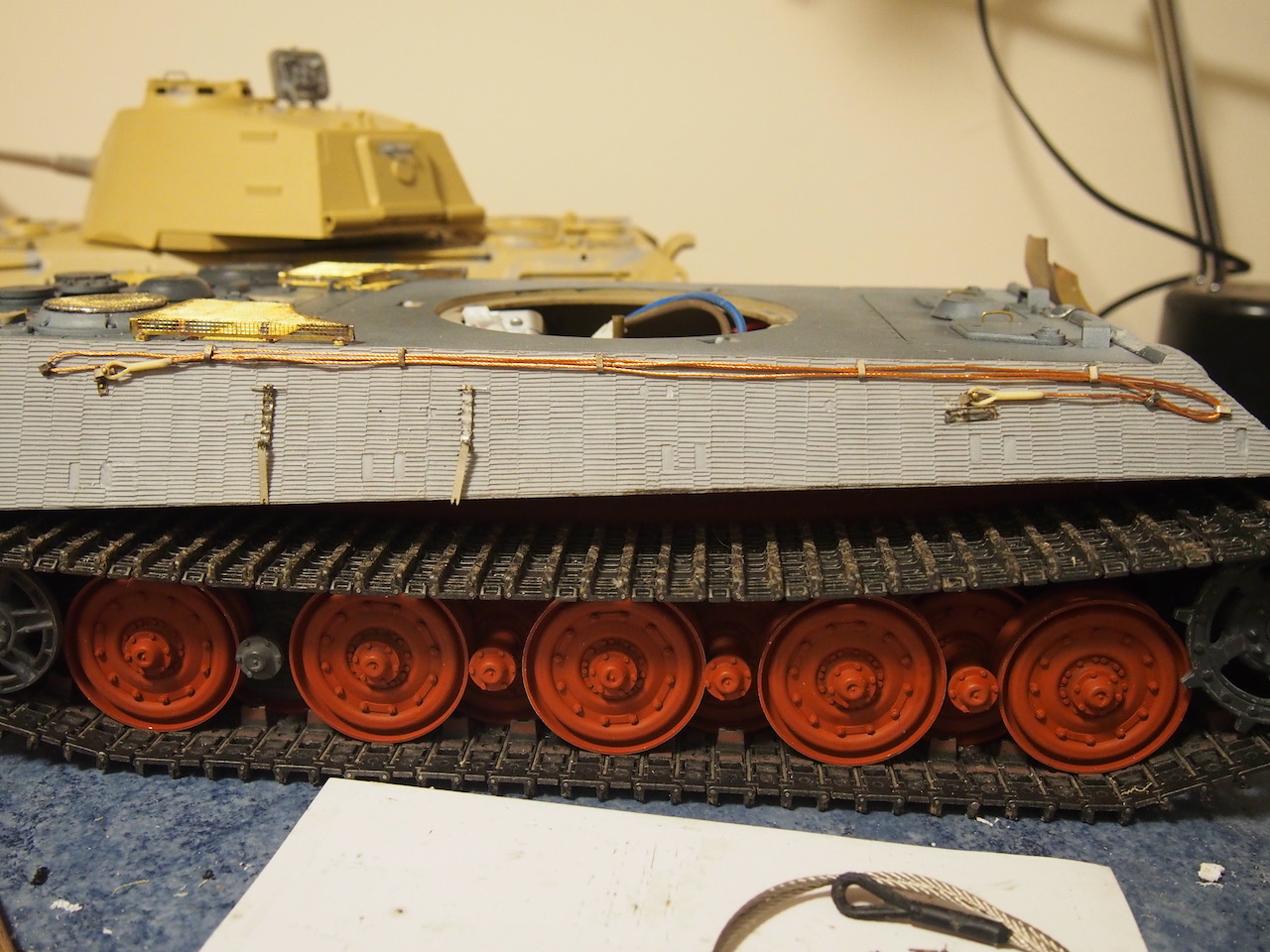

Fitting PE grills don't think they will fall off now. The Voyager Trumpeter PE grills are a tight fit. Have the modern Tamiya KT and the plastic moulding is exactly the same as this old version. With modern measuring aids i think thats why Tamiya and Trumpeter kits are slightly out.

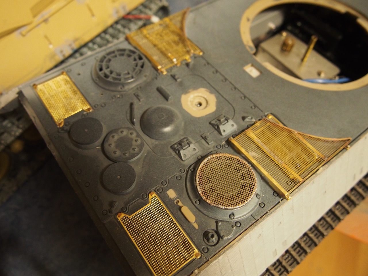

Fitted grab handles that look the part , why a blob of plastic for handles ? Started PE, better stay calm or it will not go well. Bad start, says form a wire circle and bend mesh around wire . I know its supposed to look real but why make it hard.

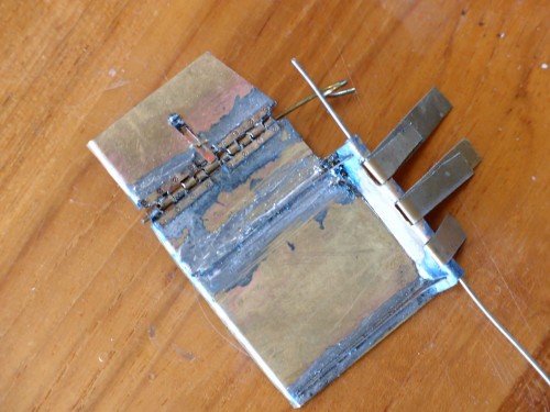

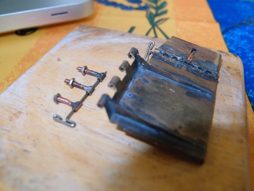

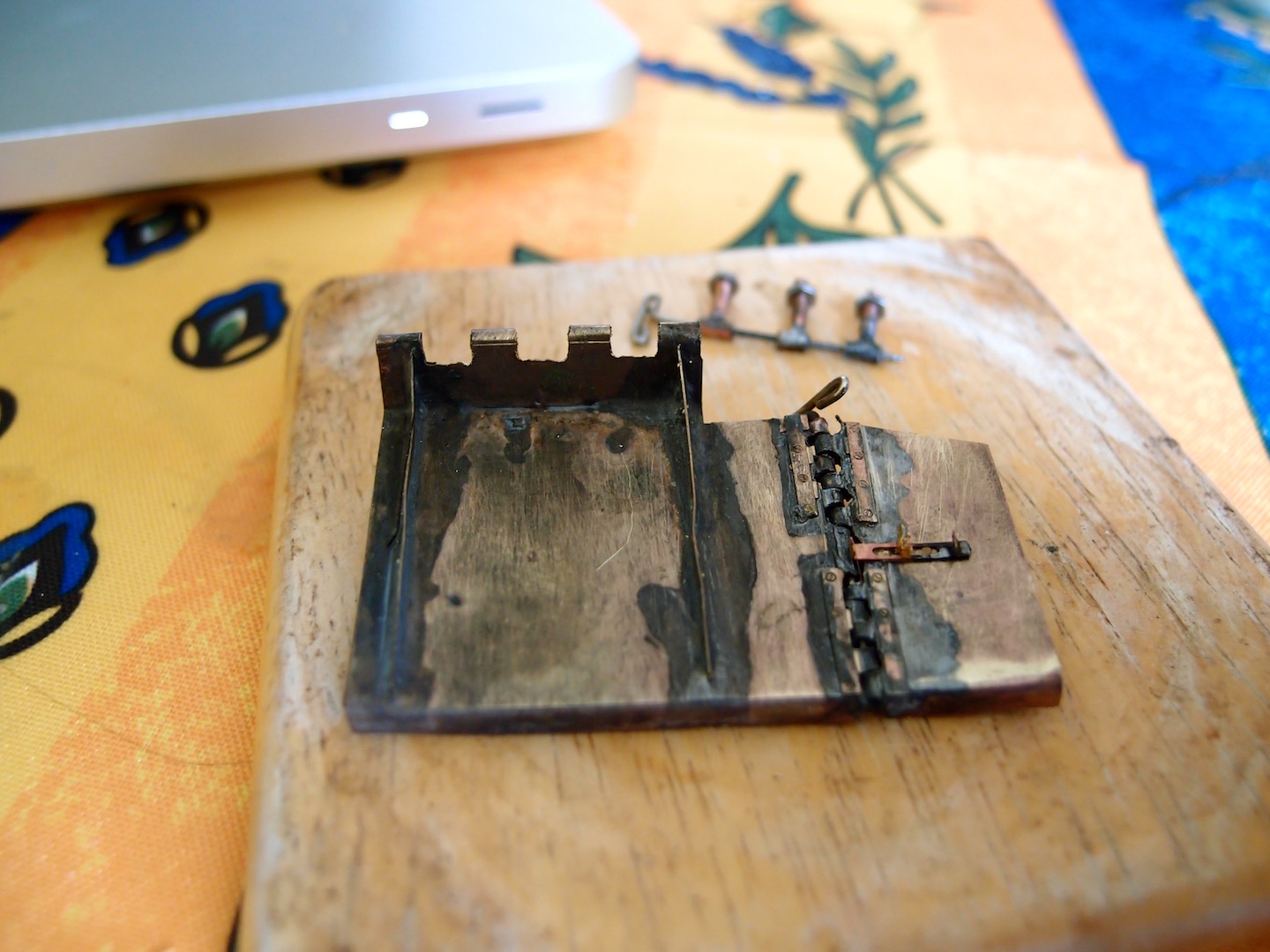

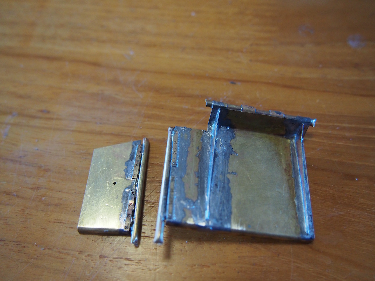

Decided to beef up rear mudguard , the hinges are fragile . Tried some brass tube . The other rear will look better , know how to put together now.

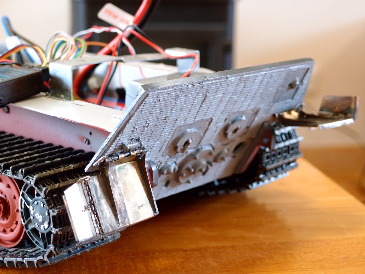

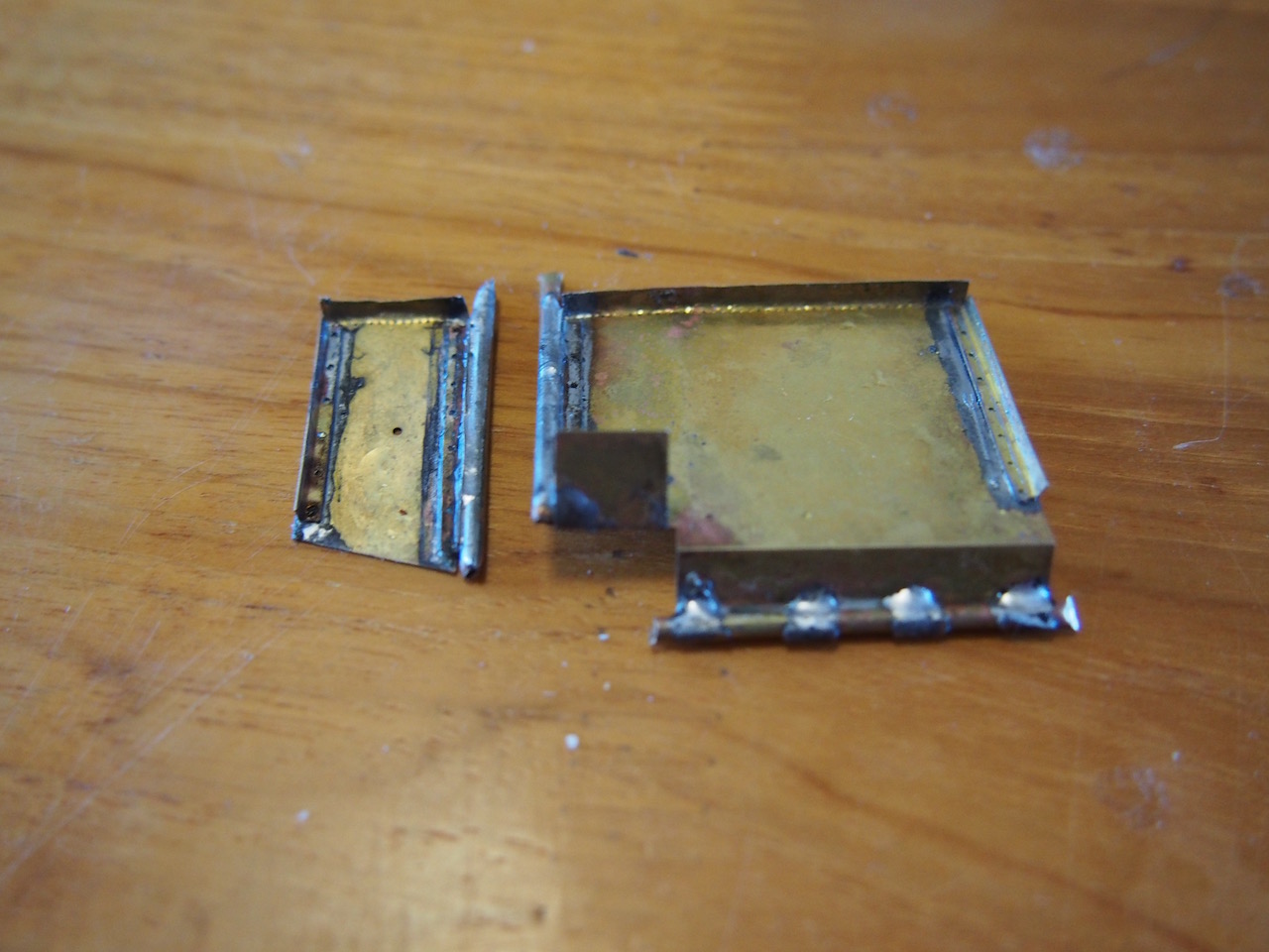

Mudguards version 2 changed the hinge fixings , hinges look rough but recon they took some abuse in real life. Camera shows up the flaws but going to use the 20 foot rule.
Ready for a test , fitted mudguards.

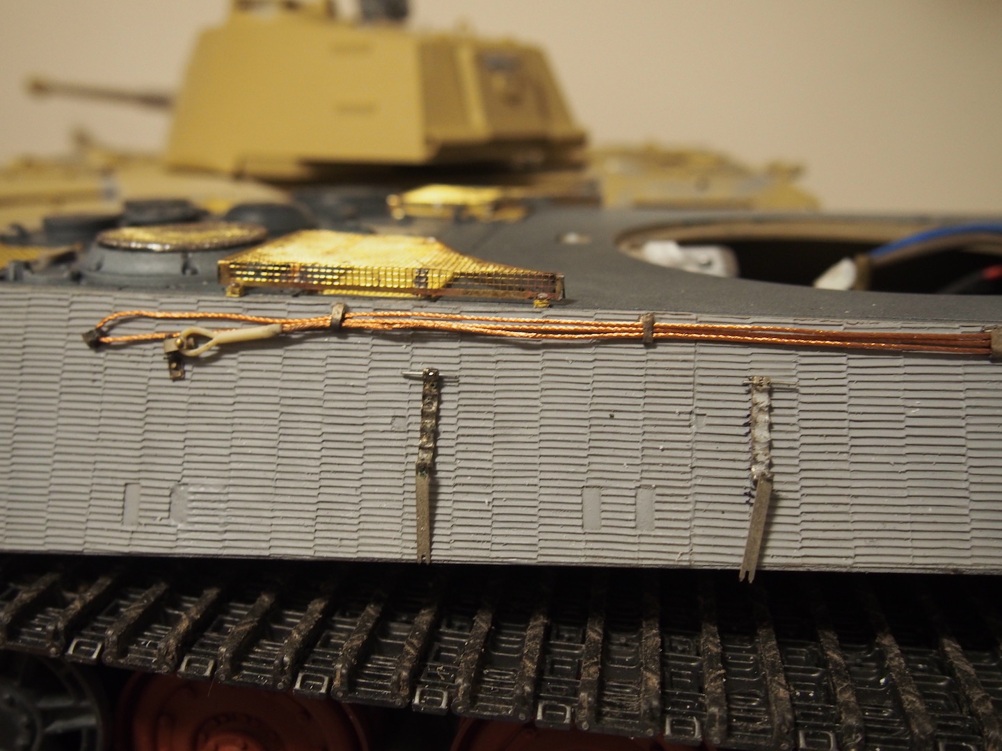

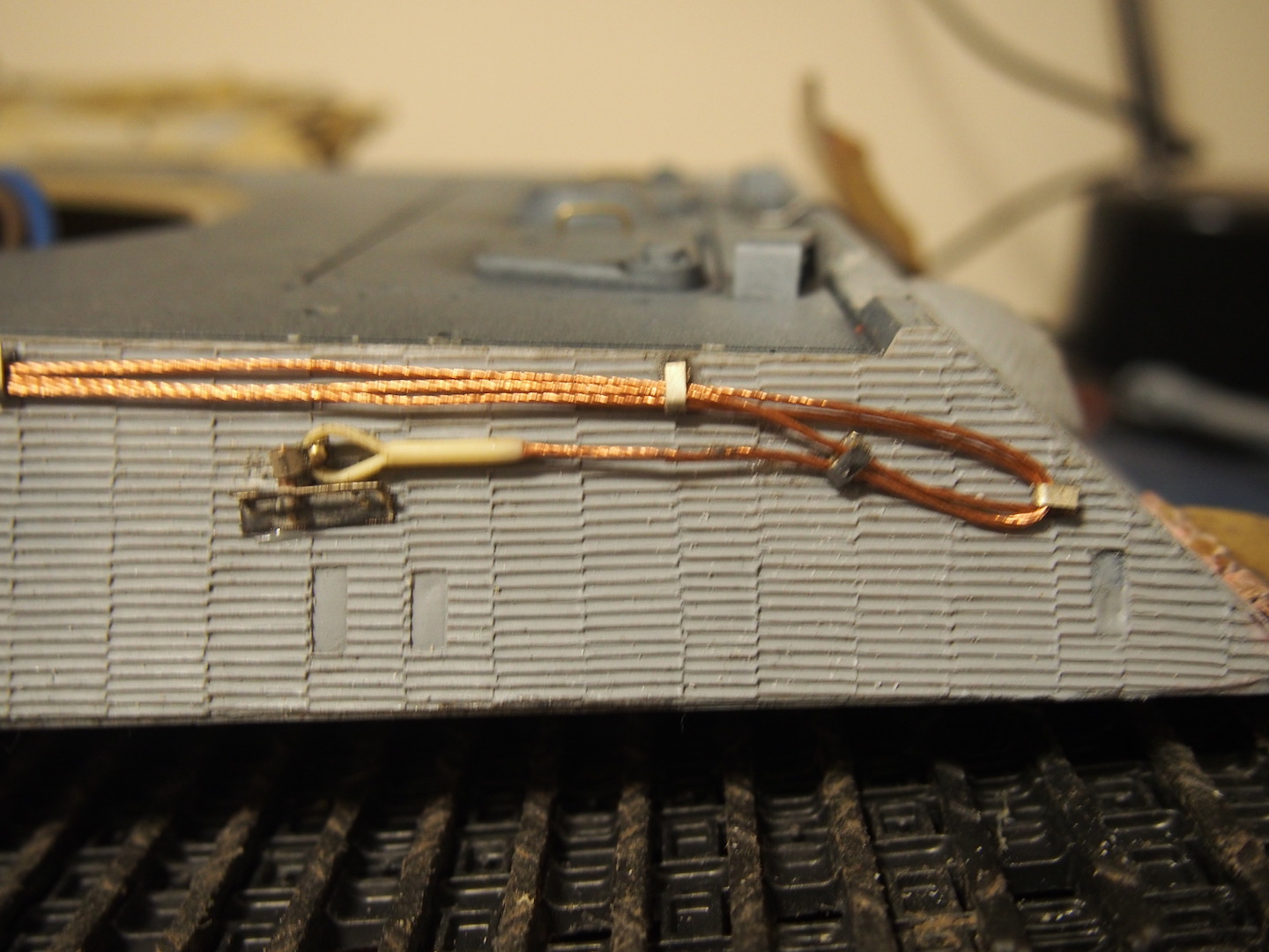

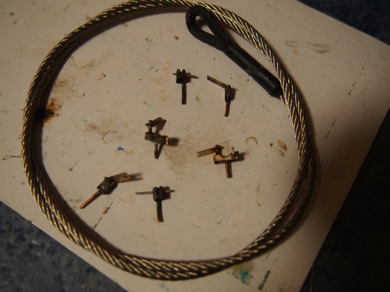

Started PE for cables, decided to solder a stub on each part . Bit of a nightmare at times, so don't want to loose any hangers. Leaving the rods with butterfly nuts to the end , no use trying to solder the wire ends . Paint should hold the pins and with any luck the cables fixings should work.Tried a Heng Long cable end for size , might cut a Tamiya cable for the ends looks much better.
