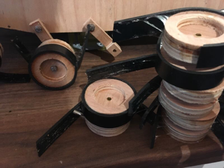

So, I’ve been having some trouble with my road wheels.
After a great tip from Herman, I looked for some rubber tube but couldn’t find the right size so opted for a rubber strip which I cut to length. But after sticking it on, the adhesive failed. I’ve tried a few different ways to fix it including tape & clamps to hold in place for a few days but it always fails (see picture for today’s condition).
So now I’ve resorted to 2-part epoxy and await the 14 hour curing time to see if it’s worked!!

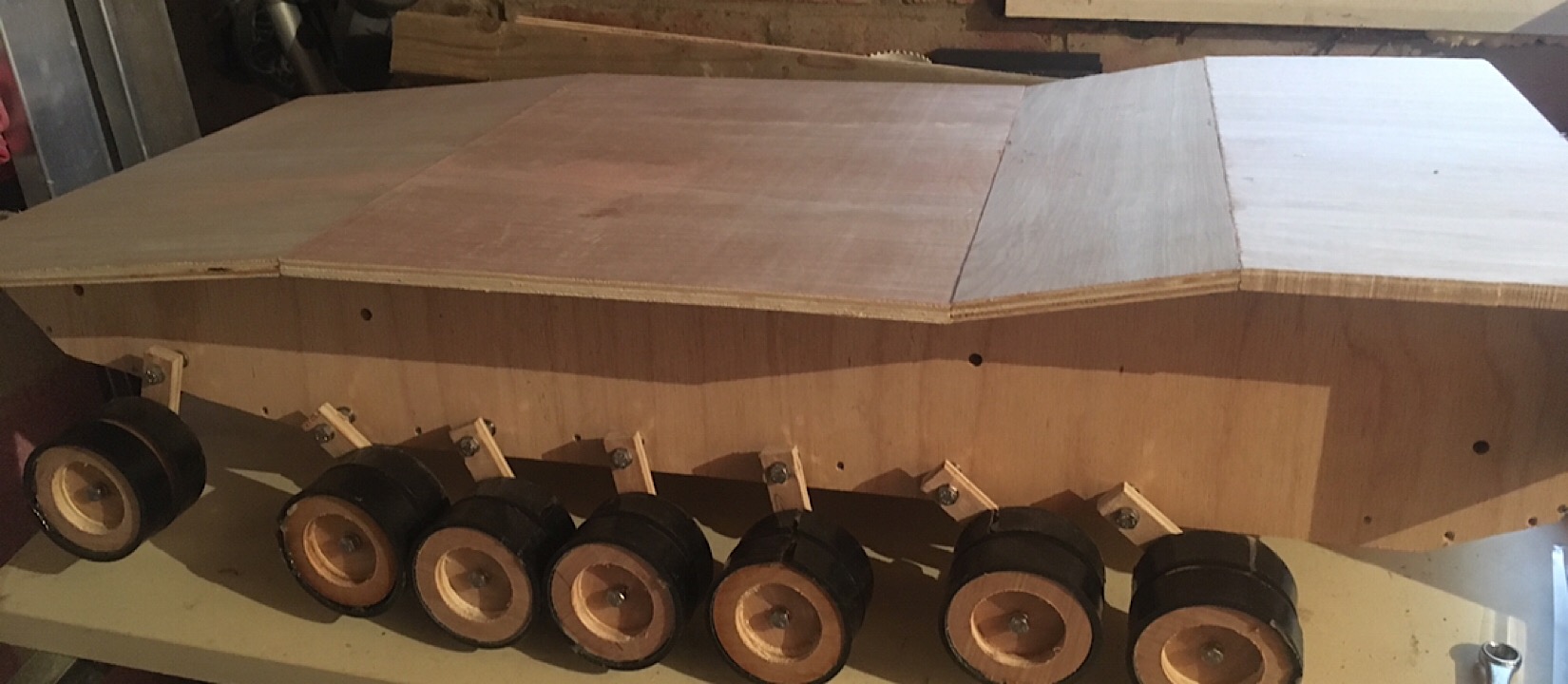

So, progress has stalled for a few months because of work and kids. I’m trying to get some time in the shed to finish it off but it has dawned on me how much work there still is.
I’m not happy with my axles as they’re a little sloppy and don’t particularly sit well.
So I’m looking for a new design - has anyone got experience making new axles? Either bending steel rods or using wood/bolts?
