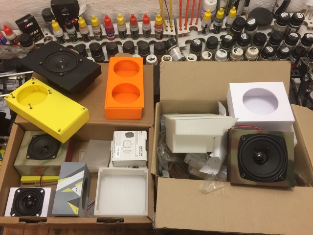

I might have something that fits :thumbup:
27605901_10154951721781582_1731419844_o (Small).jpg (83.06 KiB) Viewed 3160 times

maxmekker wrote:I might have something that fits :thumbup:
:D really impressive, Stian :thumbup: It looks as if your range is fuller now, meaning that you have speakers for most (probably all) 1/16 applications :thumbup:

they're multiplying like Gremlins :crazy:
