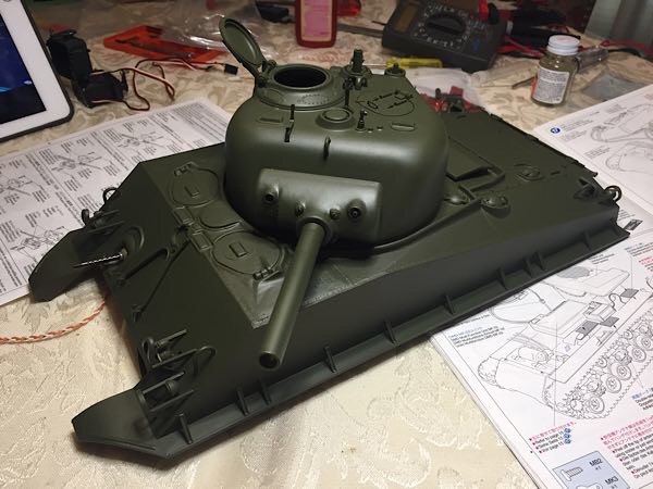

After wrestling with the electronics for several days, I was able to get back to actually assembling this critter. I was able to attach all the items that needed to be OD green to the turret and upper hull and then spray paint them.
I flipped the hull and assembled the glass fiber lighting system. As I’ve never worked with this material before, I was leery of jumping it......but cutting with with an X-acto knife was easy, cheesy.

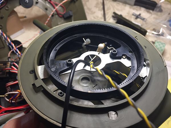

Next I inserted the gear into the turret and attached the turret base. As it was all assembled, I tested the gun elevation system. The motor proved to be too strong and it split the mantlet from the turret. Geez....now what? I’ve got to re-glue the mantlet to the gun mount. So I had remove the turret hardware (motor, motor mount, turret ring) to create enough room to have access to the glue the affected pieces. I was forced to ask my wife to lend a hand and support the turret while I played surgeon......but we got it done and it works fine.

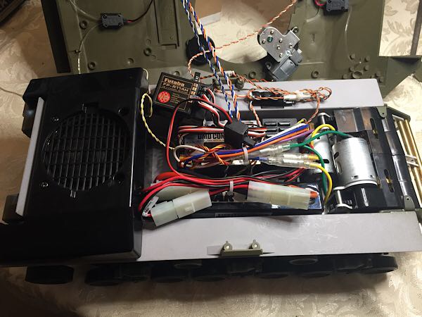

I figured out how to stuff the guts into the hull.......(insert joke about a Chinese puzzle here).....throw in a few zip ties to keep the wiring arranged and it’s a tightly packed compartment.
Next there’s some disassembly to paint a few things. Once all that’s done, it’s on to final assembly (add painted upper hull items, decals, build and paint the figure, etc.).
Dayle

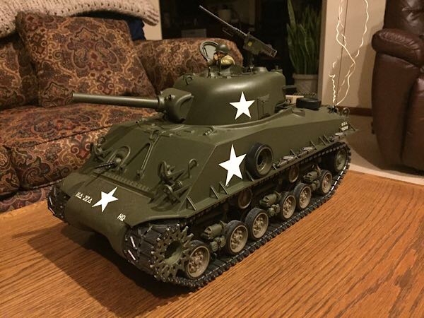

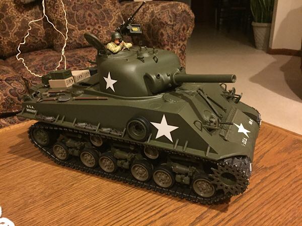

After six weeks of flogging, this project is finally over. I need to come up with a cool name for her but the build is complete. It was a lot of fun. When I showed it to my wife, she asked "so, which one is next?"........we’ll see.
I didn’t want to fool around with weathering.....I’m not good enough at that.....maybe next time.
I need to figure out what’s what withthe machine gun. She makes the noise but doesn’t light up. But that’s for another thread. All the other electronics work just fine.
Many thanks to folks for the help along the way.
Dayle
