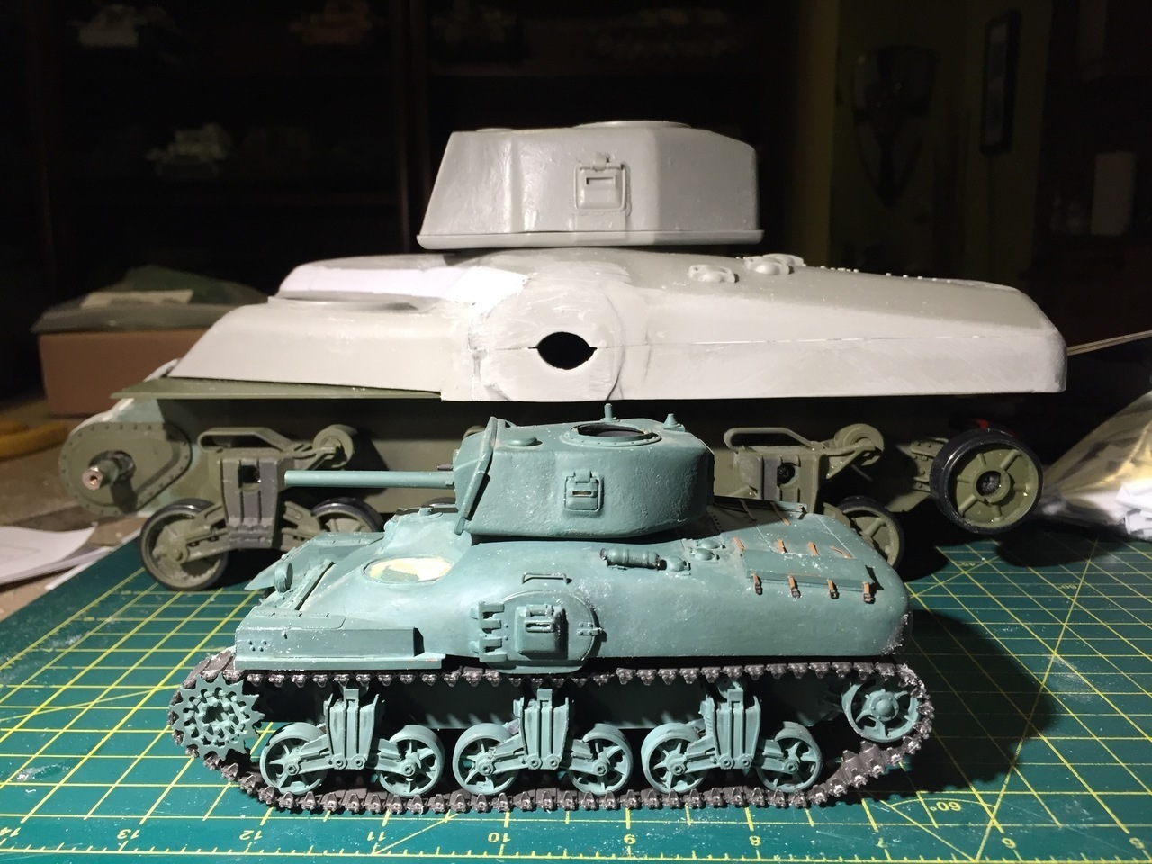

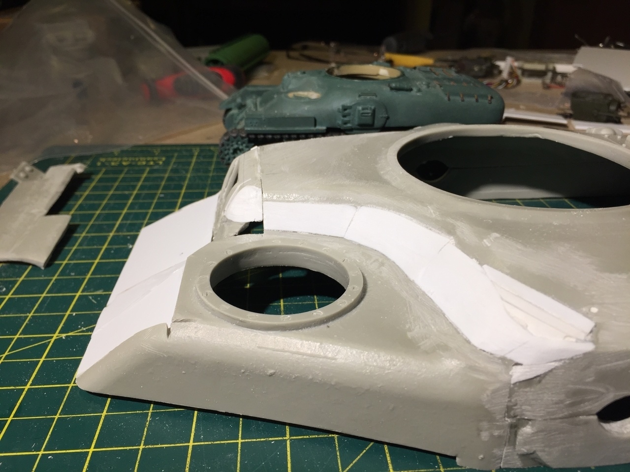

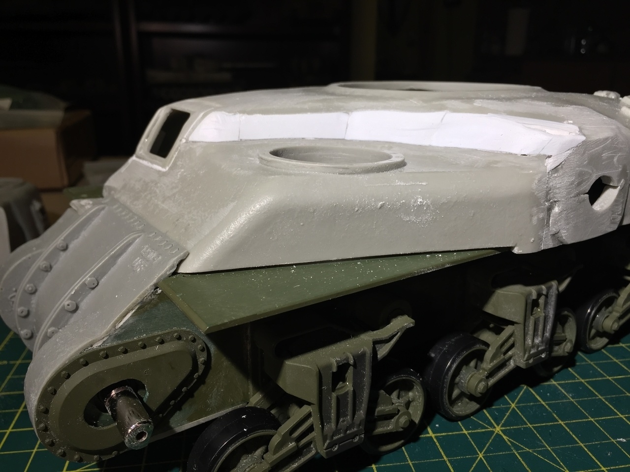

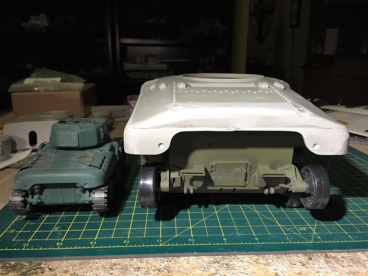

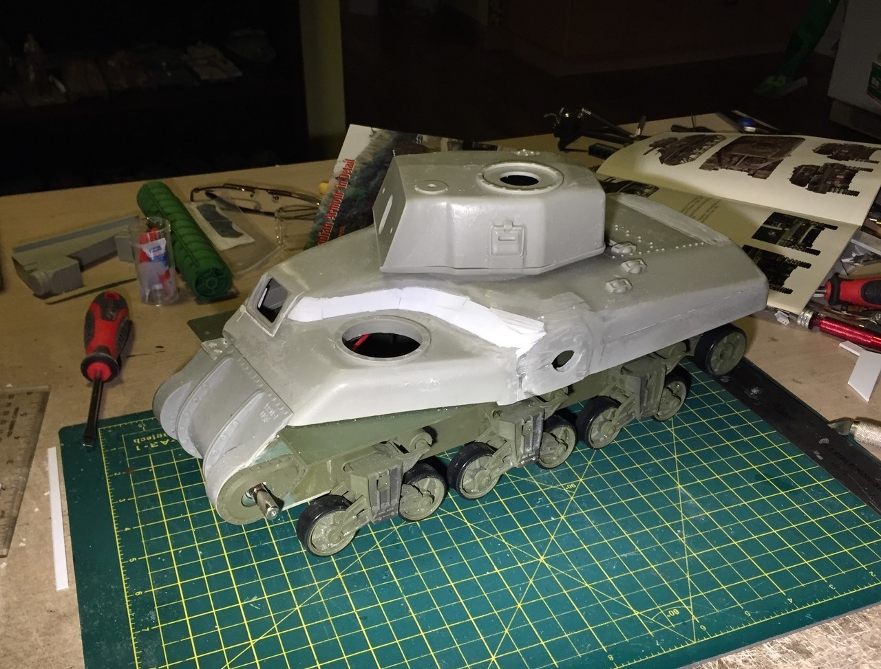

In this post, the Ram upper hull height has been trimmed the best I could with the time I was willing to put on it, and glued it back together. Overall, I managed the get it down by 8mm and make the turret ring horizontal.
In this picture, the turret top part was reduced by 7mm in height from the bottom and just placed on top of its base for the picture. You will also notice that I started the work to move the right hatch forward, by some 7mm to try to make it as per reference. The whole thing needed to be redone anyway. The left hatch is to remain where it is.

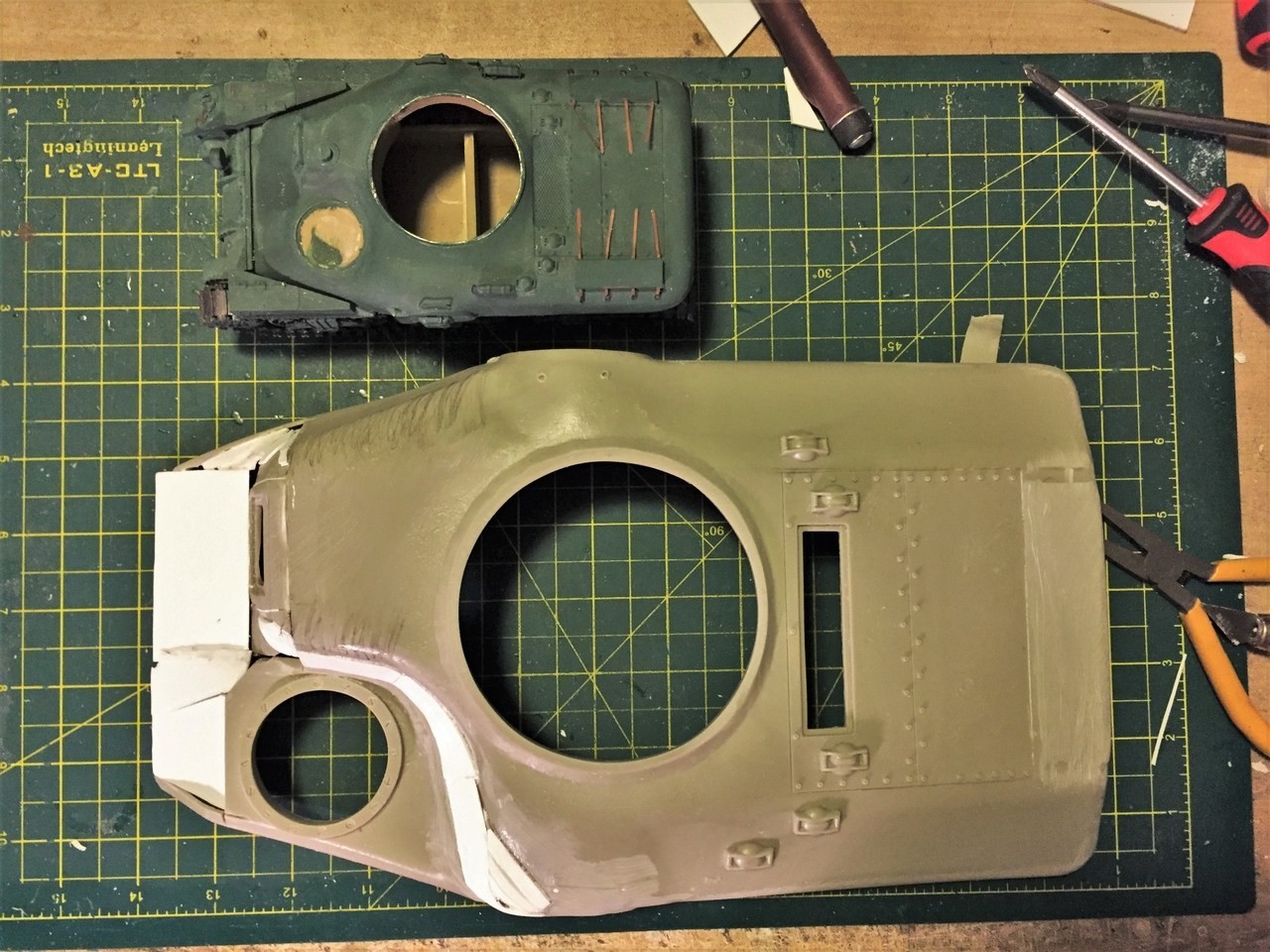

Plasticard was put to fill the larger gaps and it was reshaped. There is no putty on it yet,
Vandra 1/16 Ram tank conversion
Big putty job coming.

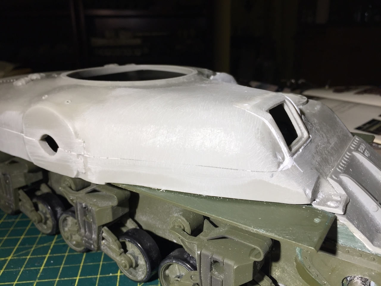

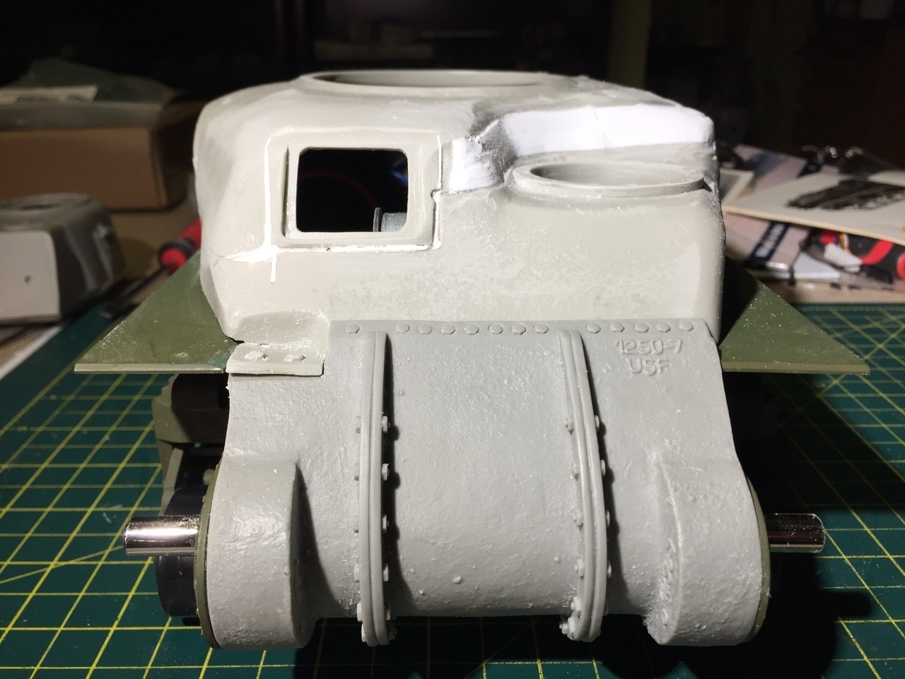

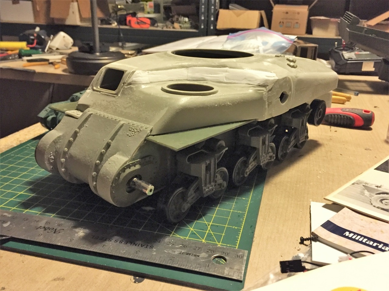

The whale body look is something I worked hard trying to get rid of, not easy. One major flaw that I did not correct (yet) is the driver position extending too much at the front by probably 1cm, it would have been possible but I did not think it was worth the effort. It would have demanded a rework of many armor angles. But now that I look at it on pictures, maybe after the new year holiday and with a cooler head, I will find the courage to redo it. We'll see.

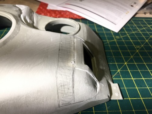

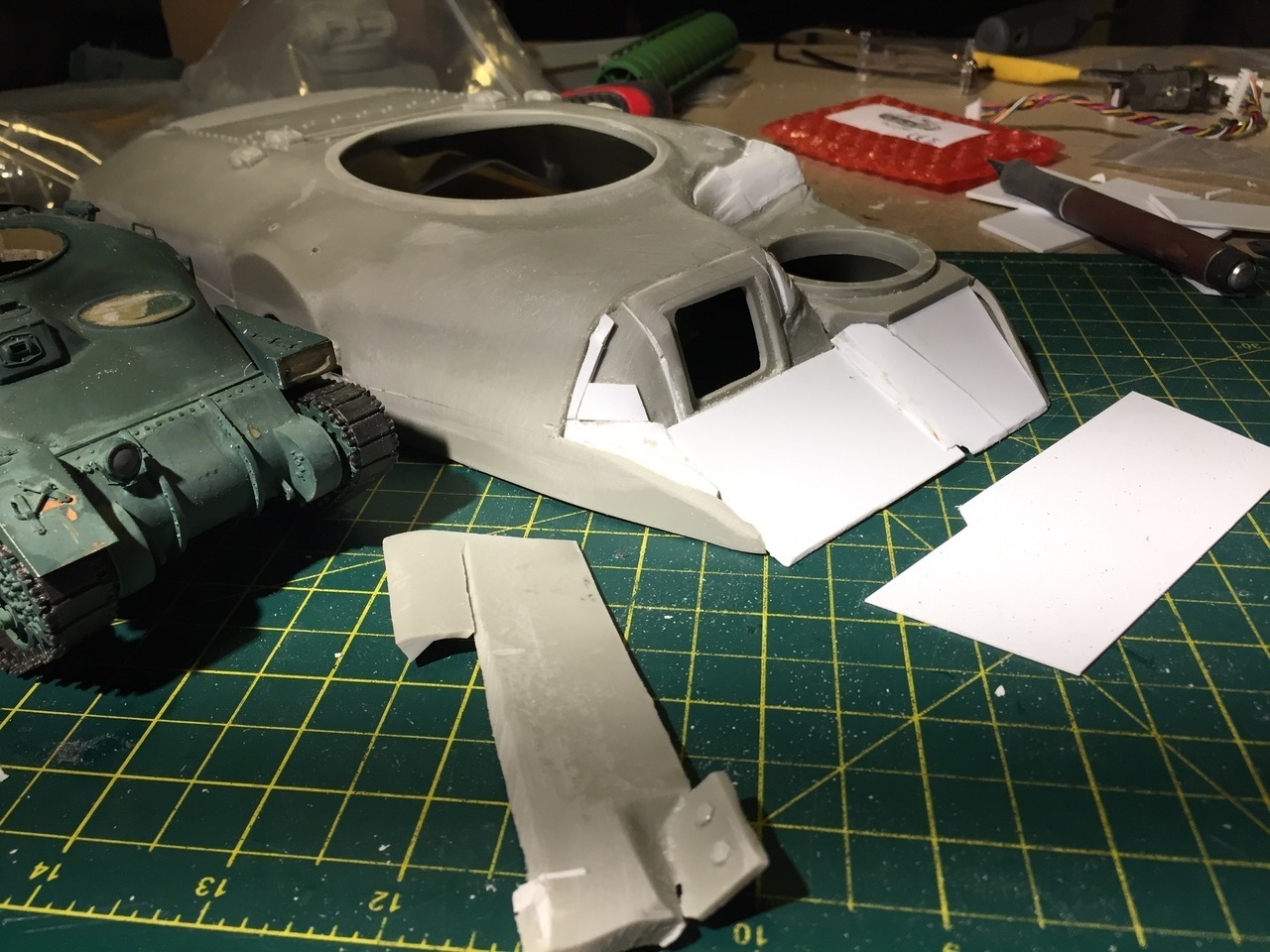

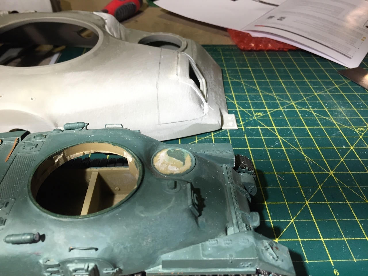

I had a few hours this am before going to a family reunion so I looked at the Ram again. The extended driver compartment was really annoying me. I did not go this far to start cutting corners, I am going all the way and decided to crack open the upper hull again, might not be the last either.
In this picture, you can see that the driver compartment is extending way too much to the front in relation to the machine gun turret ring (compare to Verlinden kit), and the inclination of the lower plate is too steep. All I see is a Beluga whale head on my tank.
Vandra Ram Tank
Vandra Ram Tank

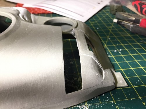

I have decided to move back the hatch by 15mm in order to align with the blue print and Verlinden kit. The slope of the front armored plate will be corrected at the same time.

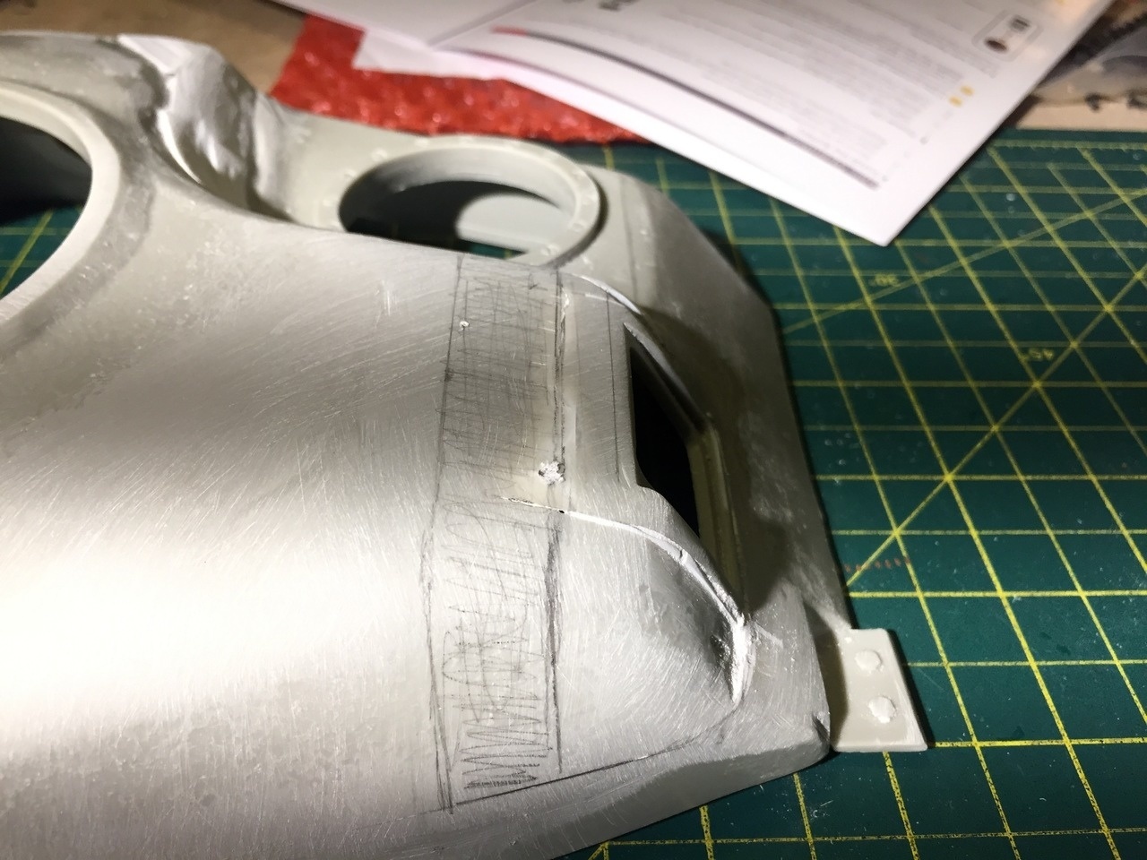

Glued the hatch more or less where it should be according to what I can see, without trying to be scientific. I interpret what I see.
Vandra Ram Tank
Vandra Ram Tank
Started putting together the new front hull made of a base of thick plasticard unto which expoxy and then putty will be used to recreate the joints, curves and the cast finish. The shape is complex, Vandra obviously had a lot of difficulty and seems to have lost itself in interpretations. But they should have used some markers to remain into specific boundaries. One or two mm in variance is not too bad, but 15mm, come on... it does not go unnoticed.

Fix one thing and 2 more issues stands out. In this picture, you can see that the driver compartment is way too large as well. I will see what I can do to reduce it, whatever it takes...
