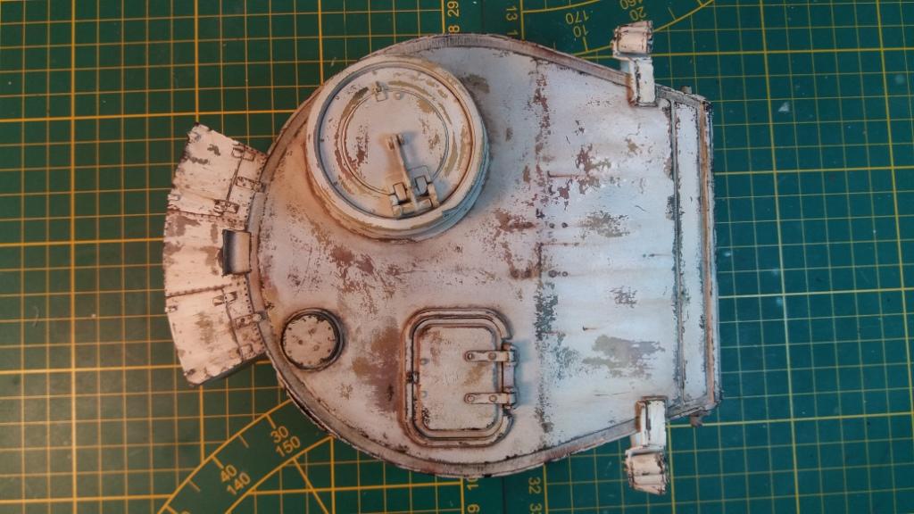

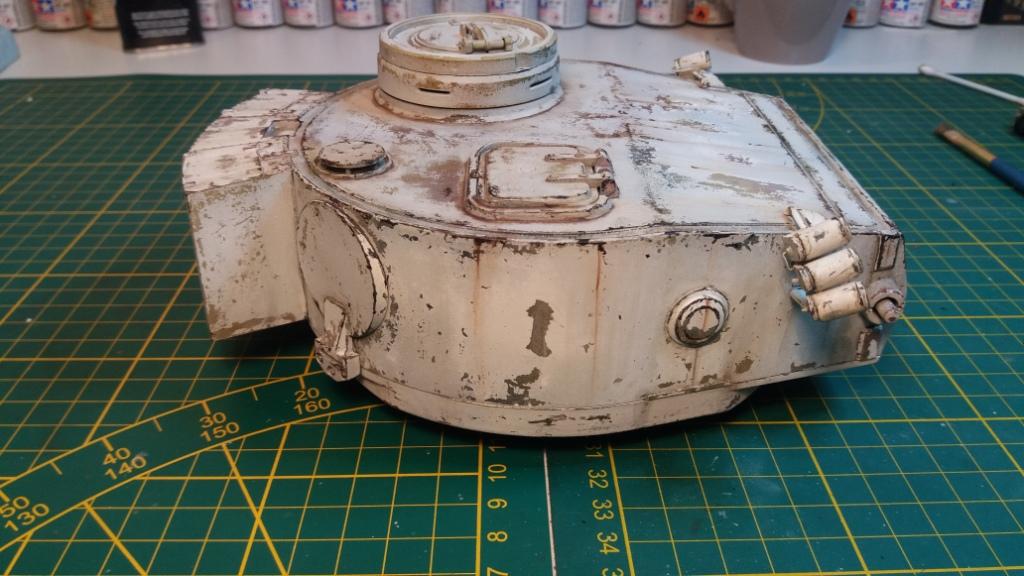

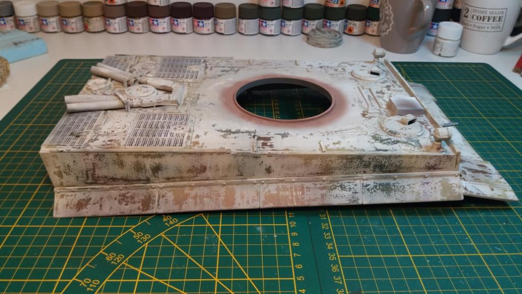

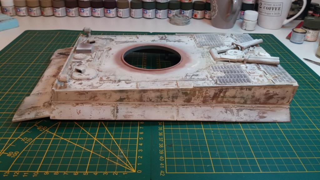

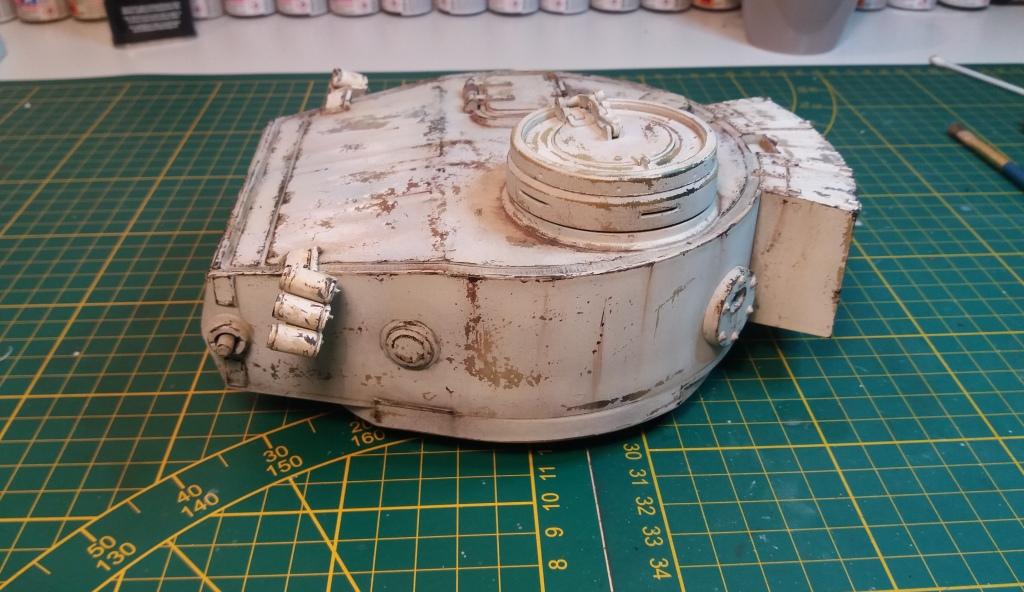

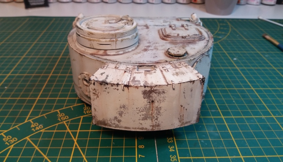

So, weathering on the turret is almost done:

Few tips:
I'm working one area at a time so the hairspray isn't too dry so it's facilitate the chipping.
I'm not using only tap water but a ''wash''. I've got various recipients with water to clean my brushes when I'm using acrylic paint. One for the dark yellow, another for the darker colours like green or black and finally I'm not throwing the tainted water. I let the paint settle the bottom over night. On the next day, I'm removing the excess of water and my wash is ready. I'm using an old Tamiya bottle to store them, when I need it, I've only to shake the bottle before use.

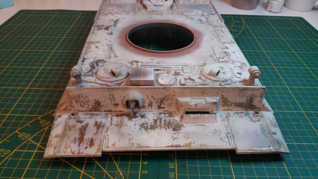

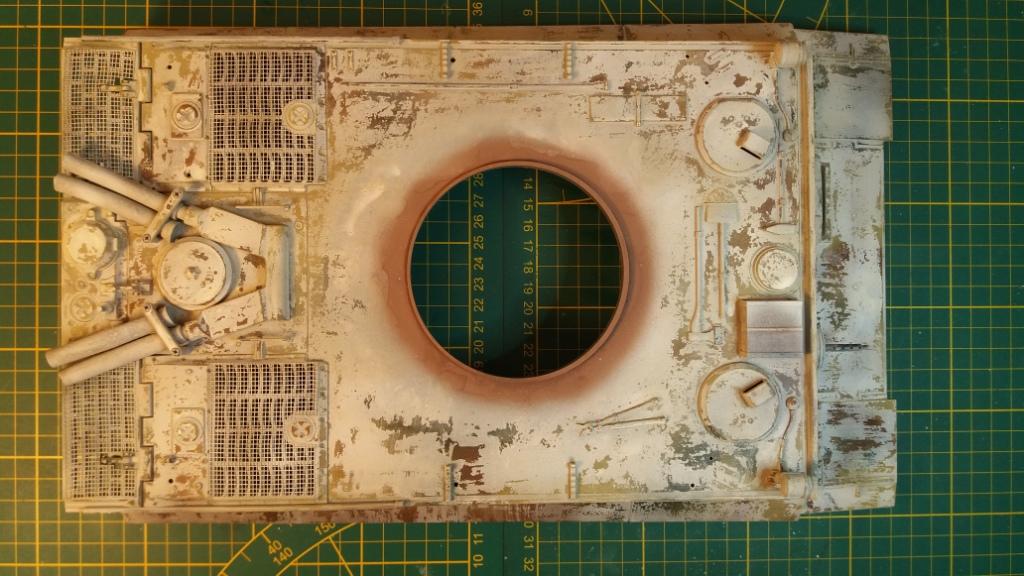

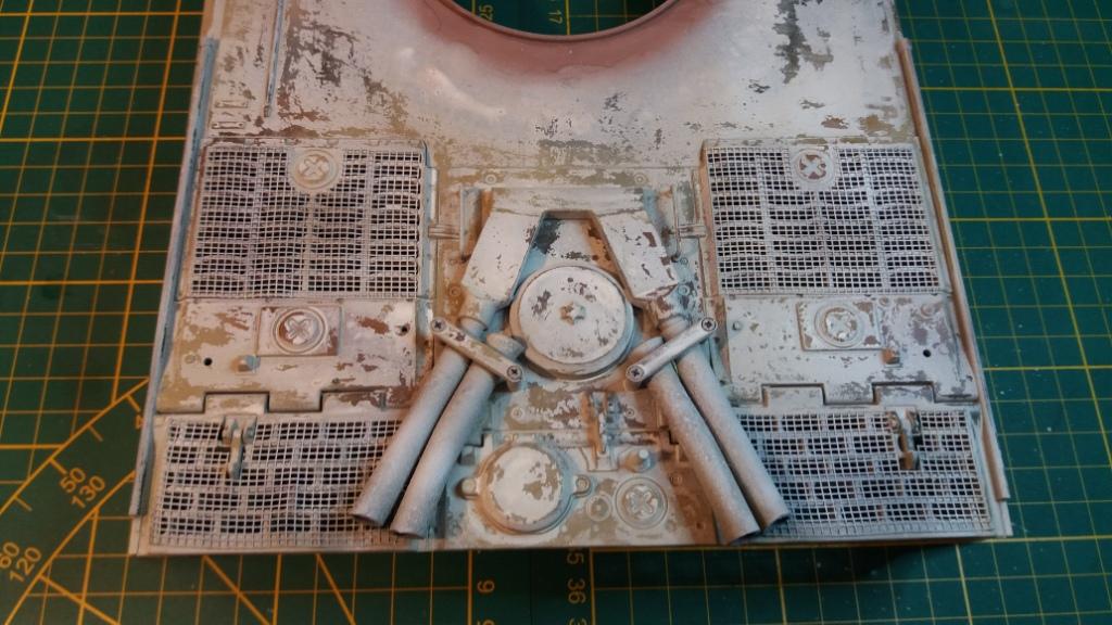

The hupper hull wash is done now and I'm starting the bare metal scratches.

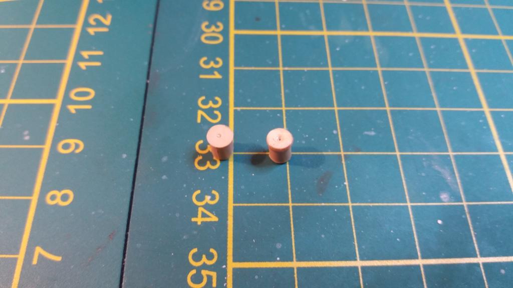

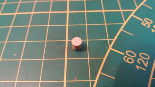

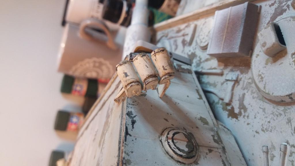

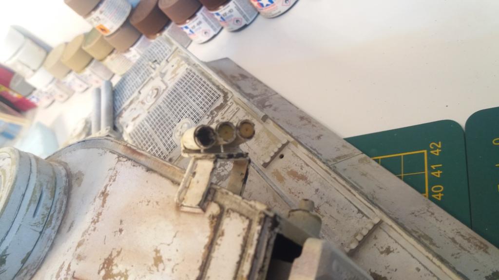

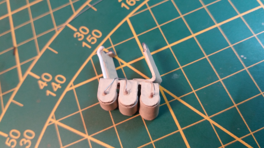

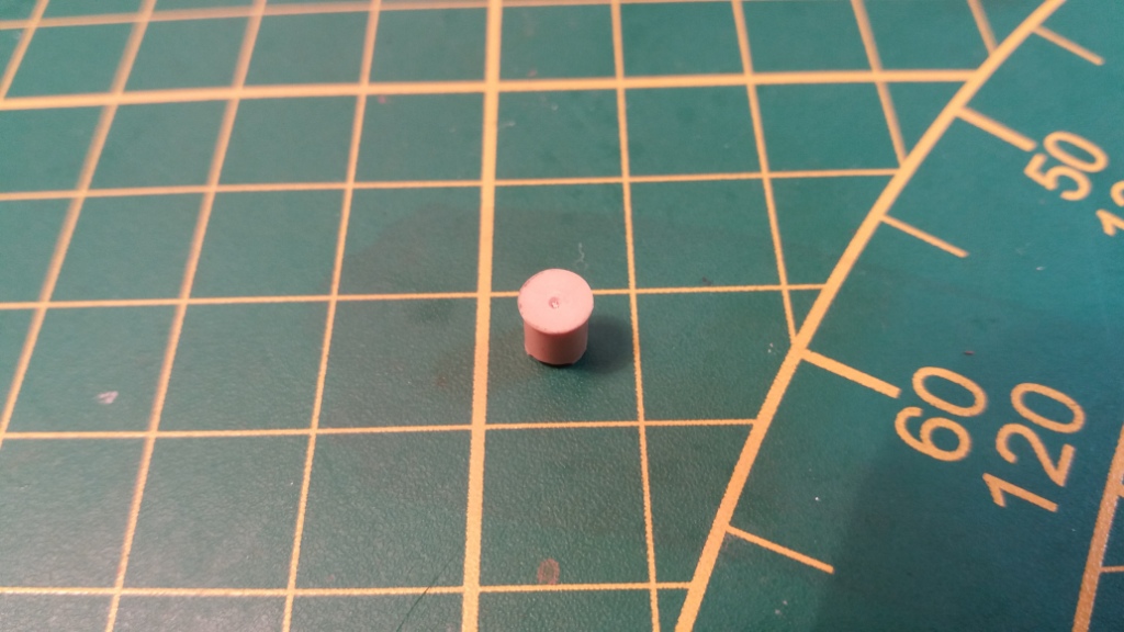

Here are my home made smoke pots for the smoke dischargers:
Using a piece of plastic, heated and then pressed on a flat surface, a small hole drilled in the middle and painted in dark yellow.
And the result:
