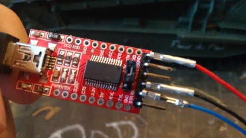

Hi Max, I got that programmer with my board too. It came bad wired and I suspect a bit messed up because the shipping... But what I did is I just unplugged the J connector, took the wires out and connected to other programmer that I had followed the diagram above. But if you just connect the wires in the correct order, it should work.
The 3.3v in the diagram, means to use a programer with a maximum output power of 3.3v, because a 5.5v will fry the dasmikro. Most of the usb programmers has a jumper where you can select how do you want it to work, so please be sure to select 3.3v. Also remember the VCC is not needed, you only need to plug three wires, thats all. TX, RX and GND. Forget about the rest.
You also mentioned something important, and is yes, you need to have your dasmikro plugged to the receiver, and the receiver plugged to the ESC, and the ESC to the battery. In other words, you need the board to be powered on when connecting to the computer.
Also there is no need to solder the connector to the board, but I really recommend it. The conexion is pretty poor, and if you disconnect the board when programming, disaster can happen... So what I did is to solder female 1.27mm pin headers. Any how to solder normal pin headers video must be what you need, but in a smaller size. There are plenty in youtube so you can choose the one suits you most.
