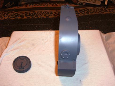

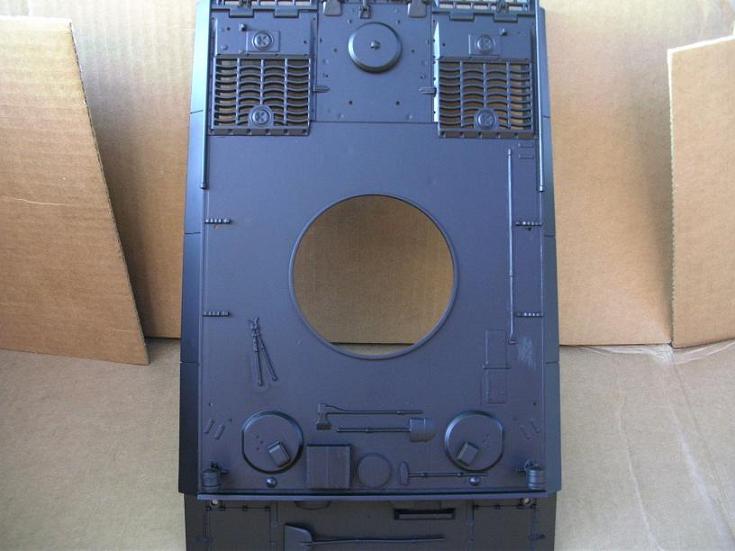

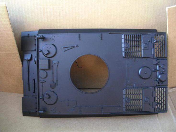

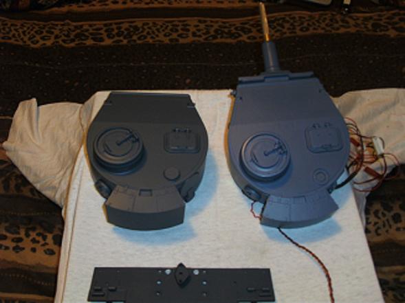

Oz, I did not take a picture of the prep work or prime,here is my turret with the dark gray base coat,next to stock gray.You were right about the black primer,and the gray dried with no runs.My first tank with airbrush.More to come SAX  Added a few more pictures,copula came out very well.Light coats as you suggested over the black primmer produced no pooling or runs,nor did it prevent detail showing like the bolt heads.

SAXONDOG wrote: Oz, I did not take a picture of the prep work or prime,here is my turret with the dark gray base coat,next to stock gray.You were right about the black primer,and the gray dried with no runs.My first tank with airbrush.More to come SAX
excellent mate, post lots of pics, i,m gonna put up some pics of the engine deck with the first washes on in about an hour or so.................oz
