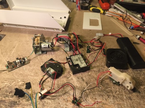

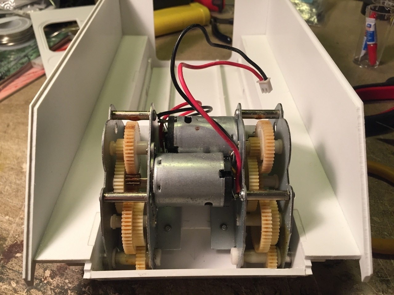

Someone can spend hundreds of dollars on specialized gears and equipment for this vehicle. But my plan is always to use the cheapest alternatives. Here is the selected electronics being tested. Most of it are cheap or antique Heng Long stuff from the spare box... but they work well. It cost almost nothing.

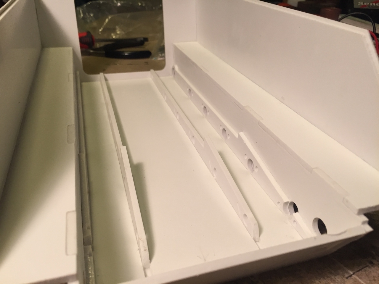

The main plastic parts to which the Taigen torsion plate suspension will be attached are installed.

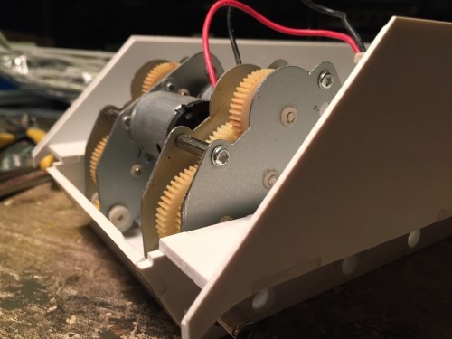

As you can see, the drive shaft is quite low on this vehicle. There is no room available for the bottom of the gearbox over the suspension, this is limiting options.

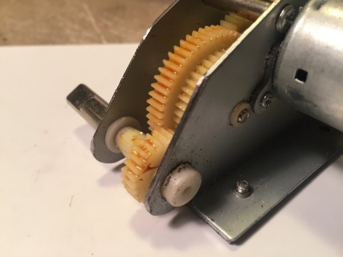

The gearbox metal had to be trimmed at the front so that the drive shafts can fit into their sockets.

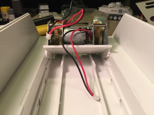

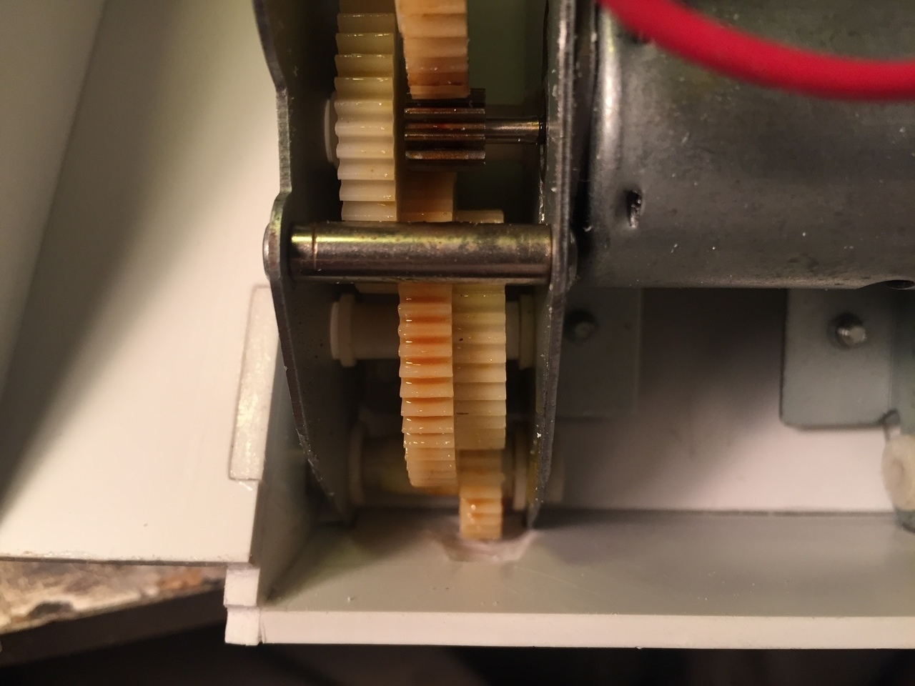

This is how the gearbox will be installed.

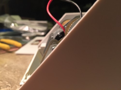

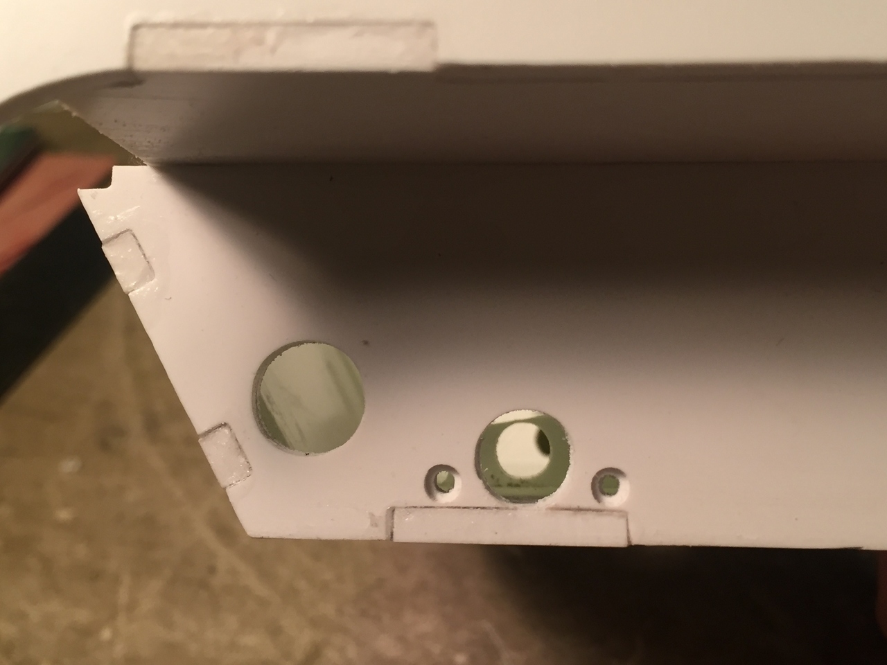

This is a rear view of the mounting plate for the gearbox, at quite an unusual angle. It is made of leftover plasticard from the kit sheets. The plate will be reinforced later.
Need to ensure there is enough room for the front armored plate

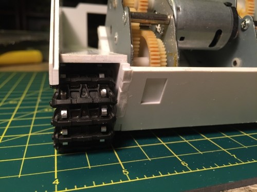

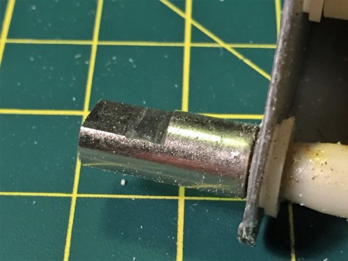

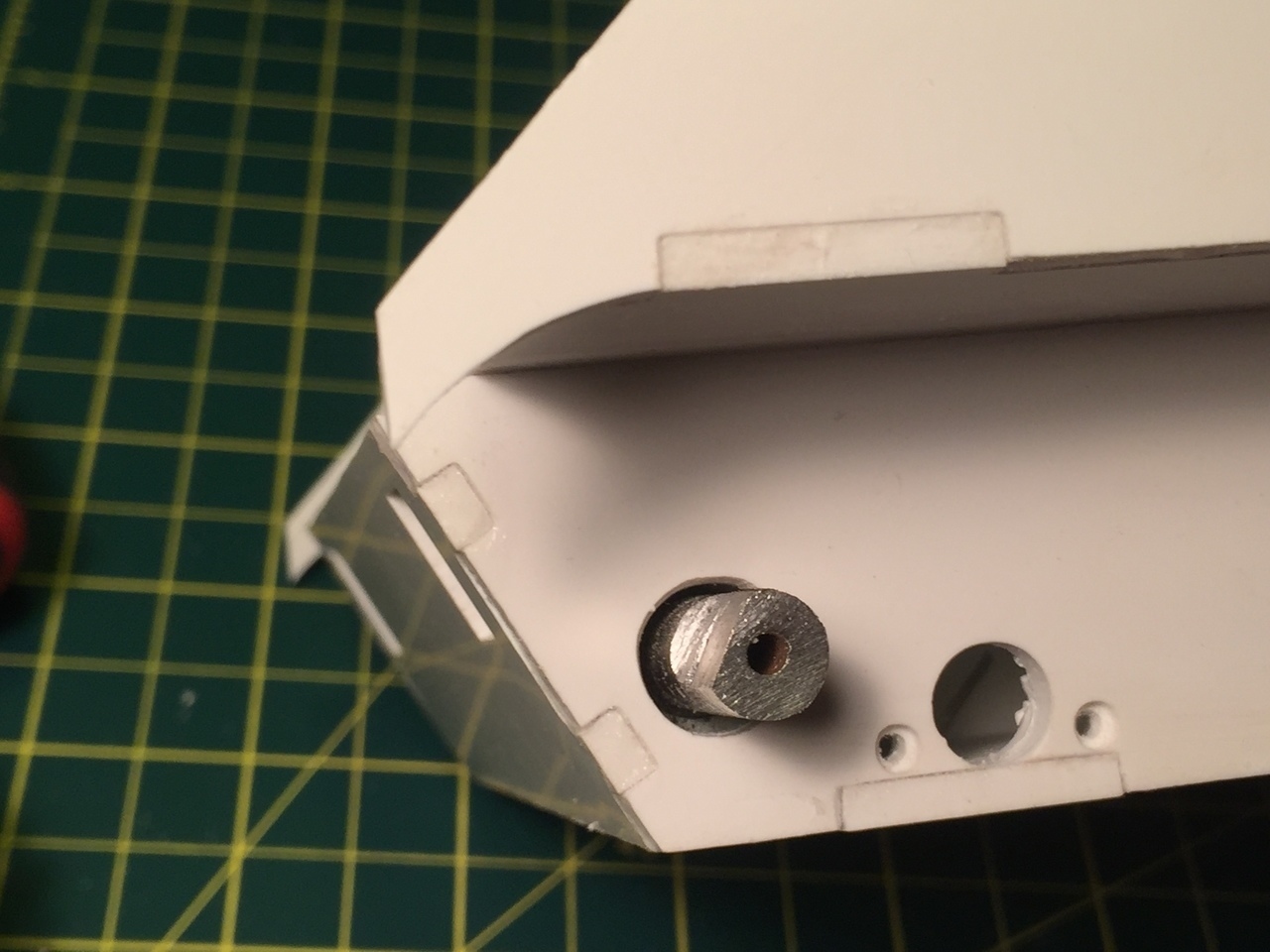

The drive shafts are too long, the sprocket is way too much on the outside. The shaft will need to be trimmed by at least 5mm. A couple of mm can likely come from the sprocket itself. I will check that next.

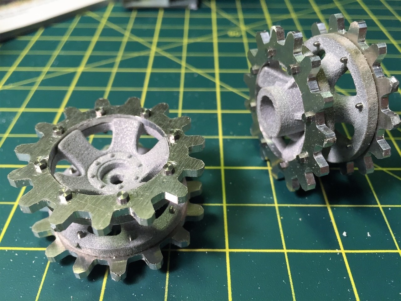

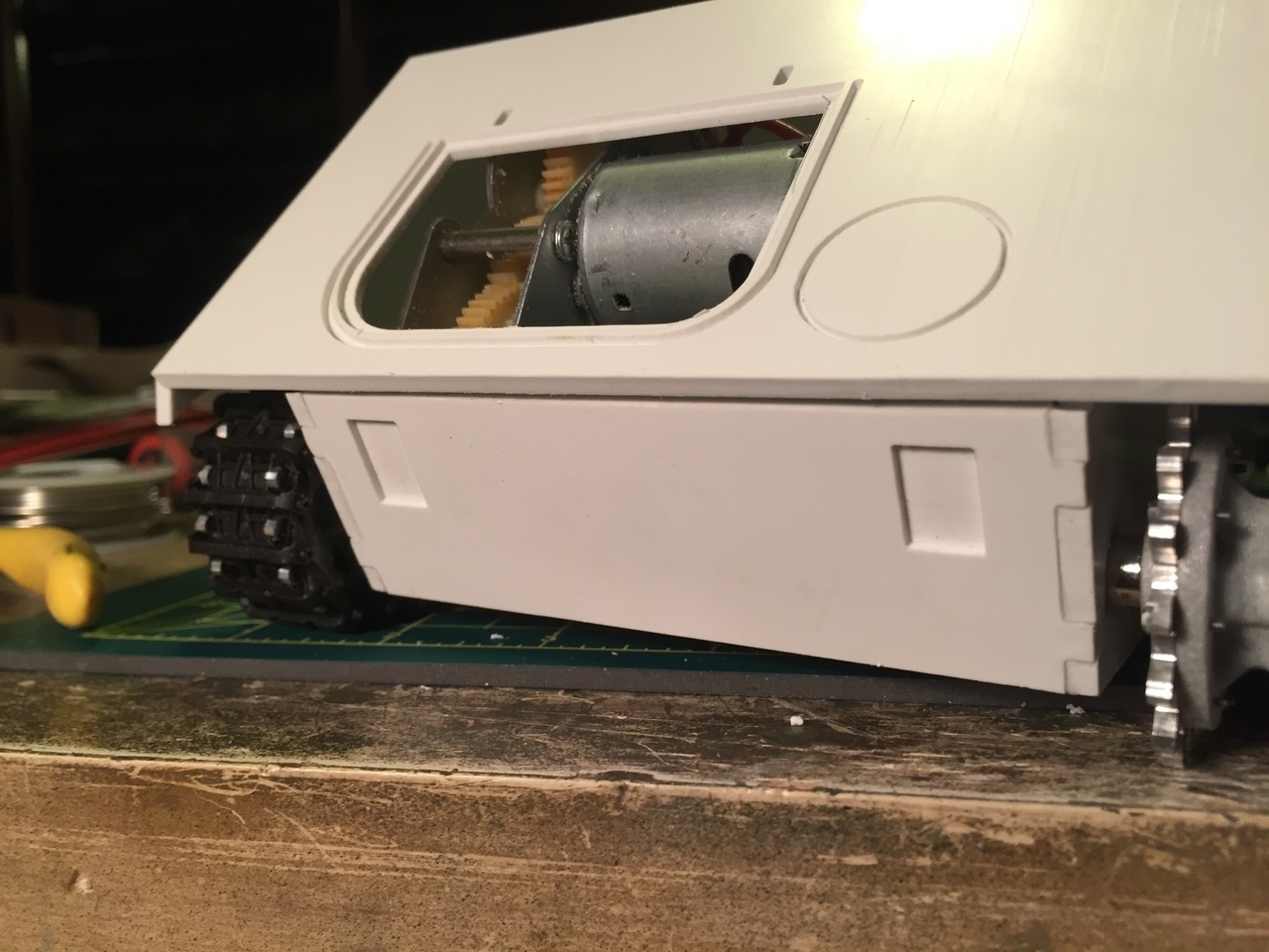

The Ludwigs sprockets come with a bag of Knupfer hex bolts for a realistic mounting of the metal plates. However, I just noticed that all the dents will require filing and polishing work. As they are, the dents are too large and sharp, they cut into the plastic tracks and do not work well. So, a lot of finetuning will be required on these before they are operational.

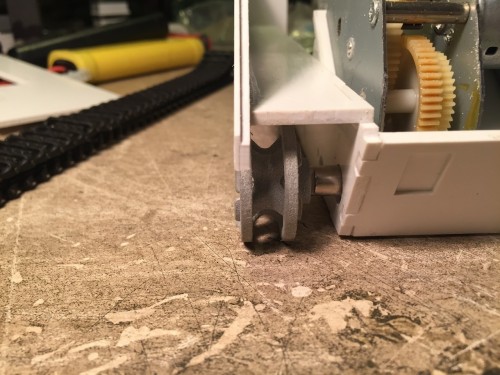

The Heng Long gearbox drive shafts had to be reduced by 4mm using a file, a 20 minute job on each.

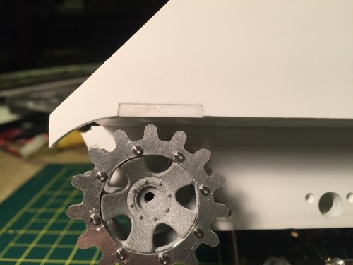

The drive shafts are properly centered. I just hope the whole thing will align with the suspension arms, and the road wheels, coming soon.
The sprockets are a bit too big in my views, a common sight with RC tanks. However, filing the dents should provide more room for the tracks. It is ok as it is but I would like to have one more millimeter if I can.
Dry fitting the tracks with the sprocket in order to analyse the overall situation. Looks ok. Need to leave room for the gearbox M113 drive cover than I am planning to make for each sides, similar to the Sherman.

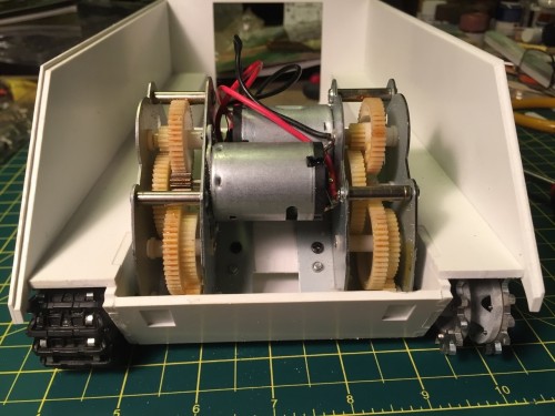

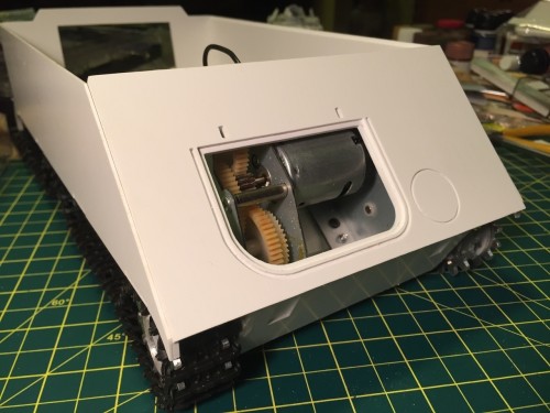

The panzer IV Heng Long gears are finally installed on the model. Cost of M-113 motorization; 12 $

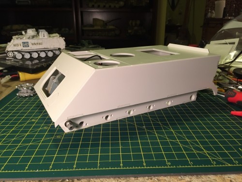

Dry fitting the front panel
The joint between the bottom and front panels will require rework. I will likely have to put an overlay plasticard sheet on the bottom panel for a clean fit with the top.

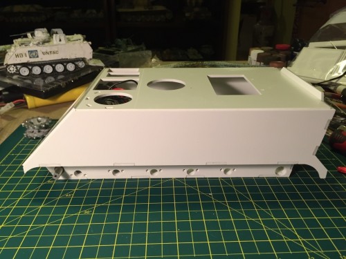

Dry fitting the roof parts of the model. Looking good. These will be installed at the very end of the build, likely with a device to take them off and on for maintenance, something I missed dearly with the M7 Priest Build. The inside is quite roomier as well.
I am pleased with the kit so far. The shape is beautiful.
