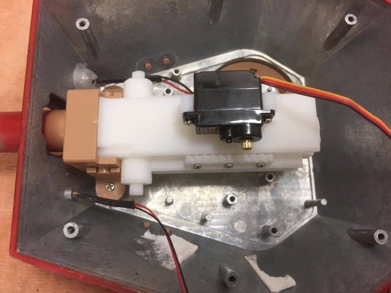

maxmekker
Posts: 1719
Location: Norway
Re: Taigen Panther F - internal layout
Post by maxmekker »
I kept the stock motor. just unsoldered all wires from the taigen recoil unit and rerute it to the right pins on the board ( in photo it was on the right pins on the 9 pin socket just for test)
ss (Small).jpg (93.36 KiB) Viewed 1363 times
