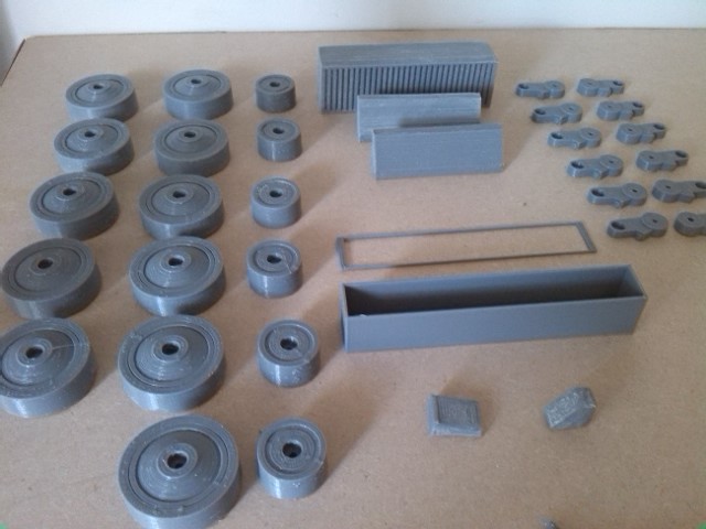

Printed off most of the small parts, though I haven't even started on the gun or the gun deck internals.
I also roughly printed one front corner to test the suspension linkage, and gearbox/sprocket alignment. There isn't enough room for HL boxes, so will have to look at those brass ones that seem to have a lower profile.
Springs are ordered, but before anyone points it out, I know that this type of suspension isn't what was on the original. It is just the easiest way to install springs that have no protrusions on the inside, if I did that then gearboxes would not be able to sit up against the inner hull wall. The spring holders will be pretty much out of sight behind the road wheels, shame they aren't bigger as if they were then they would be hidden completely.

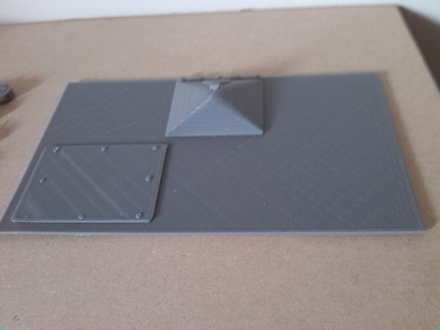

I reckon the Taigen low profile ones will fit, if I can get measurements from somewhere I can check before I buy them.
I printed the front valance and flat top to the upper hull, complete with all of the detail moulded in. Turned out very nicely, and it's quicker to print that way. No need to glue bits on, nothing can become loose and fall off, and everything is lined up perfectly.

I am printing all of the parts designed so far, while I wait for the suspension springs to arrive, as I need to check where the mounts are on the lower hull, to get the correct tension.
Yes, the parts are turning out well, though I am always aware that they could be even better if I applied myself to some minor details on the configuration side of things.
The printer is positively ancient by current standards, but as it does the job, I am not complaining.
