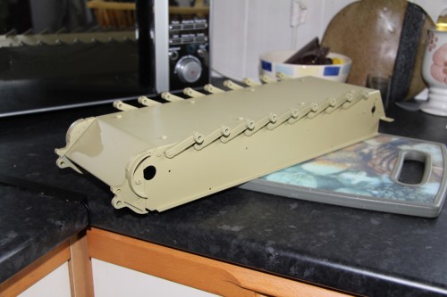

Just an observation at this point. Where the metal hull smacks of durability, precision and strength..the other major plastic components, the Upper Hull and the Turret, are surprisingly thin and flexible compared with those in my Torro Pro (Metal edition) King Tiger. Being new to Tamiya Full-Option kits, I've no way of knowing whether Tamiya are economising with the plastic and ABS bits, but I thought the KT would be far more robust that it appears to be. Only time will tell, I suppose, how to will handle outdoor use (and abuse!)

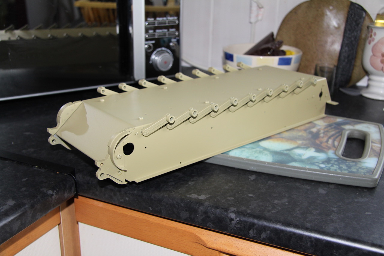

Well, here's the hull newly primed and painted in Dunkelgelb. I used Tamiya rattle cans at this stage instead of getting my airbrush out. Their cans are pricey, and disappointingly small. Still, they work perfectly well after a good shake. Optimal spray distance is around 8 inches.

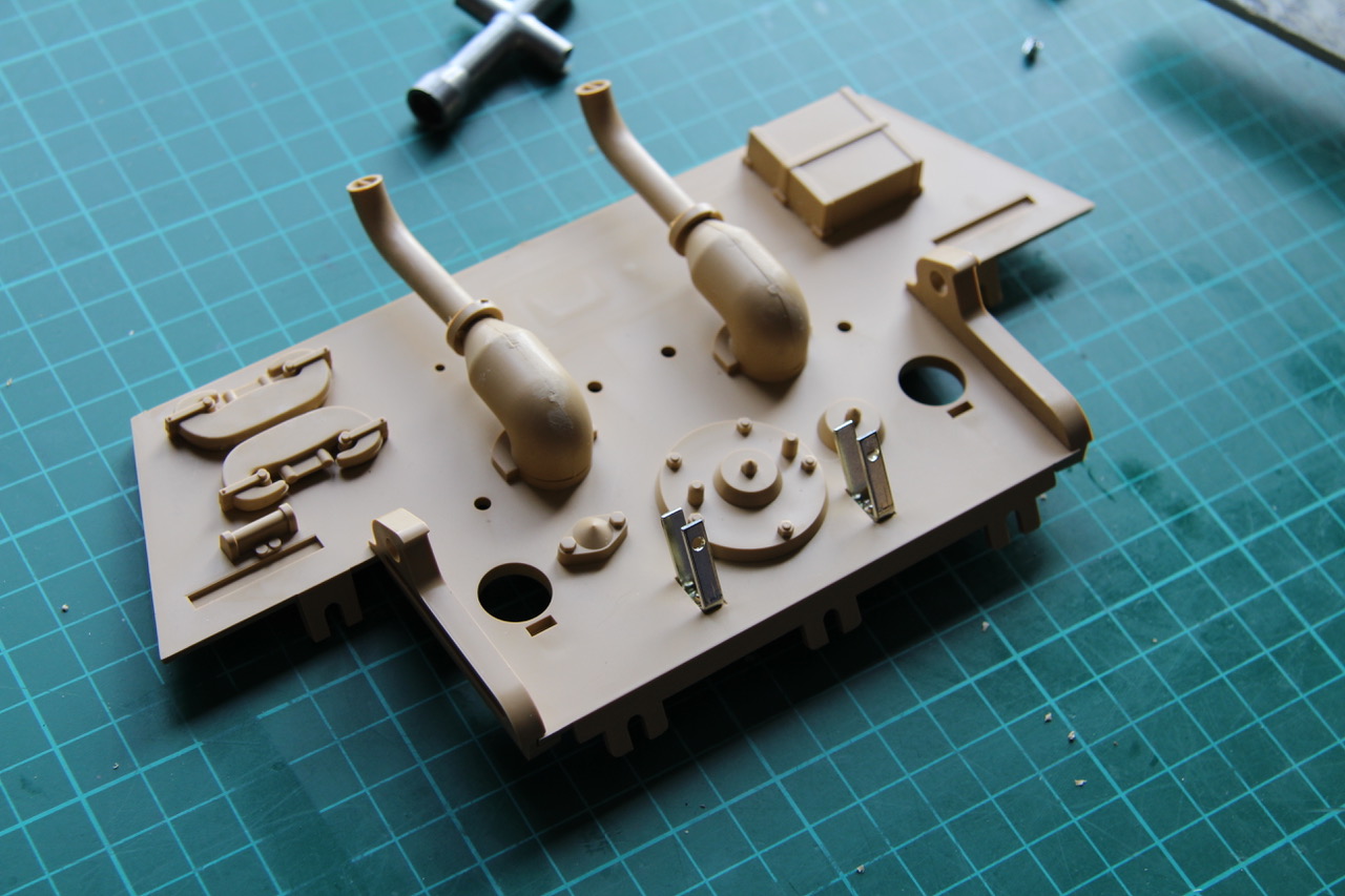

Now it's time to start bonding bits onto the rear panel. I used Tamiya cement here for a change. Normally, I use Revell Contacta Pro. Contacta Pro has a very useful needle type dispensing system, and is great for accurate delivery into tight spots.
but it does appear to be fragile

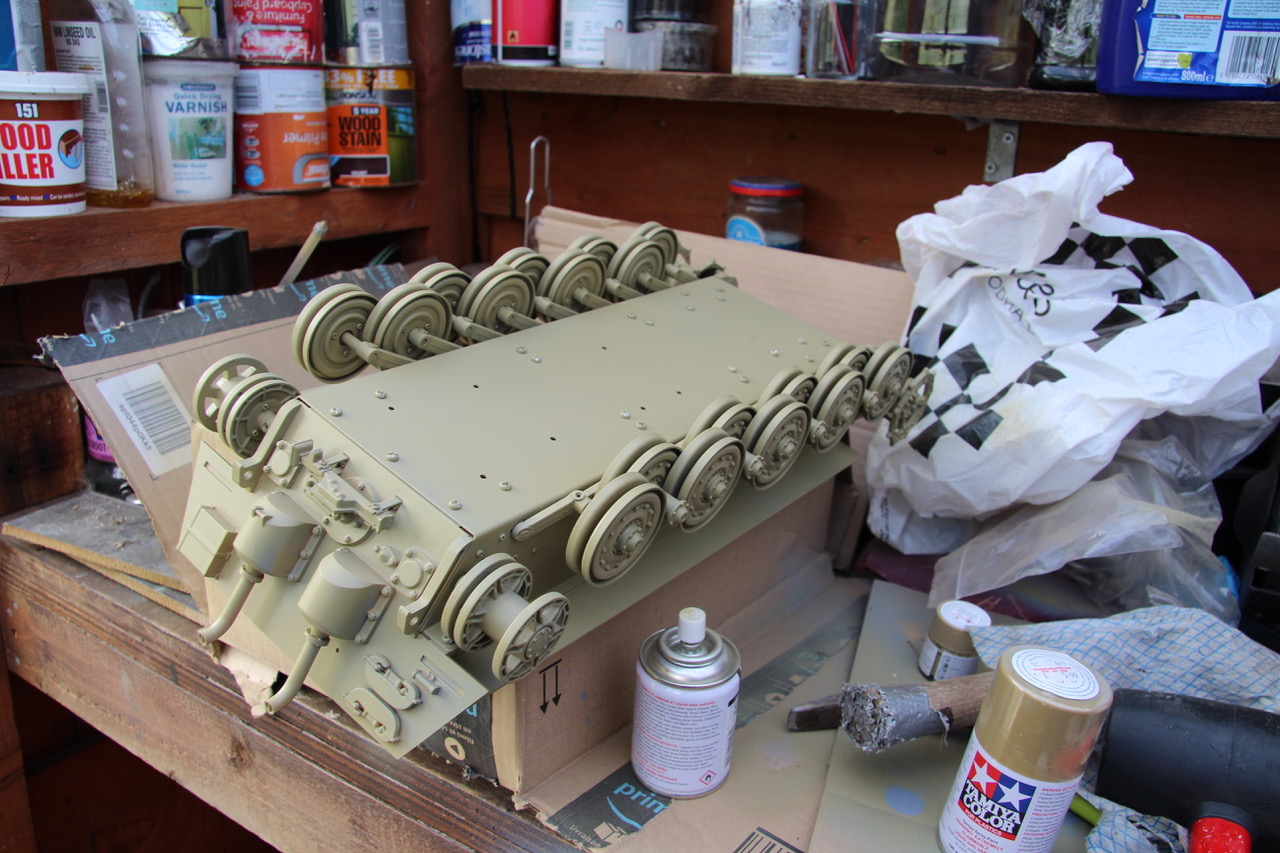

Here I've fitted the parts to the rear panel, and after fitting it to the hull (bit fiddly as it's held in by 5 captive nuts with screws), I began attaching the wheel, sprocket and idler assemblies. One thing to note is that many of the metal parts require a small drop of thread lock. All the set screws for the suspension housings and torsion bar stays need threadlock.

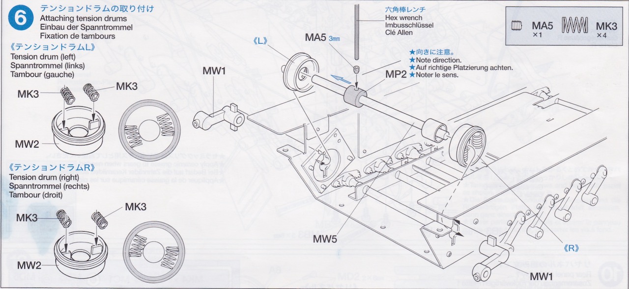

Before fitting the rear panel, though, it was necessary to fit Tamiya's track tensioner. Now that was a bit tricky. The system reminded me of fitting fiddly return springs in car drum brakes. I have to say, it doesn't inspire me with great confidence..
This is one component I shall probably upgrade in the not too distant future.

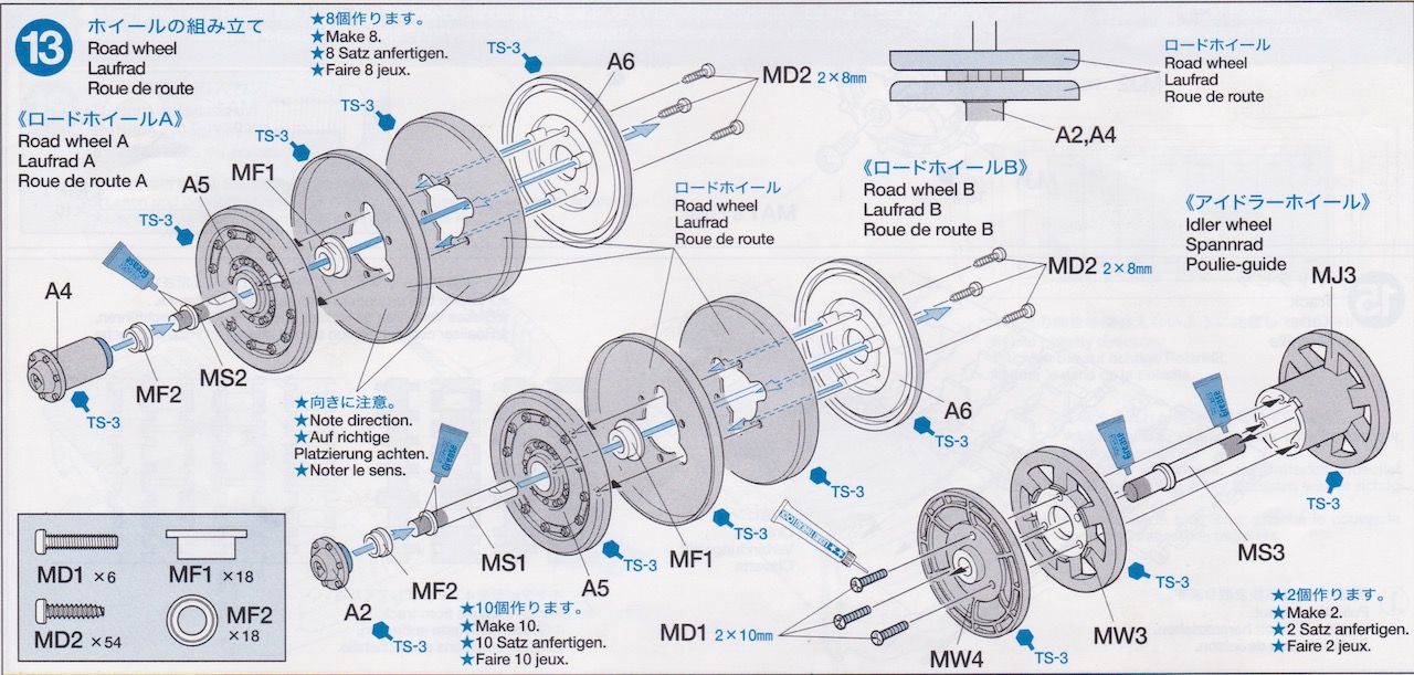

I won't dwell on the methods used to assemble the Idler, Sprocket, and Wheel assemblies except to say that while the Idler and Sprockets are straightforward, you need three hands for the wheels!
Look: Apart from ensuring the Tamiya grease is in place on the axles, you need to be able to hold the wheel components in an offset configuration, (such that a gap appears between the back to back metal discs), while adding fixing screws from the rear. Prestidigitrists used to shuffling playing cards would have an advantage here.
Frustratingly, at my first attempt, the road wheel hub containing the greased bearing broke free from the rim and the whole assembly ended up on the floor. Although the wheel assembly is made of styrene, I found ordinary cement wasn't strong enough to bond the hub to the outer Rim, so I ended up using ABS cement.

Schumo upgraded idler system is well worth the money.

Hi 43rd. I dont want to down you, or start another Tamiya VS all Fight, but just some tips from a Tamiya King Tiger owner to a Tamiya king tiger owner:
That idler kit that does not inspire confidence is a piece of shit, but you have a couple of alternatives, you can install the Daryl Turner system (pricey, but David Turner stuff is AWESOME). That is rock solid and works with springs too. I have not seen it in real life, but people speaks marvels about it. The second alternative are the Henntek track tensioners. I have installed one and its bulletproof too, but it has no springs. The third option is to throw away those small springs and replace them with putty. (Not tested by me, but I think Tom Hugil did it)

I'll certainly check that out, Adam, and thanks for the tipAd Lav wrote:Schumo upgraded idler system is well worth the money.

Thanks for the input, Rad- all observations and caveats duly noted!Rad_Schuhart wrote:Hi 43rd. I dont want to down you, or start another Tamiya VS all Fight, but just some tips from a Tamiya King Tiger owner to a Tamiya king tiger owner:
