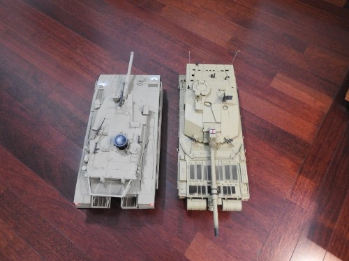

and a comparison picture with the Chally. Slightly longer and much wider.

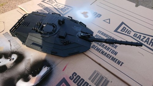

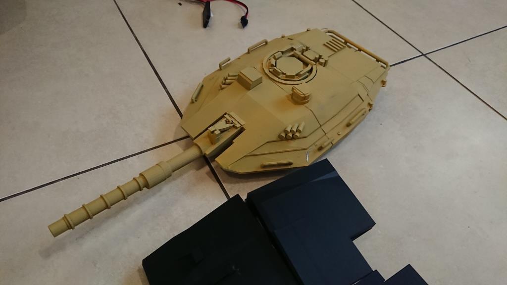

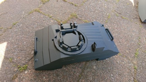

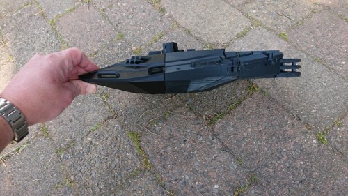

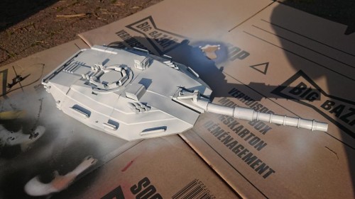

Hello Michael
Very cool build.
I have some questions.
I am 3d printing a Merkava mk4(because it is not available, had to have it)
After 1/100 i did 1/50.... This one is 1/16....
And my intention is to make it rc, by using a sacrifice tank.
I was going to use the challenger, by now i see that this doesn't fit by your photo next to each other.
If i can't make it rc, it's ok.....(not)
What do you think should fit?
I still need to print for about two weeks more untill completion, so the is time.
Already thanks
Brgds Marc

Marc, lovely 3D print you got there......... In terms of finding a RTR bottom, I still think the Chally is your best bet. Given that you don't have a lower to work with, I would suggest that you take a Chally lower and literally cut it down the middle in half and extend it width wise. I think depended on how you are doing the front and the back, you might be able to get away with some minor body work, but there is not way the chally width would be adequate.
It will be kinda like how they build stretch limos but cut length wise rather than width wise. This way you can also keep all the mechanical as well (i.e. the two gearboxes will stay with each side). I know you can get just the lower with all the mechanical from Aliexpress instead of having to shell out for a whole tank, but if you find the right deal perhaps (i.e. local supplier might have it rather than ordering from China).
Good luck !
MichaelC.
