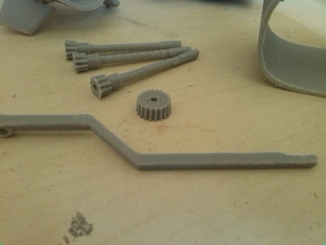

I'm having a problem printing the motor>gears driveshaft, I'll try it on the other printer when I get the chance.

Printed most of the parts, but have come across a design hiccup with the propulsion for RC. I can resolve it by designing a workaround. Dive planes and rudder are all temporarily in place.
- IMG_20170418_094632.jpg (77.06 KiB) Viewed 5826 times
- IMG_20170418_094645.jpg (57.58 KiB) Viewed 5826 times

Coming together nicely. I did notice that that not once in the video was the submarine under power. One thought - should the propellors counter rotate? It would prevent any torque steering.

If you take a close look at the video you can see that he is doing a ballast test, the sections of the hull are taped together so that he can take them apart. I just need some 3mm rods to make new shafts. You are correct about the counter rotation, one way around it is to print one propeller as a mirror image, so that it works in the opposite direction. There isn't a lot of space in there for dual motors or gearboxes.
Re: 3D printed submarine
Might be a silly question, but won't having both shafts turning in the same direction with a mirrored prop try and spin the vessel about the props? I can see a mirrored prop and counter rotating motors working.

I wouldn't doubt that for a second, it was just a wild thought. I may have to look at two small motors as a solution?RobW wrote:Might be a silly question, but won't having both shafts turning in the same direction with a mirrored prop try and spin the vessel about the props? I can see a mirrored prop and counter rotating motors working.

If you use a single motor with a toothed gear fixed to it and use this to drive two shafts fitted with the same gear you will have counter rotating props. If one prop is the mirror of the other, then both props will provide forward motion.
