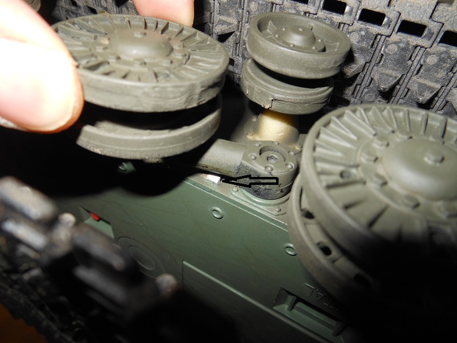

Here is the suspension mod. Similar to the Heng Long T34 suspension mod. Basically you put a square stryene spacer into the suspension travel limiter space to lower the default ride height and reduce the travel distance, see where the black arrow pointed to:
MichaelC.

Thanks Michael. I've been messaging Blimp and I think he's successfully persuaded me to rather look at the KV85 which doesn't require chassis modifications. I looked at the changes he did for the JS3 and I'm prepared to take a shot at cutting a chassis, but the changes he did to get it to the right shape were wholesale dismemberment rather than minor surgery!
Thanks anyway for the info
