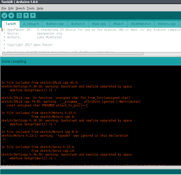

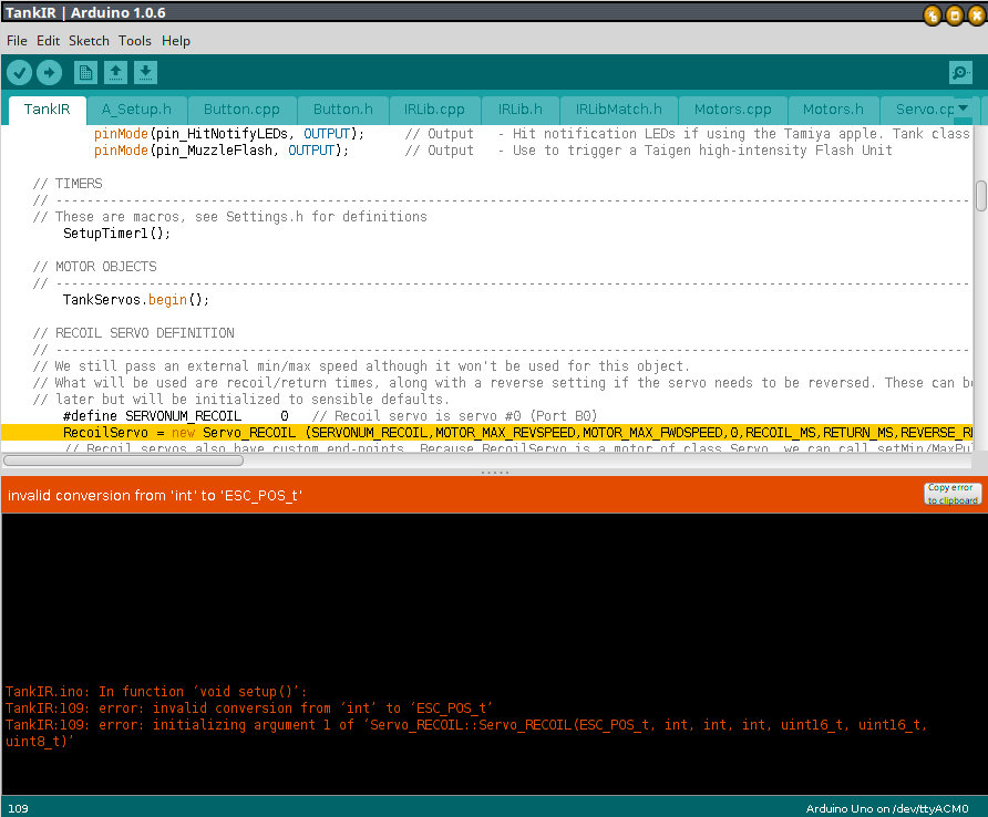

One small detail, I tried using the provided Sketch using 1.8, but as I have found with the Arduino's that I use on my 3D printers, the code that 1.8 will recognise is different to 1.6, hence any attempt to upload the Sketch using 1.8 produces numerous errors.
Using 1.6 removes the errors, with the exception of the servo recoil code, it still rejects the code.
Wibbly, as shown on the schematic, you will connect the SIG line of the IR emitter to D3 (digital 3), and the SIG line of the IR receiver to D2. GND on both should obviously be connected to Ground. VCC on the IR emitter should be connected to VIN on the Arduino, and VCC on the IR receiver should be connected to 5 volts.
I have no problem compiling the code in any version of the editor. It doesn't sound correct to me that you are getting errors in 1.8 but not 1.6, in fact your description makes clear you are getting errors in both. Something is amiss with your setup. What board do you have selected in the Tools->Board menu?

The whole Arduino thing is new territory for me, apart from editing Marlin software on the printers.
Just checked, I have 1.8.0, and the Uno is selected. Click on Verify and it generates the following:
Uno 1_8_0.png (42.34 KiB) Viewed 10752 times
If I use 1.0.6 I get the following:
Uno 1_0_6.png (32.55 KiB) Viewed 10752 times

I wonder if you are perhaps using an Apple computer?
I wouldn't think it should matter but something clearly is different about your environment than mine since it compiles fine over here.
NO SUPPORT THROUGH PM - read why
wibblywobbly
Posts: 6396
Location: South Wales Valley
Re: Arduino Uno IR Battle System
Post by wibblywobbly »
Not an Apple, I use Linux. It's all very strange. B|
