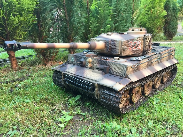

This is a Taigen example of my Tiger 1 - as you can see, it will run through mud (in moderation !).
Tiger 1 Early Taigen,

Thats some proper weathering Mr Tiggr :thumbup:
