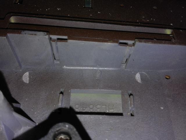

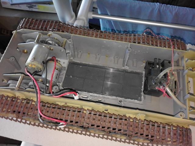

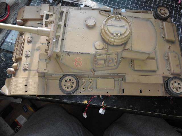

I have been occupied with other things, but have managed to make a little progress.  I attacked the lower hull with my Dremel.  Butchered would probably be a better description.  I tried a number of different attachments at varying speeds, but found they all tended to melt the plastic rather than cut or grind it away.  Anyway, what's done is done. The upper hull is pretty much as it arrived.  A you can see it is minus a lot of the fitments.  I have acquired various bits which I will fit shortly.
One of the extra I purchased was replacement clean air inlets, which are open at the top.  Obviously, I need to remove the old ones.  I was hoping they would be badly fitted and therefore easy to remove.  However, these seem to be well glued in. Can anyone recommend the simplest way to do this. without damaging the hull?  Is it just a matter of very gentle cutting or is there a better alternative? Any other helpfu suggestions will be most welcome.

If it is old stock then I would recommend "ZAP 7" Debonder and if it is new stock you need a Debonder that is better able to deal with ABS instead of the old Plastic such as "BONDLOC" or "Everbuild Stick2 Superglue De-Bonder",
They all need a lot of product painted over the item to be removed and then you should gently I SAID GENTLY!!! try to move the item to help to free it from the glues clutches,
Do remember to clean the debonder from the whole area that it was in contact with.

The original board was stuck vertically to the left hand side of the hull by the battery box..  When I tried the Clark board for size, the position of the various sockets and wires stopped it going there.  Also, the speaker was similarly fixed, so half its output was blocked. I have no idea how old it is, but the tools seem to be moulded rather than an extra, which, if I interpret other posts elsewhere, indicates that it is the old model.  To be on the safe side, I will order up both of your suggestions. Thanks for the heads up.

That ZAP 7 is magic stuff. One application plus a bit of judicious prodding and off popped the air intakes. Thank youjarndice wrote:Hi Richard,
