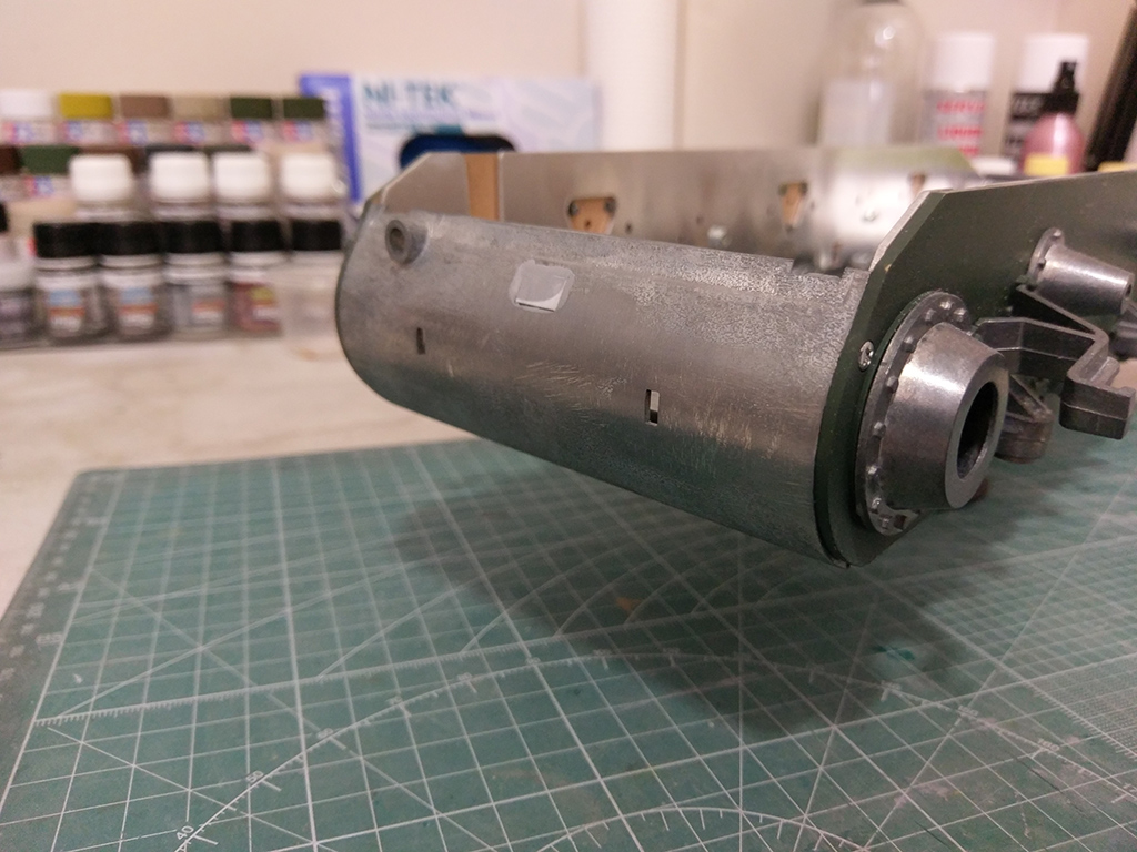

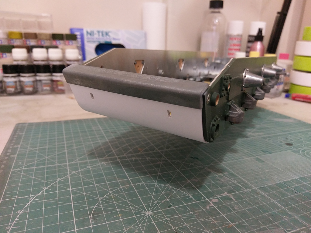

A new lower glacis for the Taigen hull, since I removed the appliqué armour plates. There were also some fairly large gaps between the sides of the hull and the bottom, so I laminated a few sheets of thin styrene sheet to cover the whole area up and maintain the correct shape.

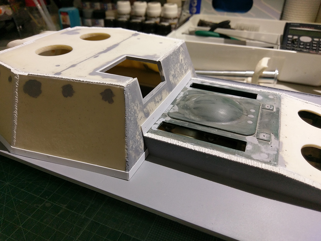

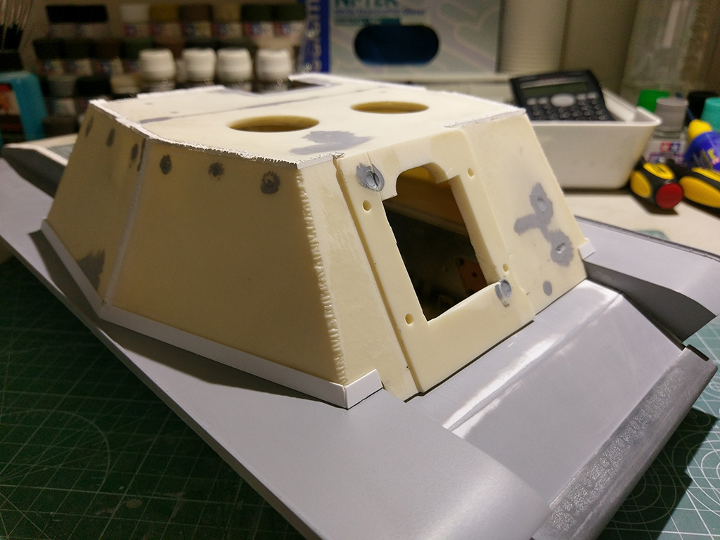

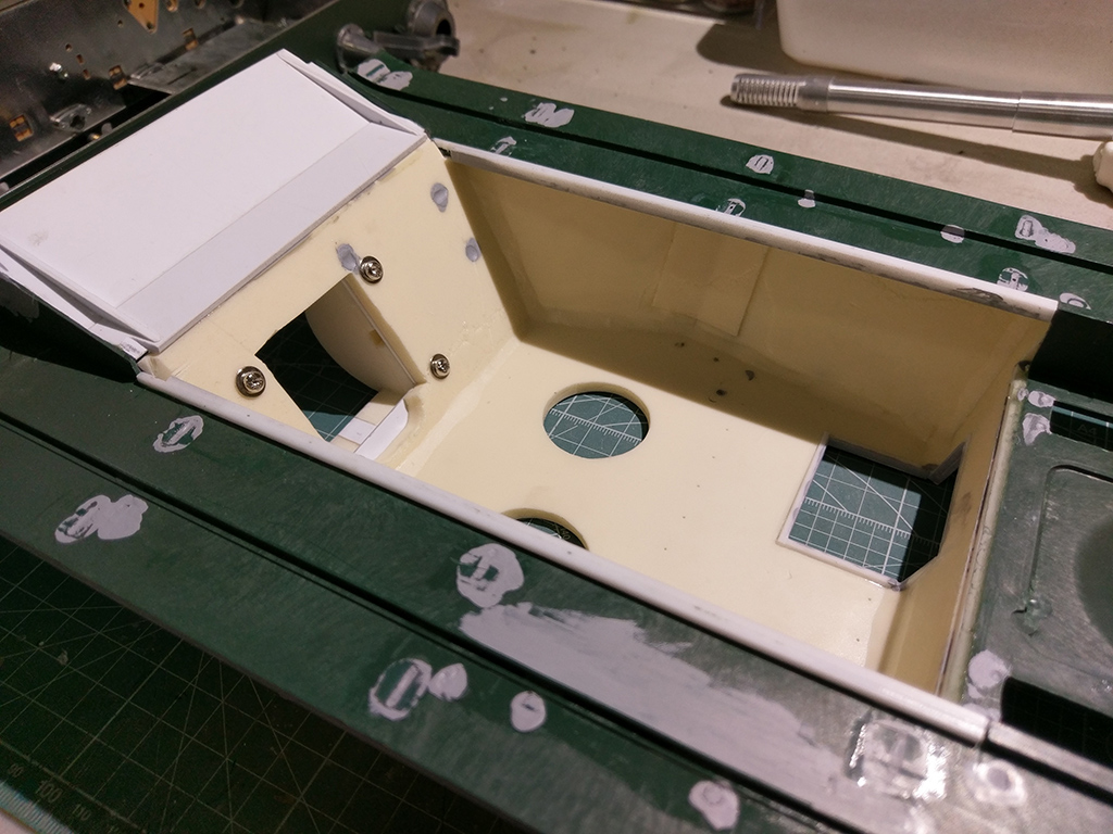

After a lot of mucking about (including cutting an entire 5 millimetres off from the front!), I've got the casement epoxied onto the upper hull. Unfortunately, the more I look into it, the more inaccuracies and discrepancies I find between the kit and the real deal. From what I can see, it looks like Herr Juckenburg has based his model off photos of both SU-152s and ISU-152s without realising they're different things. There are details that are in the wrong spot or from the wrong vehicle, and I'm trying to meet everything in the middle without having to start from scratch or driving myself nuts counting rivets.

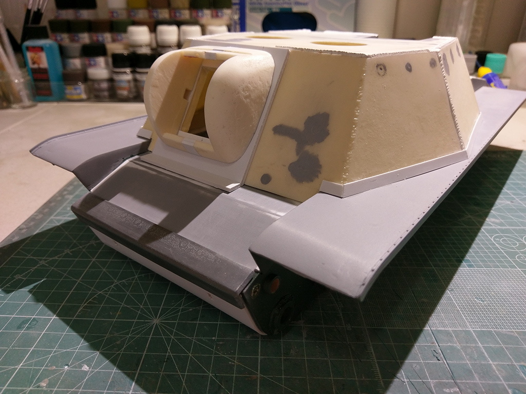

One of the biggest inaccuracies is the size of the mantlet. It's nearly 10 millimetres too small in each dimension, so I've spliced in some extensions to try and maintain the correct look. Also built up the mantlet's mounting out of styrene sheet and added the return to the front glacis.

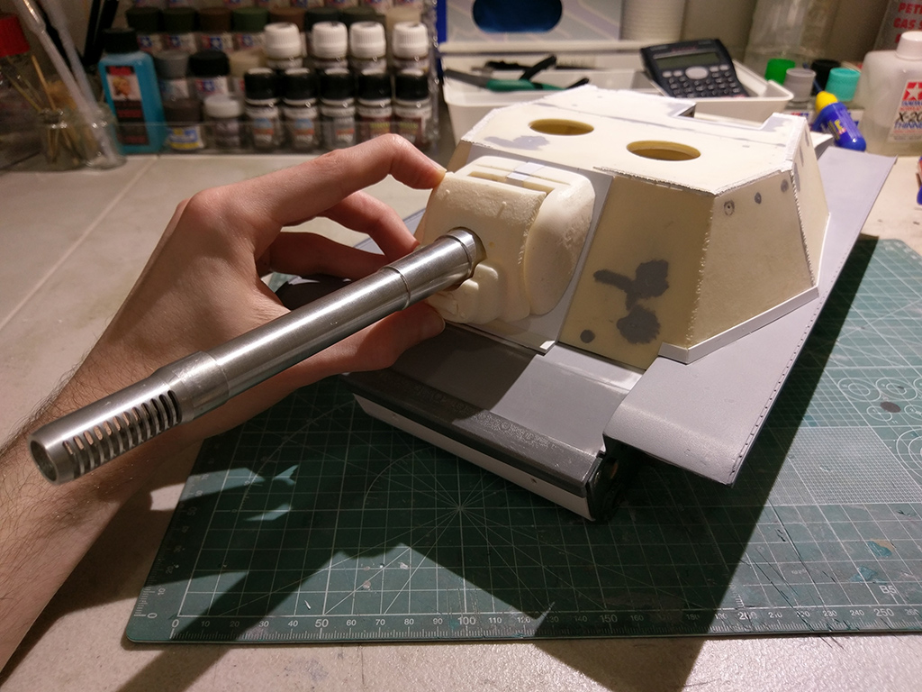

Holding the gun in place, it's starting to look the goods. Next task is working out the traverse/elevation/recoil mechanisms, then it'll be on to the detailing (the fun stuff, everyone's favourite!).

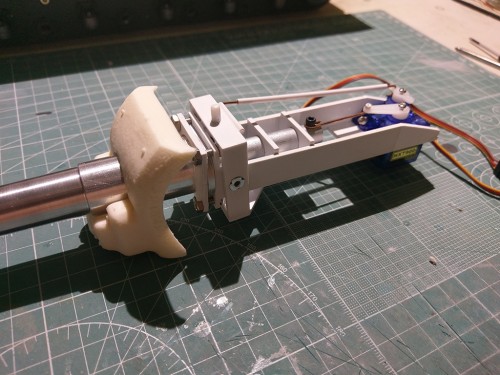

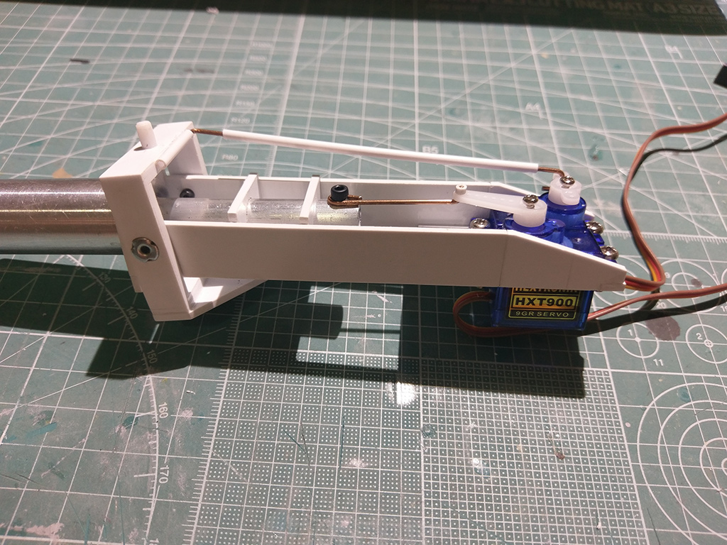

Slow going the last few weeks, been too sick to get much done. I figured that if you're not meant to be driving or signing documents after general anaesthetic, you probably shouldn't be using blades either. Managed to make progress on the traverse/elevation and recoil servo mechanisms setup bit by bit, though.

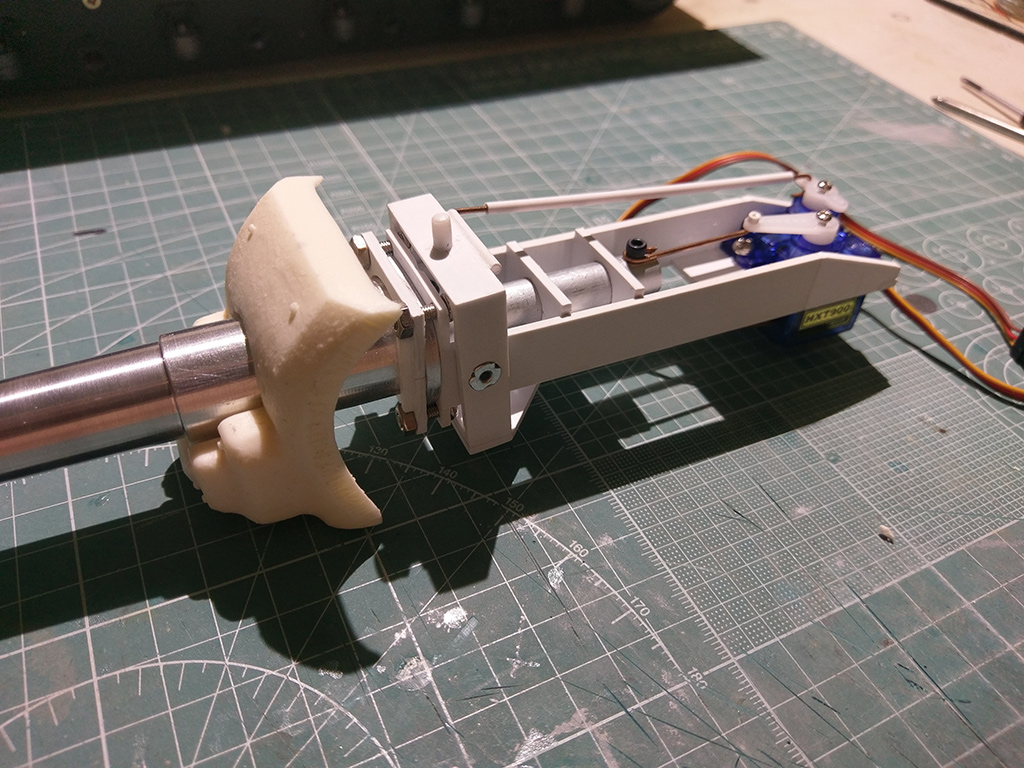

Had a bit of a brainwave for attaching the resin mantlet to the aluminium barrel sleeve. I was never going to get a straight enough fit by gluing it place, and there's not enough material to bolt it. The hole in the mantlet is about half a millimetre smaller than the outside diameter or the barrel sleeve though, so I pressed it in with a vice. It's basically immovable now.

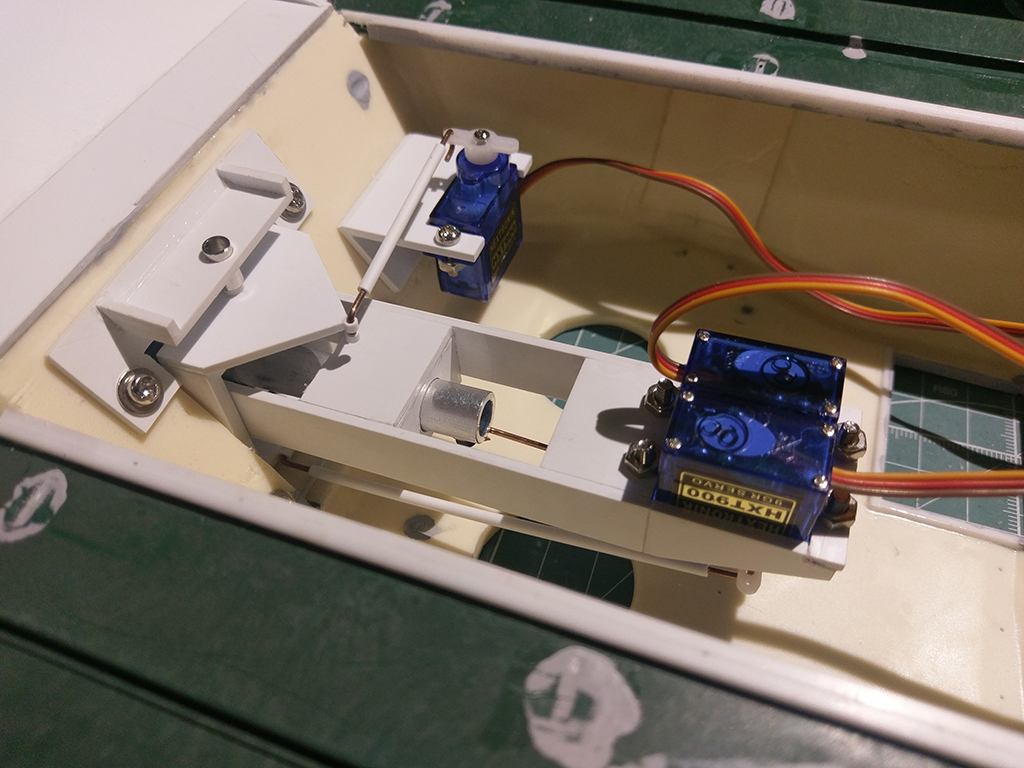

Got the full -12/+12° traverse and -5/+18° elevation now, as well as what appears to be the right amount of throw in the recoil.
  • phpBB [video]
The servos don't seem to move especially smoothly, though. I'm not sure if this is because the gun is unbalanced (that metal barrel weighs a tonne), so I'll try adding some counterweight by the recoil/elevation servos. Could it be that the servos aren't strong enough to move the amount of weight there?
