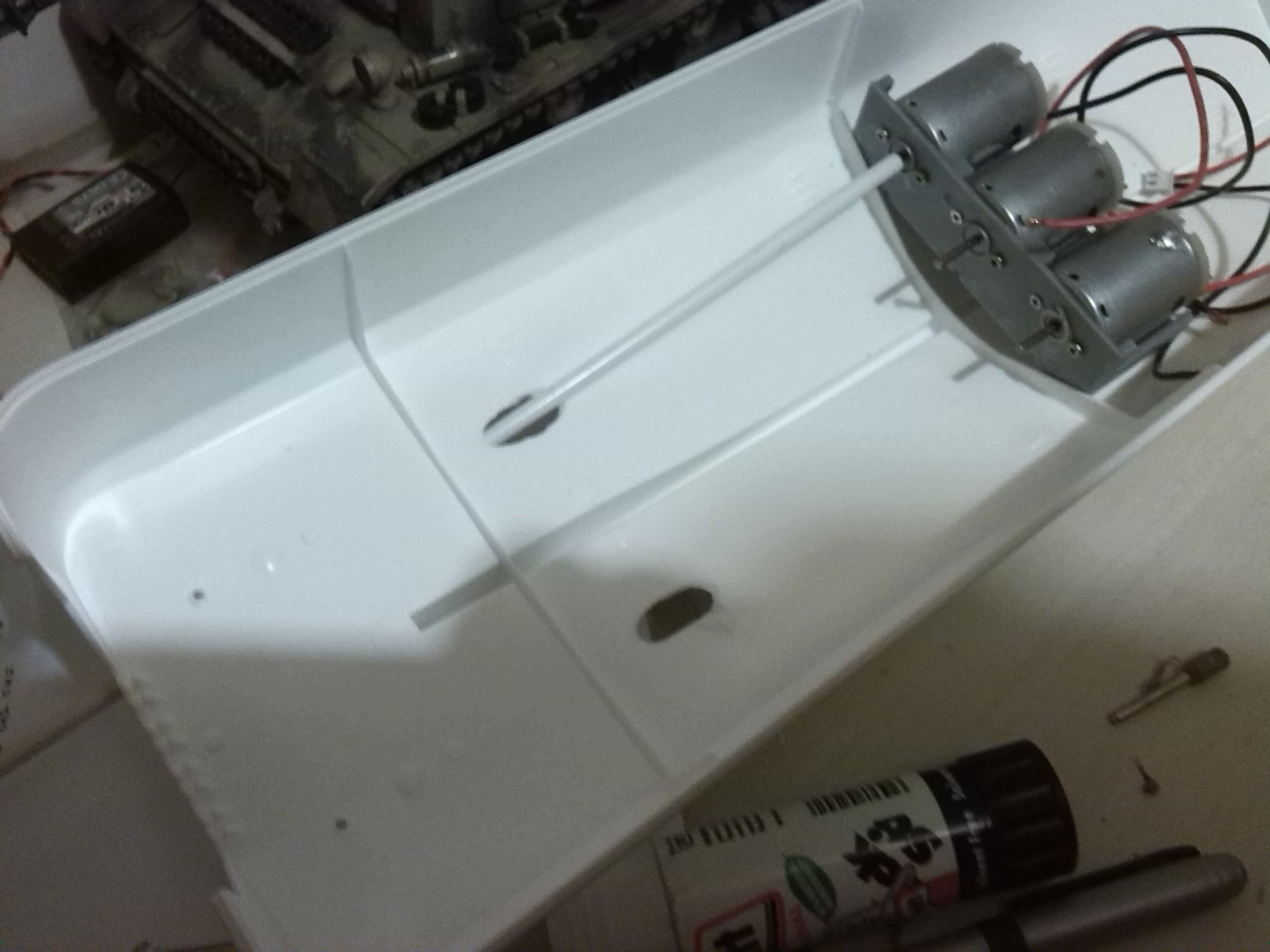

The kit arrived today, jeez, that's a lot of sprues and parts! Good news is that the hull is one piece and quite rigid, so no gluing two halves together or anything. I just needed to drill out holes for the twin rudders, and the propeller shafts.
I printed a motor mount that will take three spare Heng Long 360 motors, as can be seen in the pic. My question is, if I tilt the motors so that they line up with the shafts, do I still need to install universal joints, or can I get away with a direct link from the motor shafts to the prop-shafts? It will be a piece of cake to get everything perfectly in line but is there something I don't know? Buying the joints isn't a problem, they are pretty cheap, but to my befuddled mind if the whole shooting match is in line then it reduces vibration.
I will be using brass tubes etc, I am using styrene tube just to see what's what.
