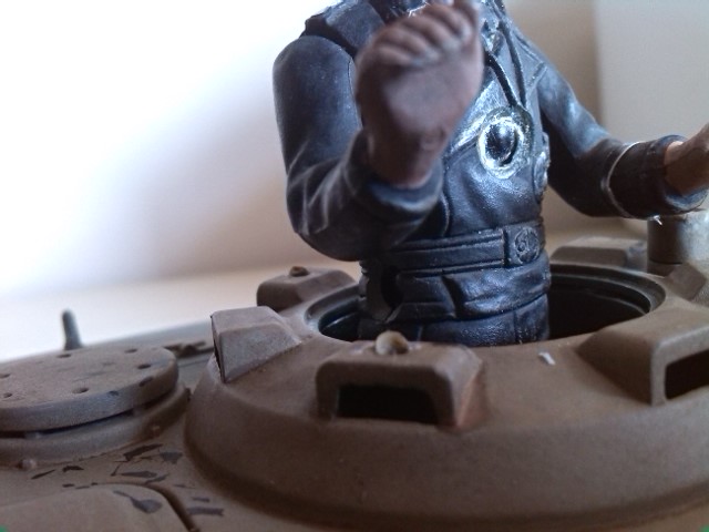

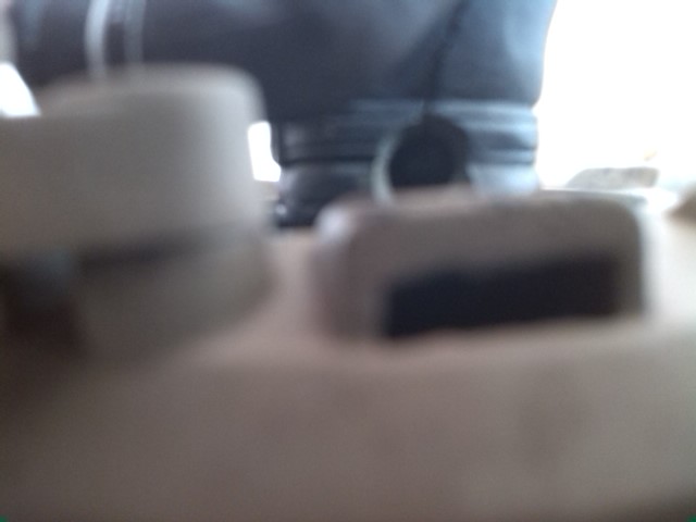

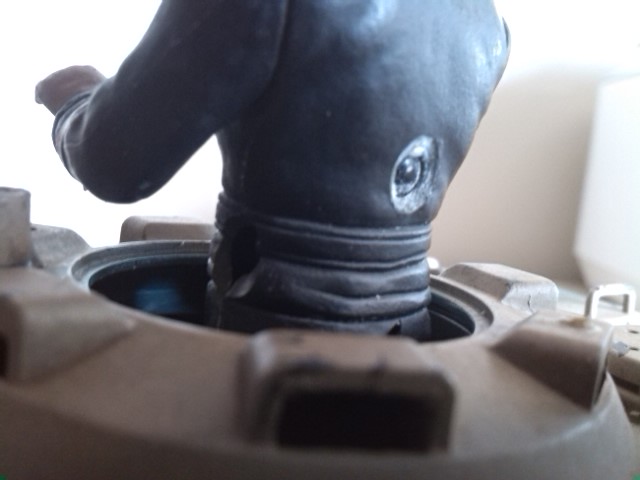

I am in the process of preparing my KT for a new board and needed a battle system to go in it. Due to it having a Porsche turret there were very few places to hide the sensors, so I grabbed one of my old HL tank commanders and decided to try mounting them inside of his chest. It was a bit fiddly to do, but I managed it in the end. I'll paint around the holes etc before the final installation. I simply drilled the holes and used a countersink drill bit to widen the angle, then glued them in place. Getting glue on them isn't a huge problem as IR light will pass straight through it.
