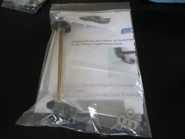

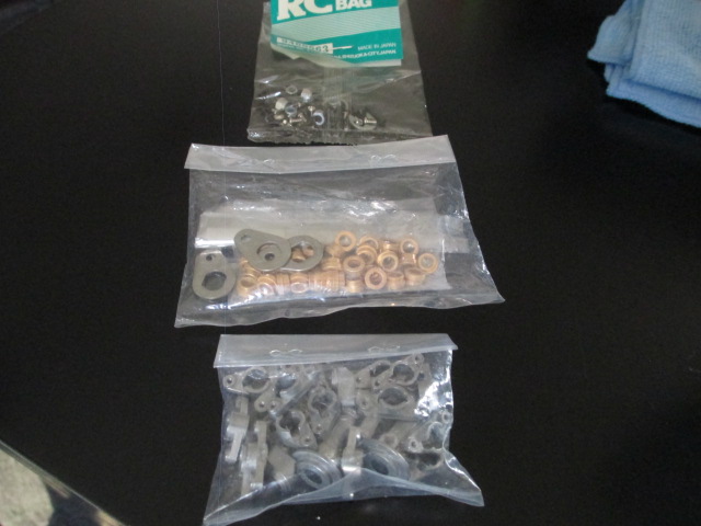

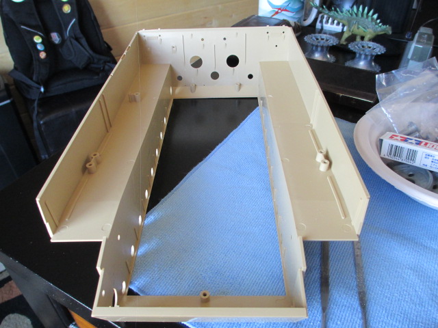

Speaking of pictures: I took time today to familiarize myself with all of the extras Sass has included in the kit vs the stock Tamiya parts. We're off to a running start! Pics:
Off to Step Two tomorrow ;o)
- replaced by one brilliant piece of _tough_ metal adjustable component...
- replaced by one brilliant piece of _tough_ metal adjustable component....JPG (81.87 KiB) Viewed 6620 times
- parts required from all three of these bags...
- parts required from all three of these bags....JPG (89.17 KiB) Viewed 6620 times

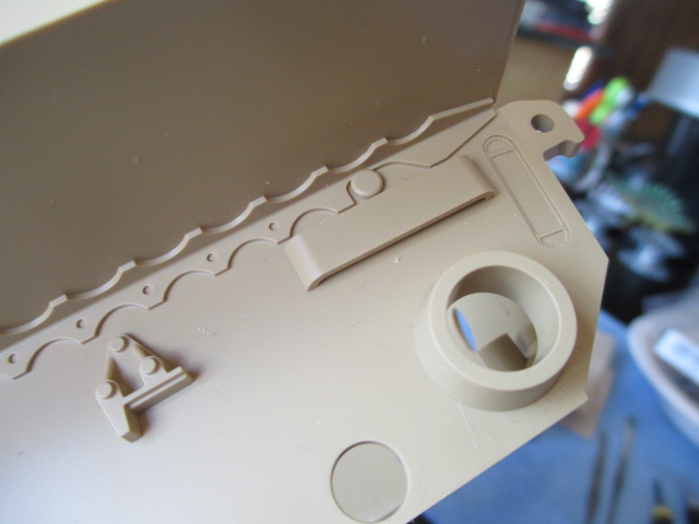

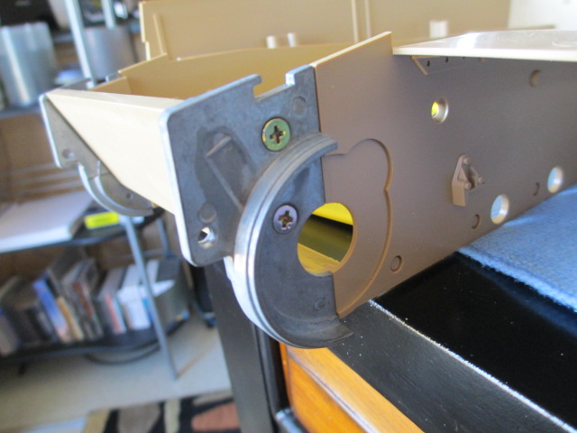

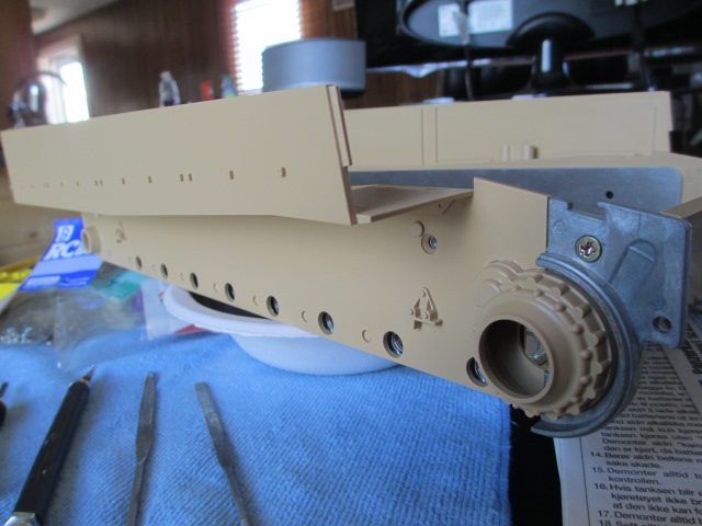

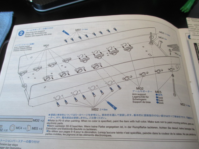

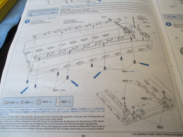

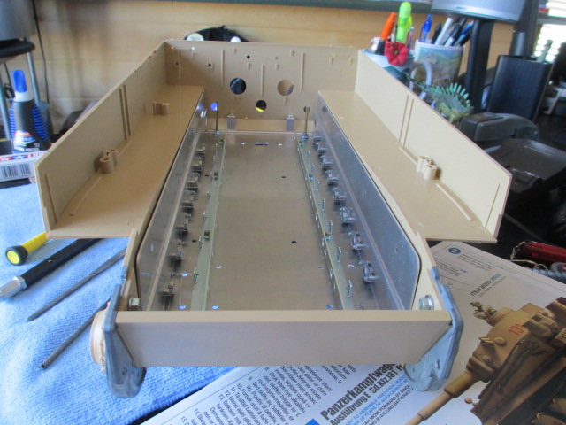

Kaiser, I enjoy your enthusiasm but that icon is more than a little creepy. *chuckles* Worked through Steps 2 and 3 today. This involved removing the ETO Gearboxes I found already screwed in. Nice solid mounts on those and to be honest, that word really encompasses the entire gearbox, 'SOLID' Made for big tanks and it shows. I wanted to try and seal the inner hull idler adjuster holes using part of the Tamya adjusters but no. Too floppy. I will end up sealing those holes with a plate or a shorter, squatter engineering screw. Advice for folks thinking about building a Tamiya tank: The tools that Tamiya provides are nice and will do the job...my advice is to go a step further and use magnetic tip engineer grade screwdrivers and star drivers, etc. Have a magnetic bowl to hold screws or just a container to separate the bag types out. A little foresight and preparation will make the build thoroughly enjoyable instead of a mad scramble to find a dropped screw or having to get up constantly and break focus to retrieve a tool or part. Pics:

Thank you, sir. I have heard the word "flimsy" bandied about when describing these Tamiya inner hulls. Not so with this Tiger 1! I am really impressed. ;o)

Yeah the Tigers one of the best because it forms a nice box shape, to be fair the only really flimsy on is the King tiger!PainlessWolf wrote:Good afternoon, Tom,

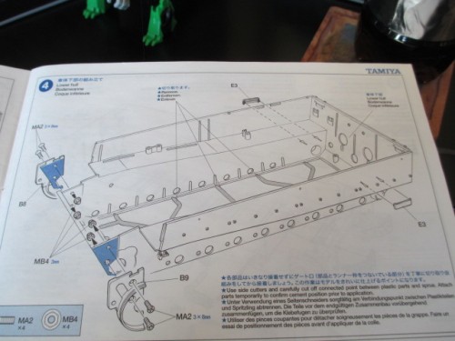

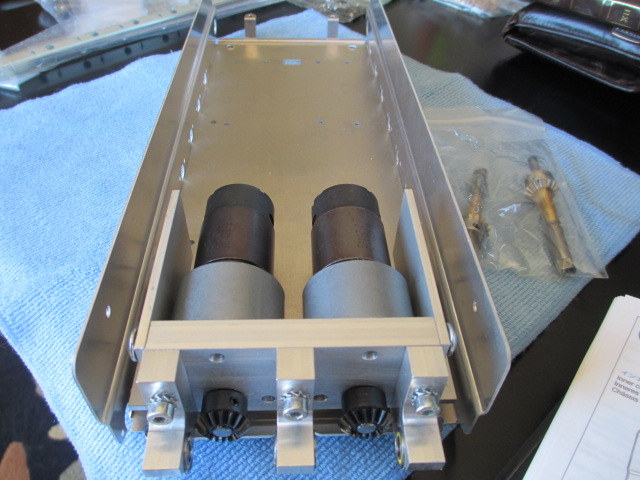

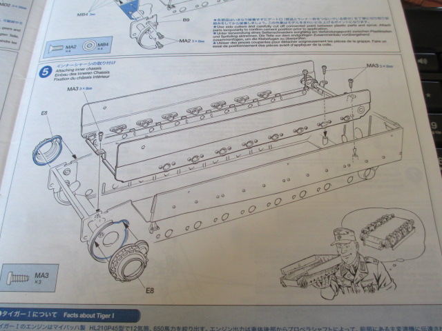

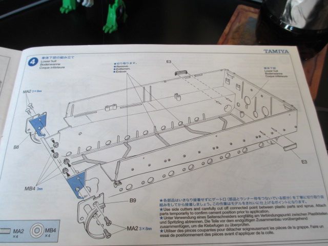

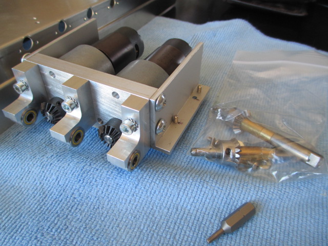

Ad Lav, One of the best things about those gearboxes is that they are drop in parts, made for this series of tank. Today saw Steps 4 and 5 completed. Starting to use some of the metal aftermarket pieces. They are from Wecohe I believe and a perfect fit. Starting to think about some of the ways that I can improve this build. I'll add things by Step and not get ahead of myself. Pics:
- Hull is getting heavier
- Hull is getting heavier.JPG (98.5 KiB) Viewed 6546 times
- Tamiya plastic
- Tamiya plastic.JPG (75.35 KiB) Viewed 6546 times
- Metal aftermarket
- Metal aftermarket.JPG (94.64 KiB) Viewed 6546 times

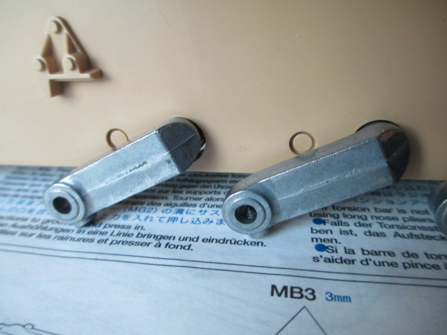

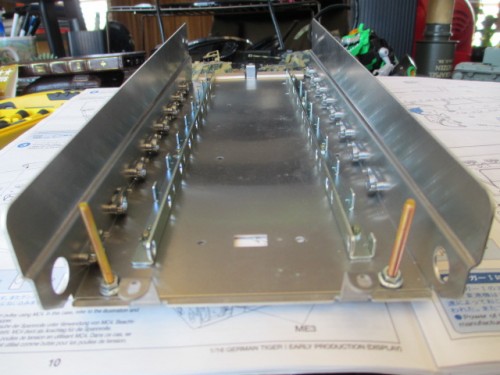

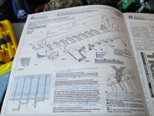

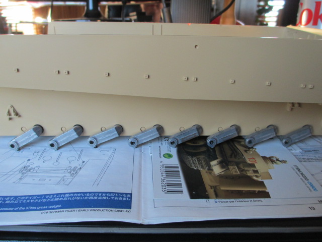

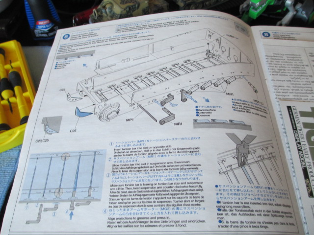

Step 6 tonight and as it involved torsion bars was mainly a lot of repetition. Two tips from it, A: If you look at the illustrations for this step, you will see the way to do it almost immediately...if you read the How-To, not so much. B: Use this time with the swing arms to do a little flat file work and clean them up before you mount them. Will look a lot better later, painted. Pics:
- Cleaned up with a flat file
- Cleaned up with a flat file.JPG (89.89 KiB) Viewed 6110 times
- Assembled and a good way to kill an hour
- Assembled and a good way to kill an hour.JPG (93.5 KiB) Viewed 6110 times
