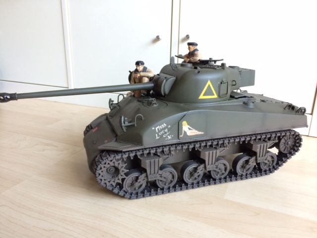

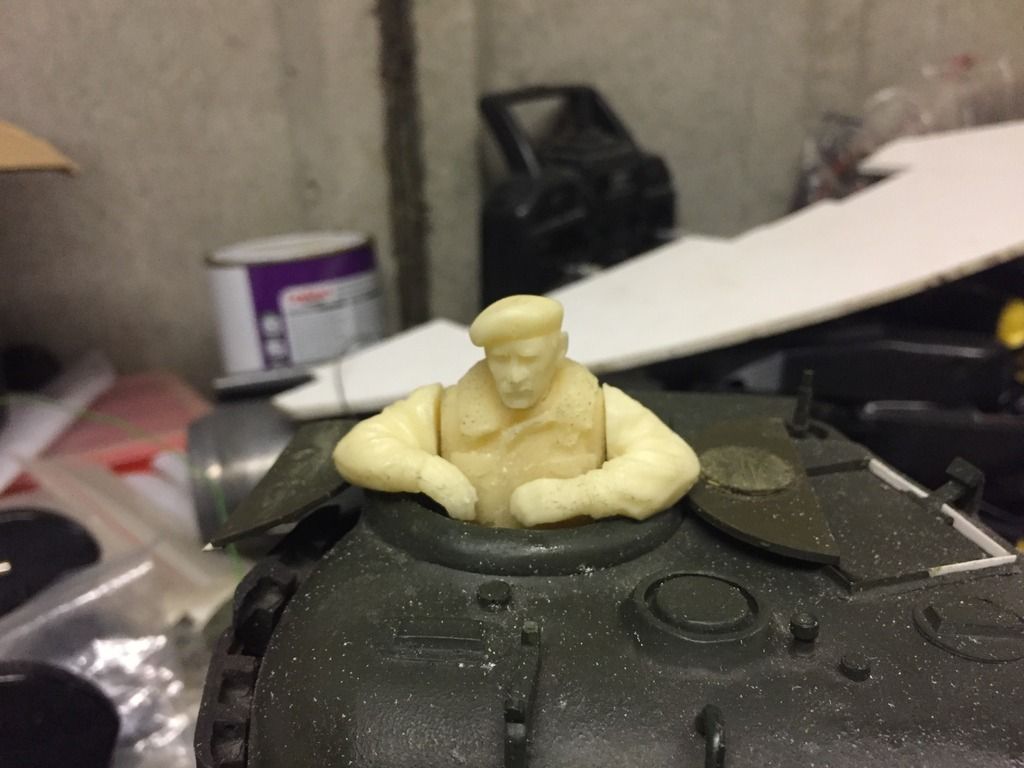

Deffo has that 'Don't Mess With Me!' look, nice bit of work there Tom, and it's totally unique in 1/16th scale.
Re: Hybrid firefly
You'll have to see if you can do a deal with Dave as he now has the guy I did based on the one in the photo sitting in the front hatch lol
remember...it's just a plastic tank...

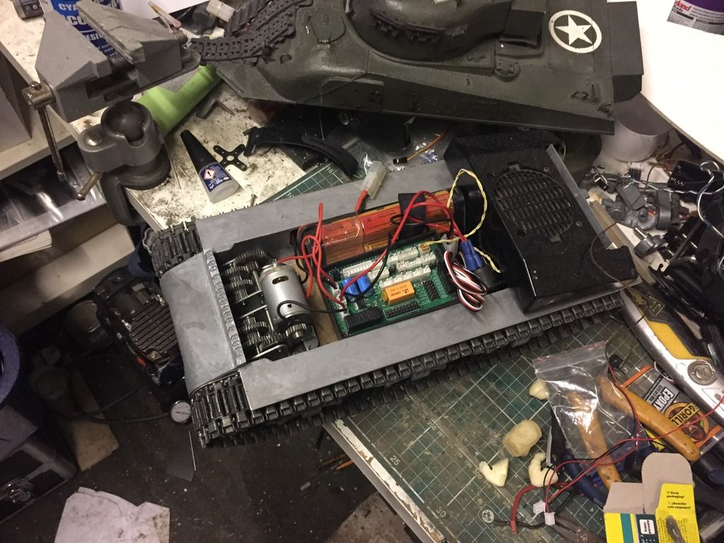

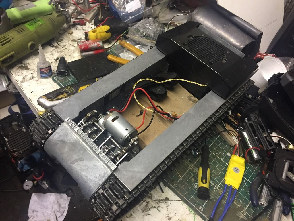

Dusted this one off last night, It will probably be getting an IBU2 pro this weekend so afew jobs to do including fitting a battle unit, ir emitter, speaker, flash unit and turret rotation.
First up adapting the tamiya speaker to fit the Mato hull. Couple of bits needed cutting out of the speaker and hull.

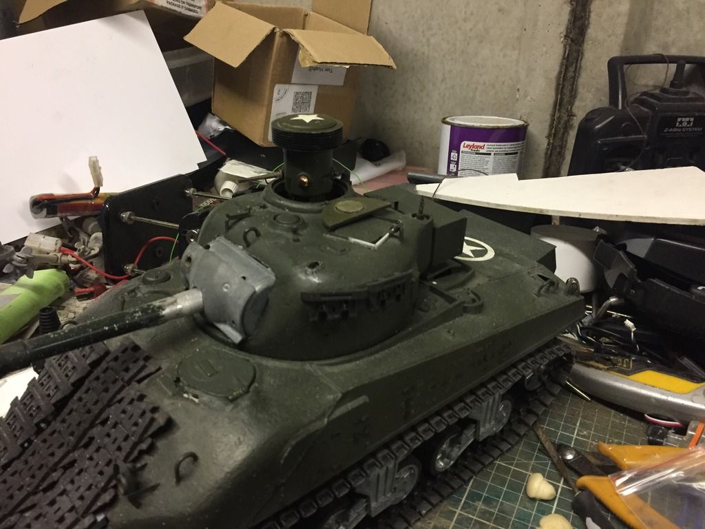

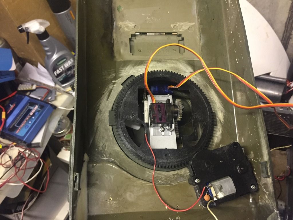

Turret rotation, fortunately the turret its self is wider than the HL rotation ring so I can lift the turret out of required. The rotation unit had to be sited under the drivers hatch to prevent interference with the speaker.

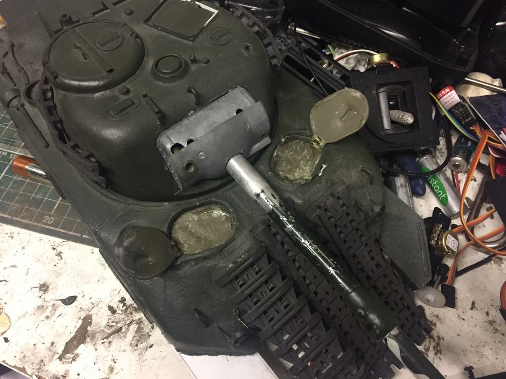

Last job was the opening hatches, added pins to the hinges to give them a bit more strength. Next job is to cut out the openings where I'll put the on off switch.
