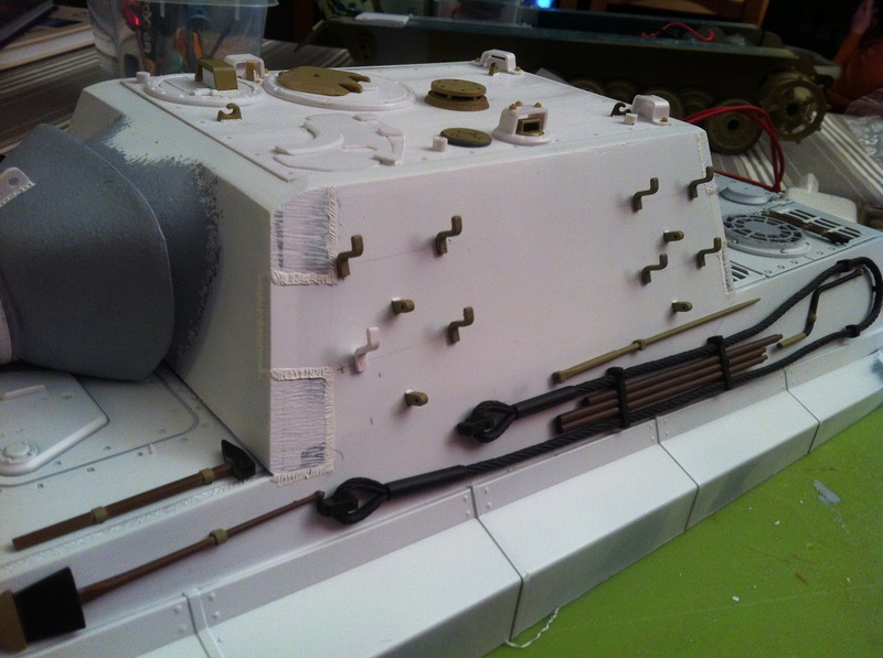

Really enjoying Reading this tread, details looks awsome, Nice weld lines on the super structure to . All parts 'home made' , ore is it a mix of Ludwigs parts here to ?

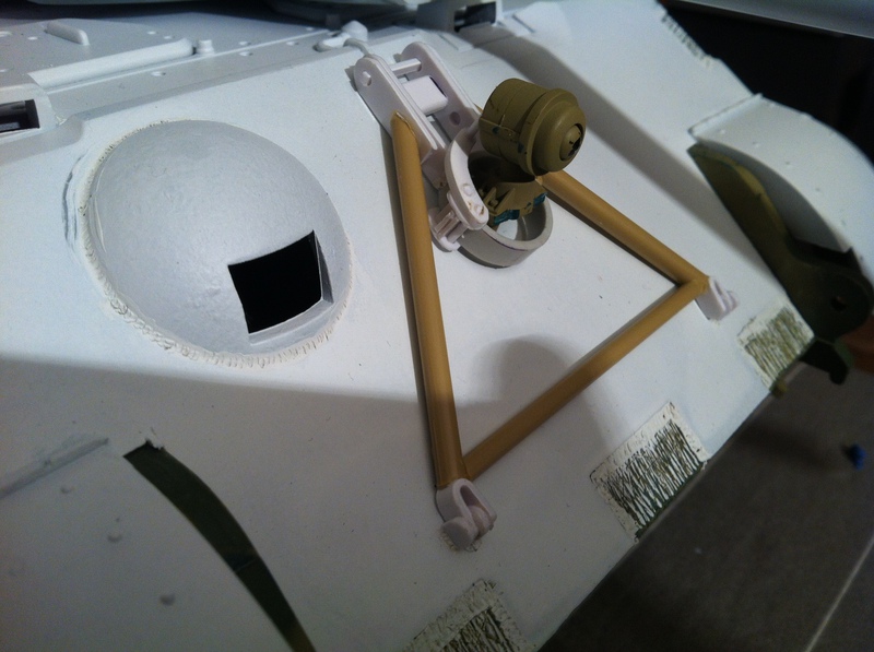

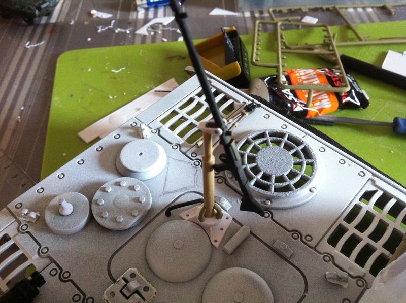

Thanks, no parts from Ludwig, only home made parts or leftovers from the Kingtiger. The gun support is made with PVC tube and plastic sprues.
Same technique for the rear MG support.
Spare tracks supports are borrowed from the Henschel turret except for one that I have lost... :/
New holes have been drilled for the cables and tools.

what did you use to create the 'torch cut' marks on the front plate . looks like a neat trick

Torch cut marks are made with a small triangular file.

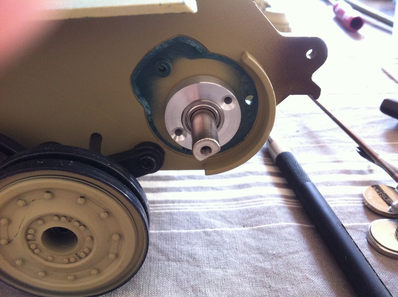

Thanks. I bought those nice output shaft bearings; I hope they will help with the durability of the pot metal transmissions.

Very impressive work; nice job!! Where did you order the output shaft bearing setup from? They look pretty nice

Rctanks.de sells them. They're a great little addition to the hull.

As jackalope wrote, support bearings are from rctank.de, I think it's a must have on any tank with long output shaft.
