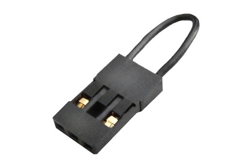

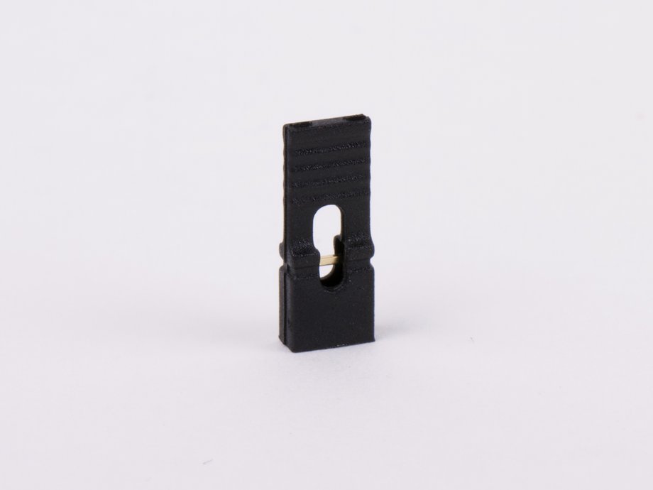

Mark, it is just any 2 pin jumpers like these:
Or these:
You must also has one of these to bind the receiver to the radio which you can then modded by pulling out one of the leads and inserting into the middle:
If you have never done it, you need to use a small flathead screw driver and lift the plastic tab up so it won't catch the lead when you pull it out.
