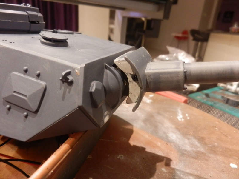

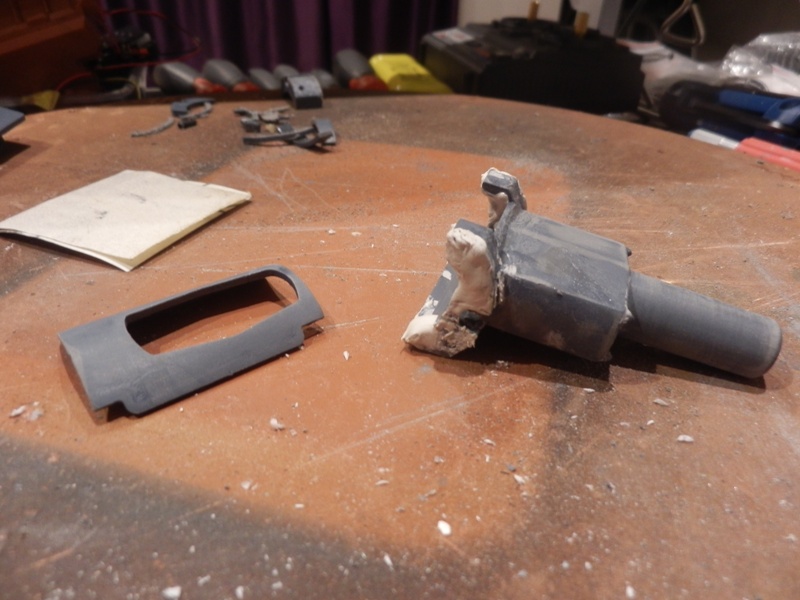

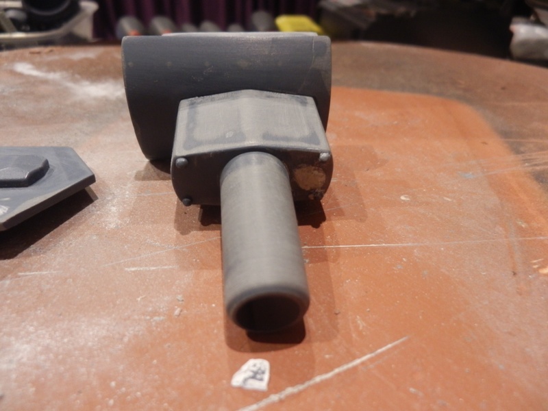

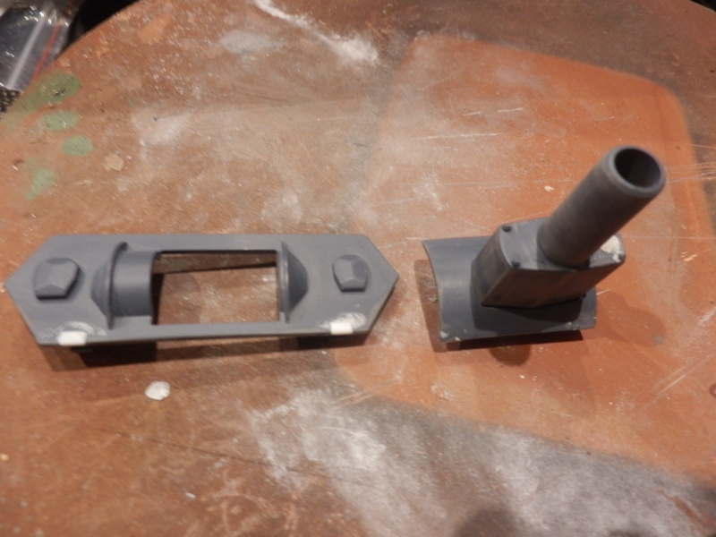

More hack & slash.............mantlet mods as per Mr Philipats lead.
Theres a lot to these IV builds even only to an F2 level, let alone further marques.

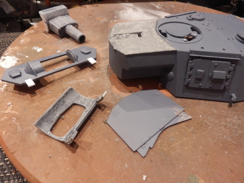

Re: HERMANS 'GERMAN SHERMAN' PZIV F2 'B11'
Got the bin lid off in one piece, just a nick out of the corner section behind the cupola. Lowered enough to get the look, but its still huge !
Unless I get fancy with the elevation system, thats life.
The lid will glue back on and be good enough to cover the correct area. Nothing a rolled tarp or helmet cant assist with ;)
Getting the last of the mantlet mods done, soon be on with other turret details.

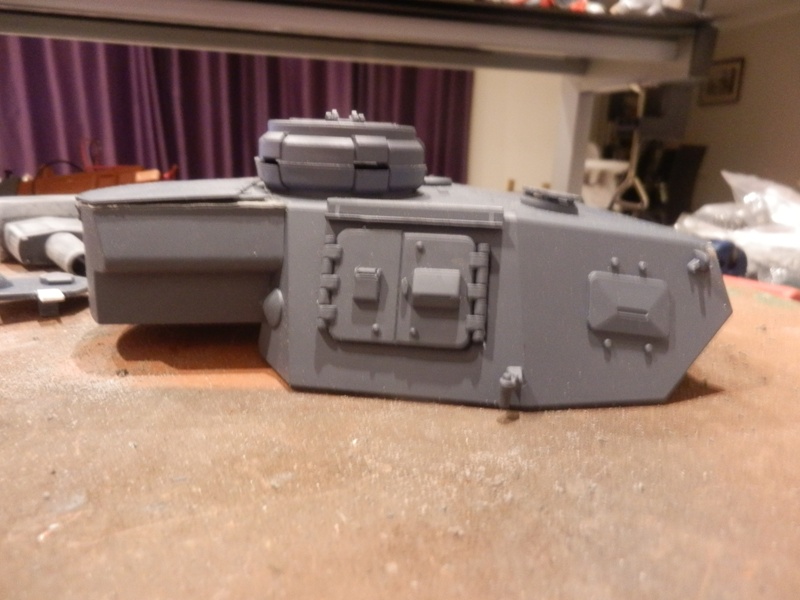

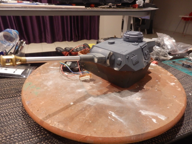

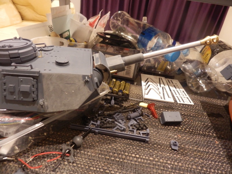

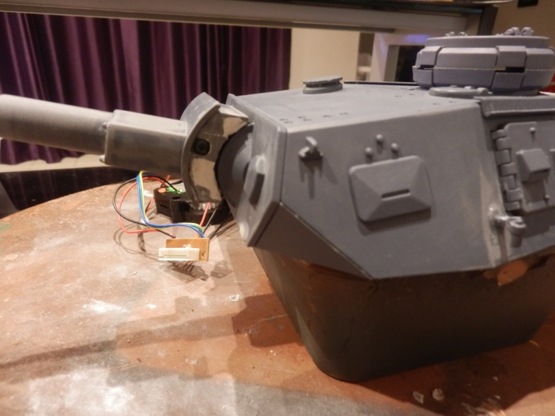

Turret is together.
Still needs plenty of work, but the look & feel is much more better'er !!

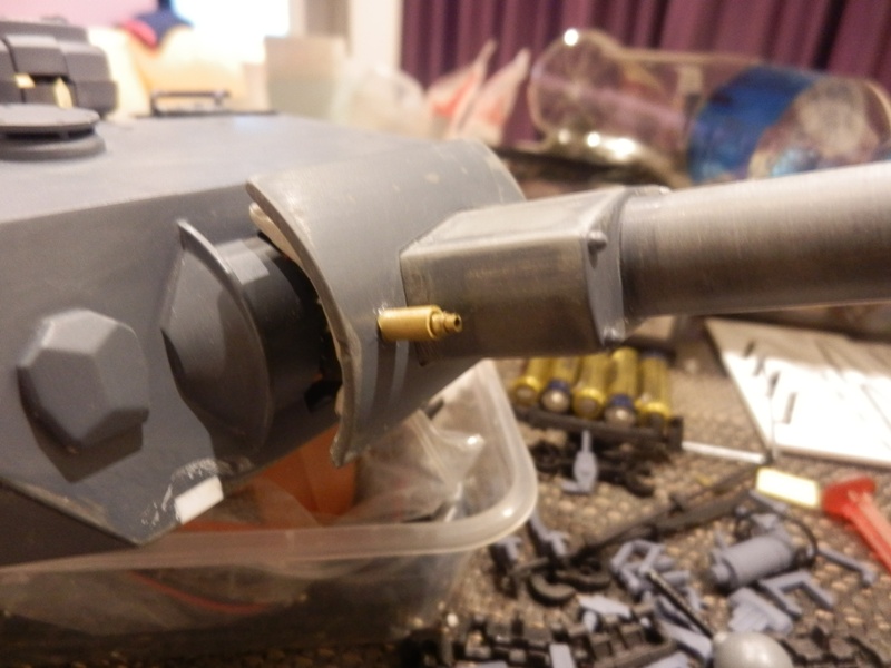

The mantlet mods while effective, are not perfect. The mass of plastic behind the actual shield is still to big, but as I dont have much option with the gun the way it is, then this will do. Paint & texture will reduce the starkness of the gun mount as a whole I hope.
The new barrel is a treat. Not being airsoft, its much more in scale, with the muzzle brake while not an F2 per-se,allowing for artistic licence for a retrofitted F2 with a new brake fitted infield, its much nicer. Looks like a IV now, I just cant cope with the ball style muzzle brake......................
Moved the turret hatch stops(using reclaimed originals) and secured the BB loading hatch(I wont need it)
The turret side vision hatches might stay yet, they are F2 spec, and though the picture shows B11 without them, the dates the machine would have been manufactured for the Malta invasion operation would mean it should still have them.
There are plenty of F2 pics around with apparent accurate dates associated that have the side vision hatches, which fit the Malta invasion/deploy to Russia timeline scenario, so why not eh !!
Co-ax MG still to do, brass tube & paperclip will do for this.

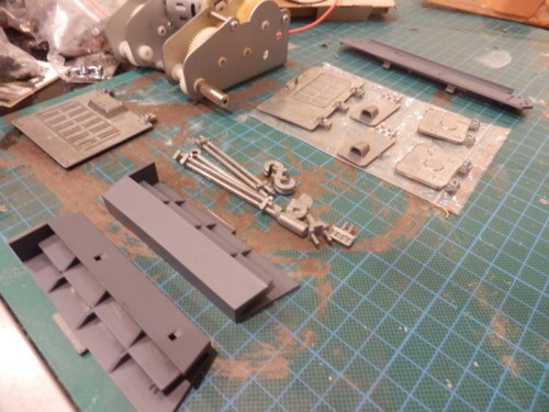

All the metal hatches are filed & hinges pre-fitted.
Rear plate removed & engine vent housings removed. Ready to lower, question asked on how much.
MG fitted to mantlet (used three sections of brass tube telescoped)
Centre plate on upper glacis track mount holes puttied up & sanded.
Commanders 'rifle' sight fitted.
Lower hull ABC slot backed with styrene & puttied up.
About to begin removing the moulded hatches from the upper hull.

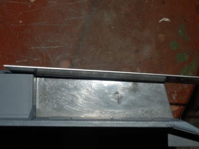

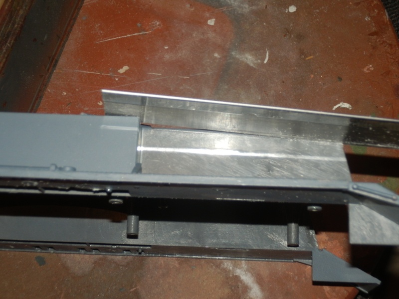

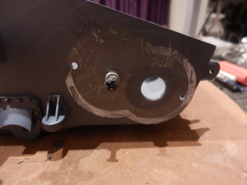

So, I took the engine deck slope in hand. Figured that anyone looking would use an eye, so I lined it up by eye :crazy:
Measured down the rear plate 4mm.
Shot a line across the vacant vent area up to a mark parallel with the longest engine hatch joint. Thats 5mm behind the vent bulkhead.
Got out the razor saw & got after it.
Cut up the pencil line until the saw started cutting into the actual engine deck moulding.
Went again flat against the upper engine deck to remove the wedge.
Seems to be looking about right.
Will remove the attachment points and install the hatches.
I reckon the attachment points can be reused by fitting cross members between the vents & securing the hull attachments to those.
Probably by screws down from the top, so the hull screws can still draw tight from below.
Lets see eh........... ;)
