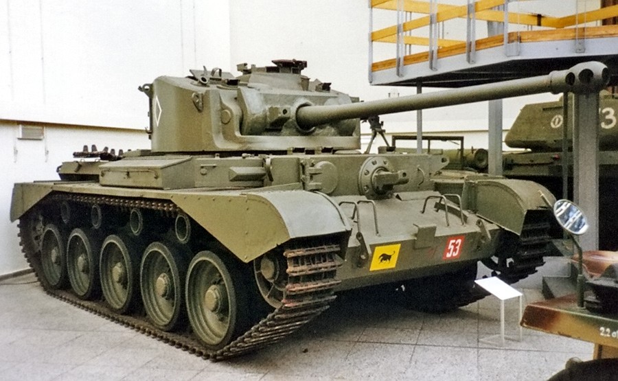

When you compare Michael's Comet with this model in a german military museum, you begin to realise not only what an eye for detail he has, but also how donor parts from an array of other tanks can be combined, and transplanted, to make a pretty faultless study of a real tank.. :clap: :clap:
The Study..
The Study..
Michael's Comet.jpg (78.85 KiB) Viewed 2761 times
and an original:

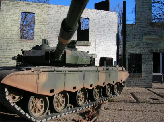

For streaking and this one kills me! There are companies out there that sell these rust washes, engine grime, streaking formulas, etc.. and all they really are are oil paints thinned down which you can buy for a fraction of the price! Go to a artists store and find the cheapest oil paints you can find. Things like burnt umber, raw umber, and other colours that interest you. Take them home thin them down to a little thicker than water consistency with colour in them. Use a small brush and also from the artist store buy a large round 1" bristle brush. Practice on some painted styrene by putting a couple of little dots on an edge leave it for 20 or 30 seconds and then take your bristle brush and pull it straight down and viola! Streaks! Here is an example on a ZTZ99A
