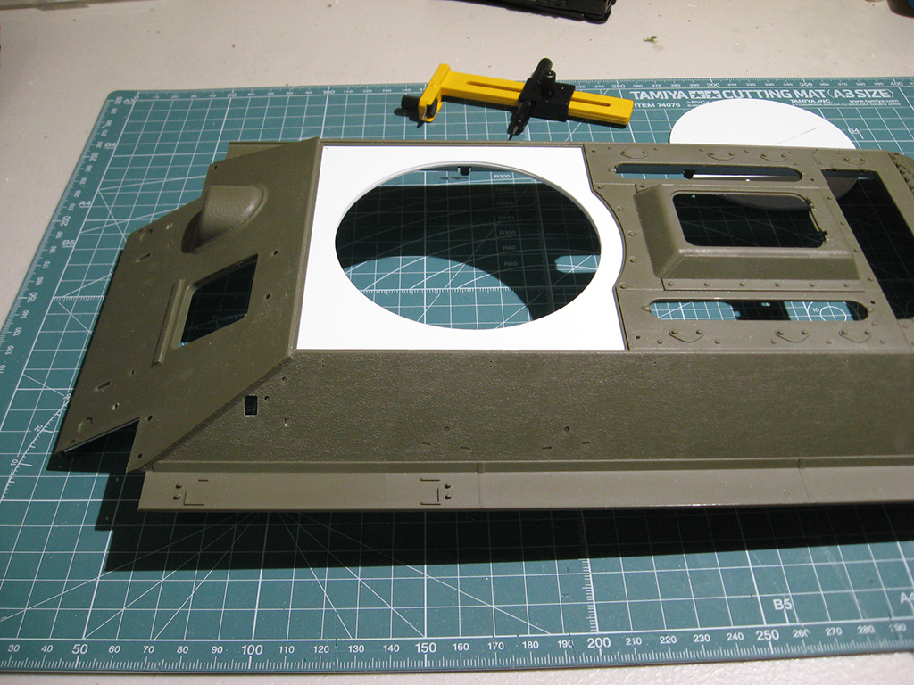

Hello Dan , I use an OLFA compass cutter for doing holes , most art stores stock them :thumbup: B.

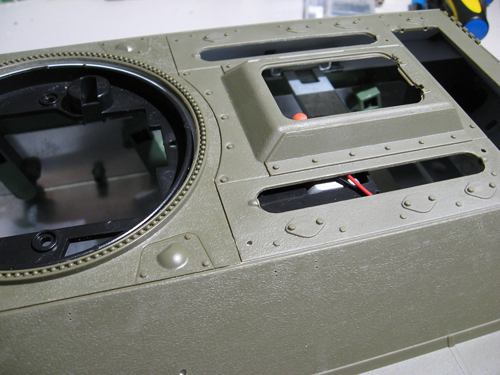

Yup, that's the one I was waiting on! No luck with the hole saw, so I'm glad I got it ordered in; it made quick work of the styrene sheets in the hull top.

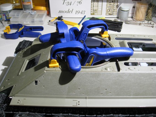

Once that was done, got the roof of the fighting compartment cemented and clamped on.

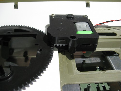

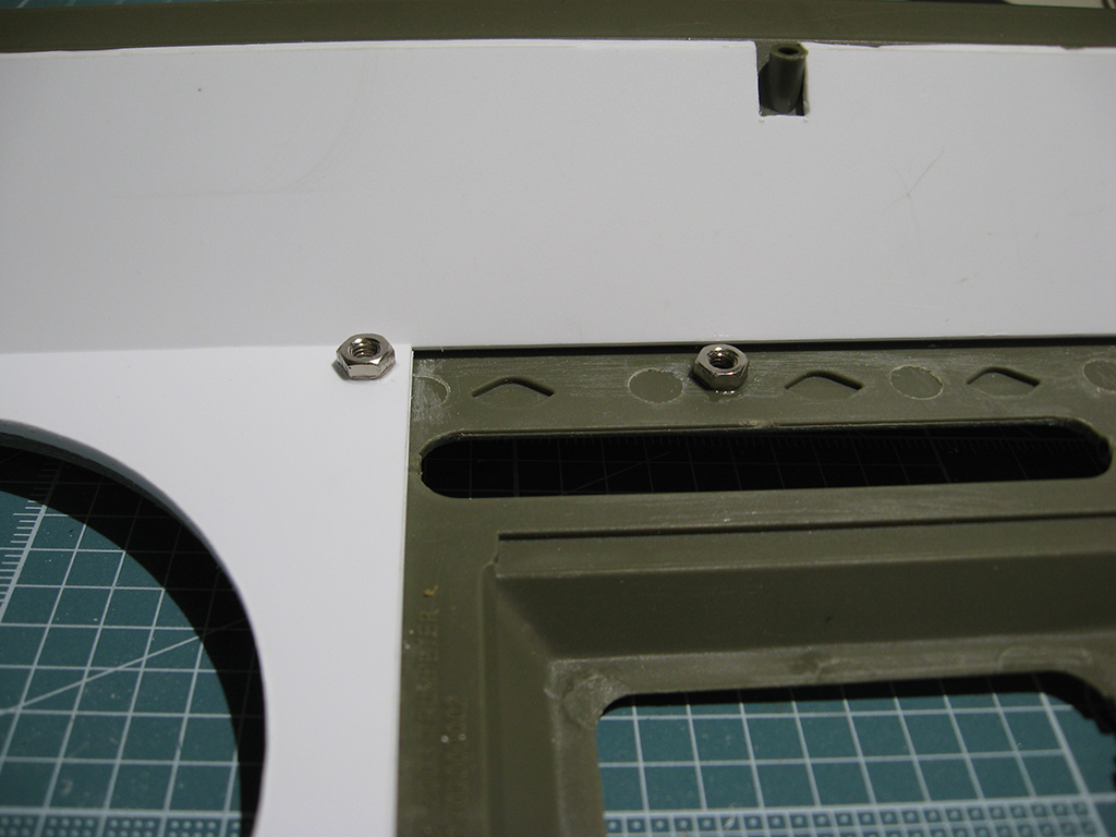

I tried a few different arrangements for the turret rotation motor, but ended up supergluing a few M3 nuts in place so it can be bolted on. It seemed like the most foolproof method.

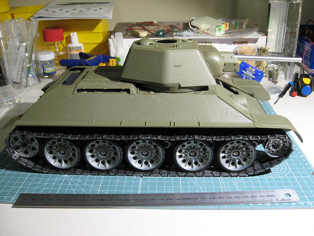

Just a quick shot with everything placed on top to make sure that nothing is visible from outside the tank, or interfering with the fit and finish.
I'm really happy with how it's coming together so far, I think it looks the part and I haven't even bled yet!

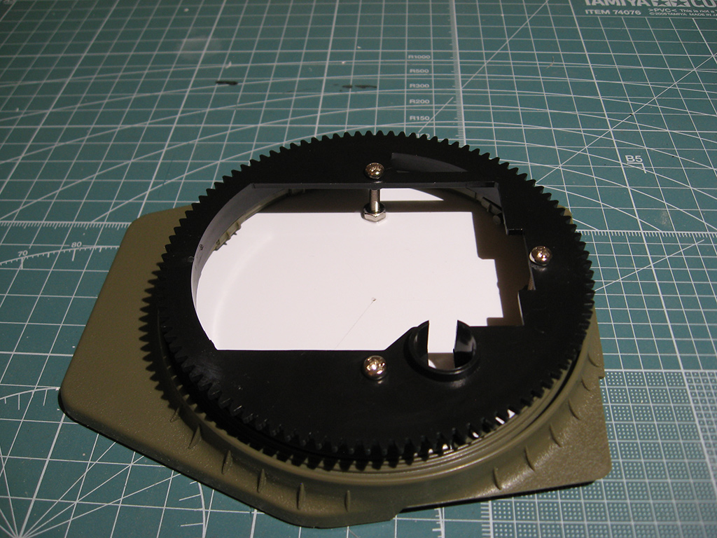

A little detour before figuring out the turret mechanicals; mounting the turret to the hull. Again, lots of detail on the interior, but those boltheads get in the way and had to be removed.
Having cut them off, I could then get a styrene plate in there to bolt them turret rotation gear to.

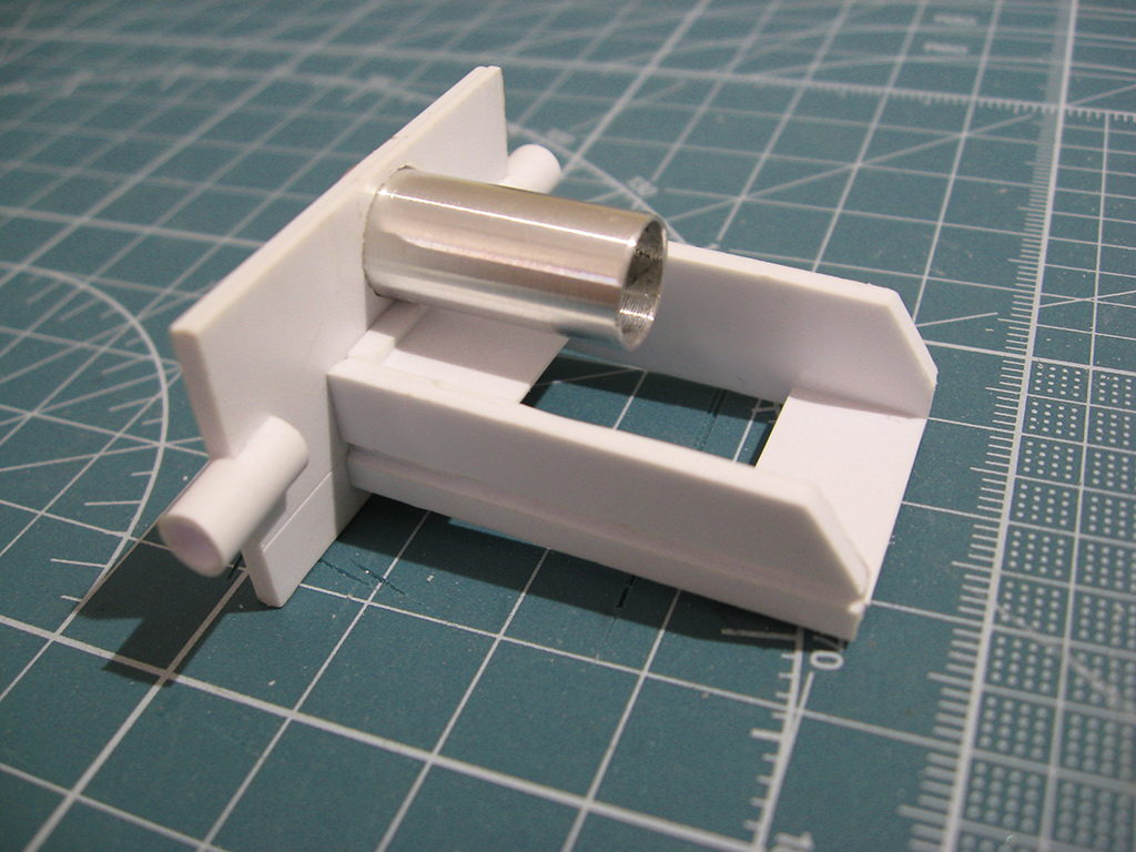

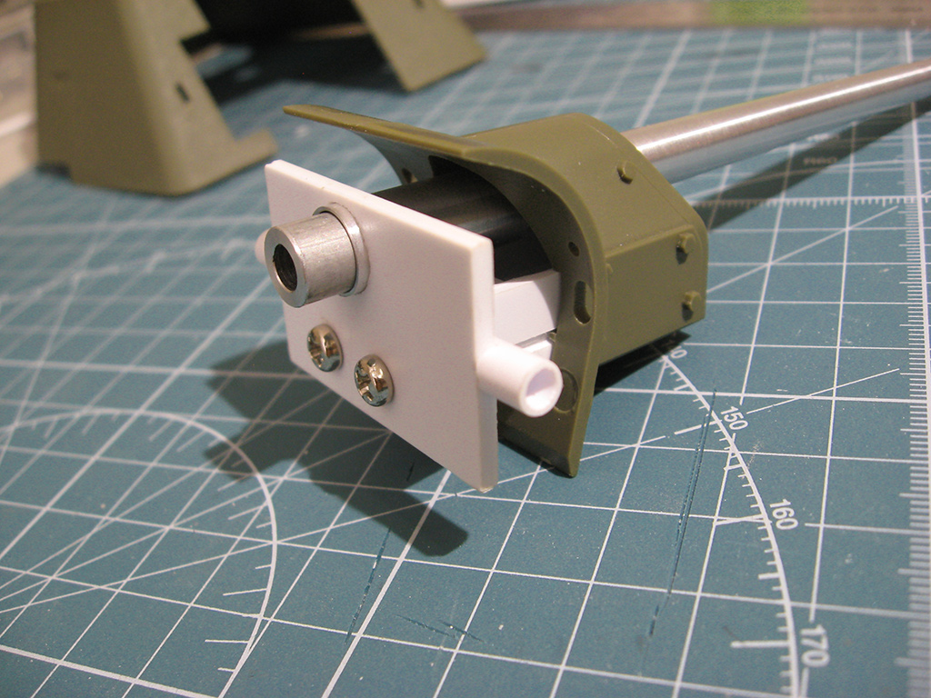

Not much accomplished this week, I've spent most of my time trying to figure out how to get the Asiatam elevation/recoil unit fitted to the turret in such a way that it'll actually work. I think I'm going to have to give up and go for servos instead. If that's the case, at least I'll be able to reuse the gun mounting I've made up:
