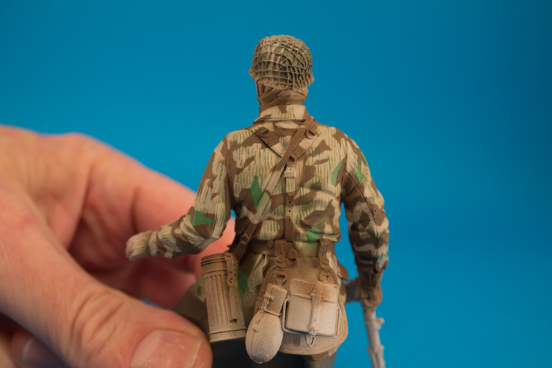

As has been said its horses for courses, but depending on what sort of camo job you are doing and whether you are looking to do highlighting, colour modulation, pre and post shading you will struggle with a brush. Things like soft edge camo will also be much easier with an airbrush. If you really like using a brush then I would never say you shouldn't but I can't think of much on a tank where brush painting gives superior finish or is quicker.

I have three Iwatas and a host of the best Series 7 Sable brushes available and short of figure painting, tiny detailing, weathering or touchups, there is no instance where hand brushing is superior to airbrushing for models.
Even small things like tool heads, etc benefit from airbrushing.
I'm not saying that you can't get good results by hand brushing, but if you invested the time and effort to pull that off into getting better with an airbrush, the results would be staggering.
Paint formulas are getting better for hand brushing in the past few years, and there are reasons why not to airbrush (noise, cleanup, etc) but if you have access to both, there really isn't a question in my mind.
Here's the base coating of a splinter camo all done with an airbrush. I would never be able to get that flat with a hand brush. After covering it, I'll go in and do the details with a brush. The three splotch colors were masked and the splinters were sprayed through a small PE screen.

How did you do the masking? Very inpressive. Figure work is some where is like to start using my airbrush more but have struggled to get to grips with.
