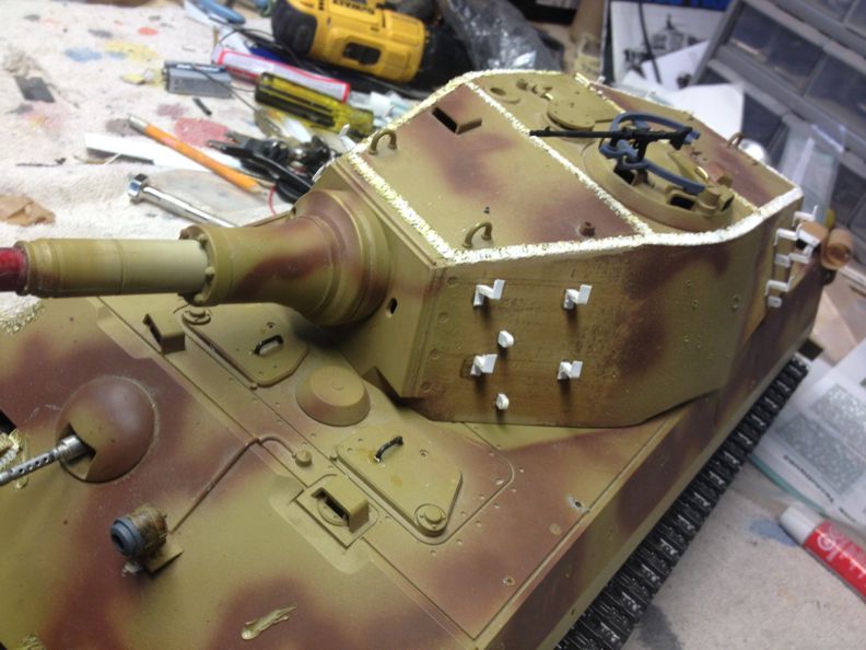

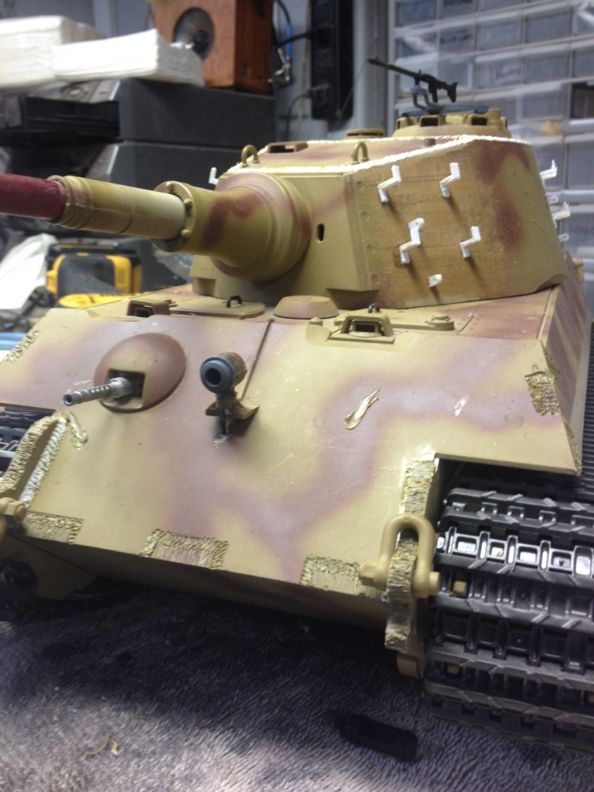

Messing around a bit more this evening. I lowered the rear armor plates over the engine deck. I also fabricated the spare track mounts on the sides of the turret. Then I decided to bbq my fingers by creating the weld lines with a very hot soldering iron and some styrene round stock glued in place. Was going great till I decided to try to use two hands for the project.
I am blaming it on the beers.
I found a bunch of small Panther parts left over from my Ersatz build and decided they would be handy with this one as well. I changed over the rail on the commander cupola and added the MG to the mount. I took one of the lights from that Panther parts bag and modified it for the KT main light on the front.
I am not too concerned with recreating an actual documented tank. I am going to treat it like...I was the commander and I had the ability to scavenge what ever I wanted for it when I ran across it. So, with that in mind, I am considering a Vampir Infrared system on it, which I can use to hide a laser used for target acquisition in the local IR battles.
Having too much fun with those lasers.
Pale

- Posts: 11861
Re: Pale's Tamiya KT
Thats looking the business Mr Pale
I also notice the glacis plate strike marks ! Nice detail......
I have had thoughts on how to recreate those in scale since doing one on my Jagdpanther a while back..............
After seeing the strikes on the Jagdtiger at Aberdeen PG, & the front of '213 in La Gleise, the only way to get the scale depth is to add material to the inside of the area and bloody near use a melon-baller to make the gouge !!
The marks are very deep and sure do take a lot of armour out.
I can only assume these are 76mm rounds, fired close in after the beast was subdued, just to see if they could get one through......nope, not one.
