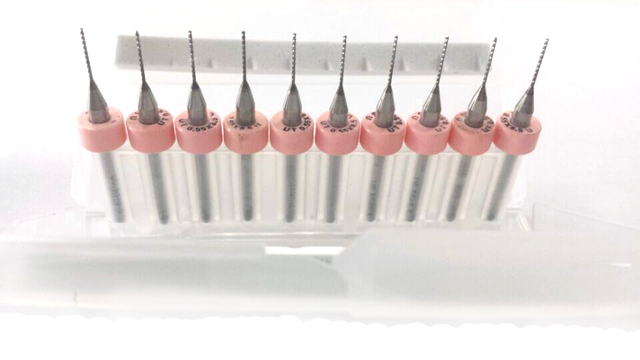

MAN ...what are you all drilling??????????? :wtf: ....I generally drill plastic...have had a set of Squadron bits for decades...and I only broke one of those...Heat is definitely your enemy...bits this tiny are susceptible no matter what they are made of...they can loose their temper in seconds...reason why manual pin vises are good ;)
Spoiler: show
MADE BY MICROMARK...the smallest bit is the one that broke...and that was because I chucked it in a power drill
Now if you are drilling stainless or titanium then you are talking a different story...but I don't know of any RC tank made of that stuff yet :wtf:
Posts: 10960
Re: Pin drills
Post by ALPHA »
This type is just O k ...never had much luck with them...they always break after the taper
Spoiler: show
they actually work better after the tip breaks off..then you can chuck it at the tip ...there is too much flex in the small part of the bit where the cutting edges are ...the thick shaft is strong yes...but it's useless once the cutting edges are gone ...unless you are just going to use that part to jab someone out of frustration :haha: :haha:

RobW wrote:Use to break 3mm masonry bits all the time at my old house. They built a load of Sheffield terraces with blue (engineering) brick.
:wtf: ...So what are we talking here....You going to drill holes in your model or cement :/ ...Cause that set you're asking about will never go through cement ..they are made for plastic...and will probably serve you well so long you don't put pressure on them like you are drilling cement :haha: :haha: :haha:
