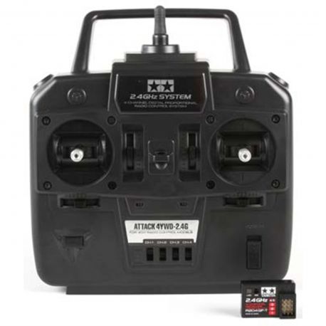

Just out of curious, so what is Tamiya's remote controller out of the box? Do you have to upgrade remote controller after buying a Tamiya tank?

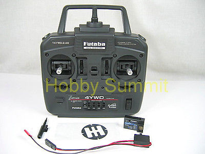

Tamiya ships with a re-batch Futaba 4 channel radio if you purchase the full option with radio/receiver.
Tamiya:
Futaba:
