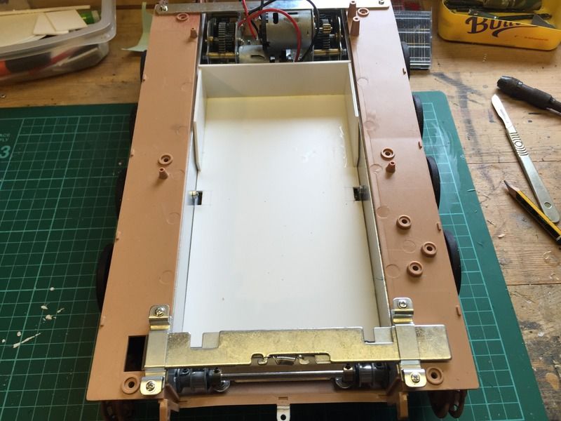

Belief it or not this build is still slowly crawling forward, just not had the time to do much on her as I would like.
Made up a internal tub with some 1mm plastic card ready for all the control boards and other gubbins.

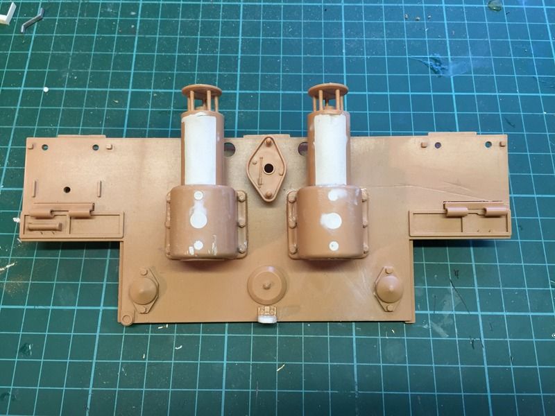

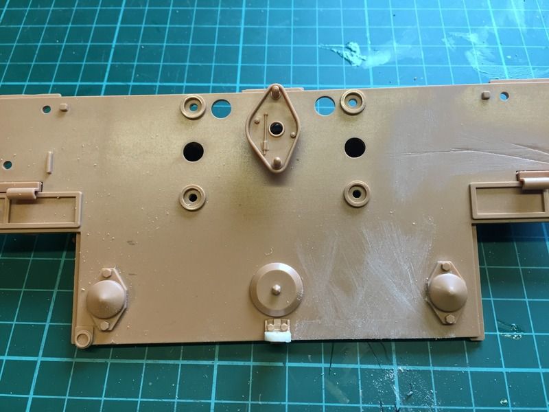

Ripped all the fittings of the rear end

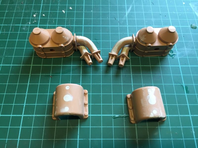

And filled holes and slots etc, with filler (though I have a sneeky feeling that the air filters are gonna be the wrong type and I might have to try and make some of the earlier ones ??) any advice ??

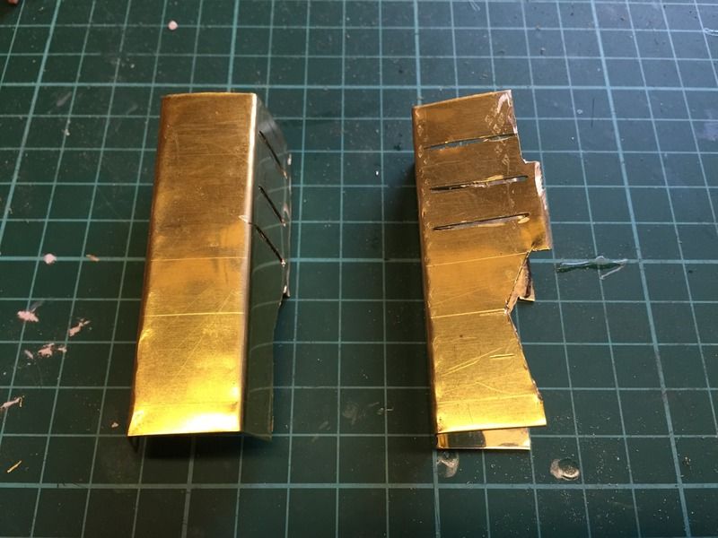

The exhaust pipes have a dirty great big slot in them, and as I have no intention of fitting a smoking device in her, they were filled in and sanded down.
Then there's the exhausts rear guards, which off course have to be different to the curved type which were normally fitted, so I got some 0.5 mm brass sheet, marked out a design which looks ok to my eye's, cut em out and bent them to shape (from what I can gather these were made in the field anyway so there's going to be a fair bit of artistic licence involved)
More later
