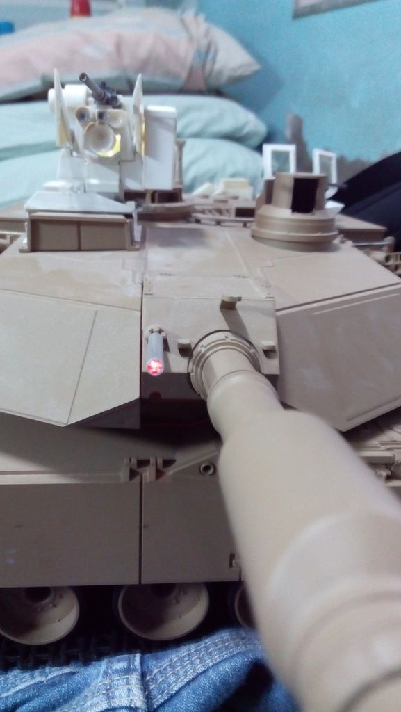

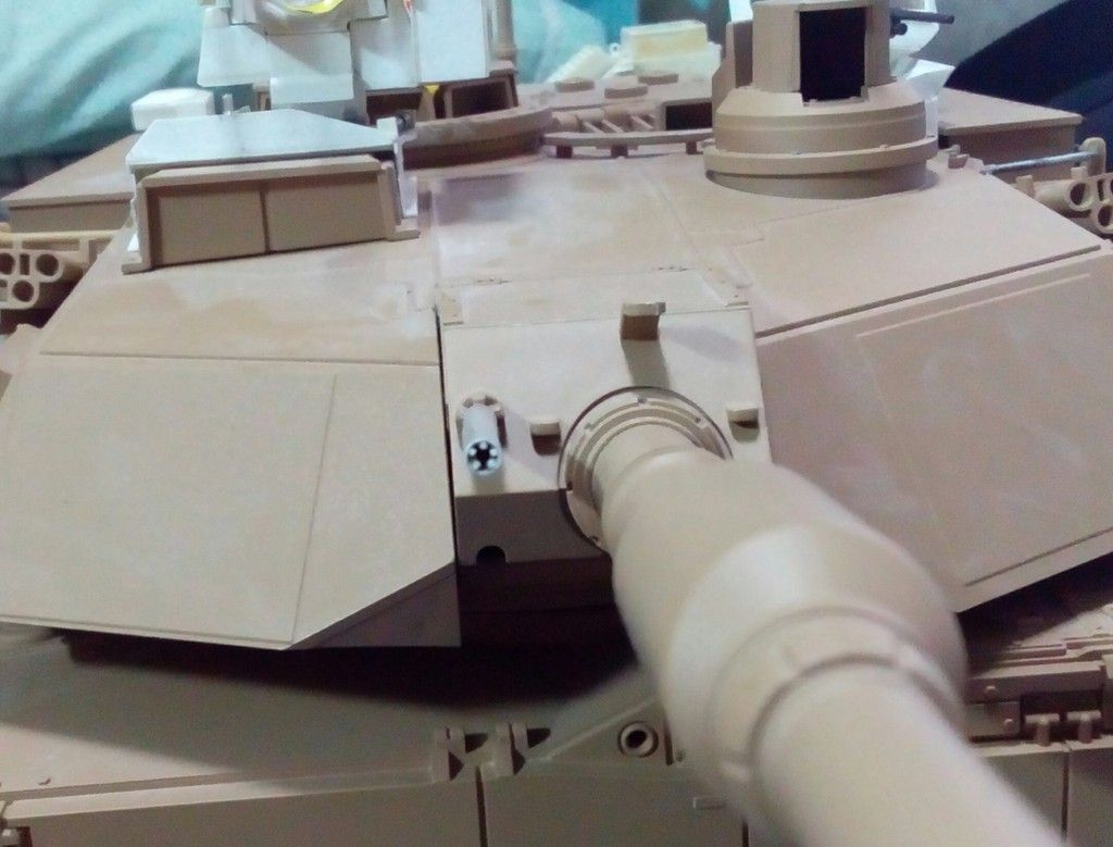

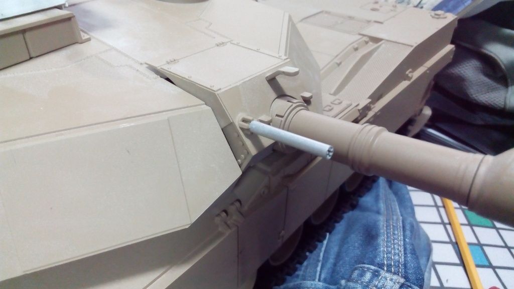

When the tank arrived, it was missing the coax tube. So I used brass tube, aluminium tube, and cut really small pieces of styrene for the coax. The brass tube I first inserted to the mantlet. Then after doing the coax tube, I inserted the aluminium tubing over the brass one:
Had I used plastic tubing, the flash from the red LED might've shown through the entire length of the tube. Fortunately I had appropriate sized aluminium and brass tubing lying around.

That looks good....and a good tip.

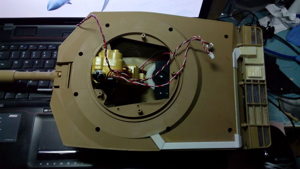

Well, I decided to convert the TC's weapons station to one that looks more like that found on the SEP v2. I used a hobby saw to cut away most of the plastic. Fine cutting done with knife. Fill and sand to smooth. The white ring is styrene strip wrapped around, two layers.
Also did the details connecting the vapor compressor thingy to the turret. I took greengiant's idea of modifying the turret lower half by sawing off the rear panel and gluing it to the upper part. I've yet to smooth things out to make that area as seamless as possible when the bottom part is screwed in place. The duct is made in such a way that the bottom turret part can be removed without issue.
A side note: when opening the turret, I noticed that the turret elevation unit wasn't screwed properly to the upper turret half. I then found that's because two of the mounting posts were broken, which explains why my M1's main gun always had an elevated gun. I've fixed that already but I don't think it'll last, so I've got to get a new electronics package soon (IBU2Pro hopefully) to support servo actuated elevation. In the meantime, a bracket will have to be made to help keep the elevation unit in place. That or longer screws.

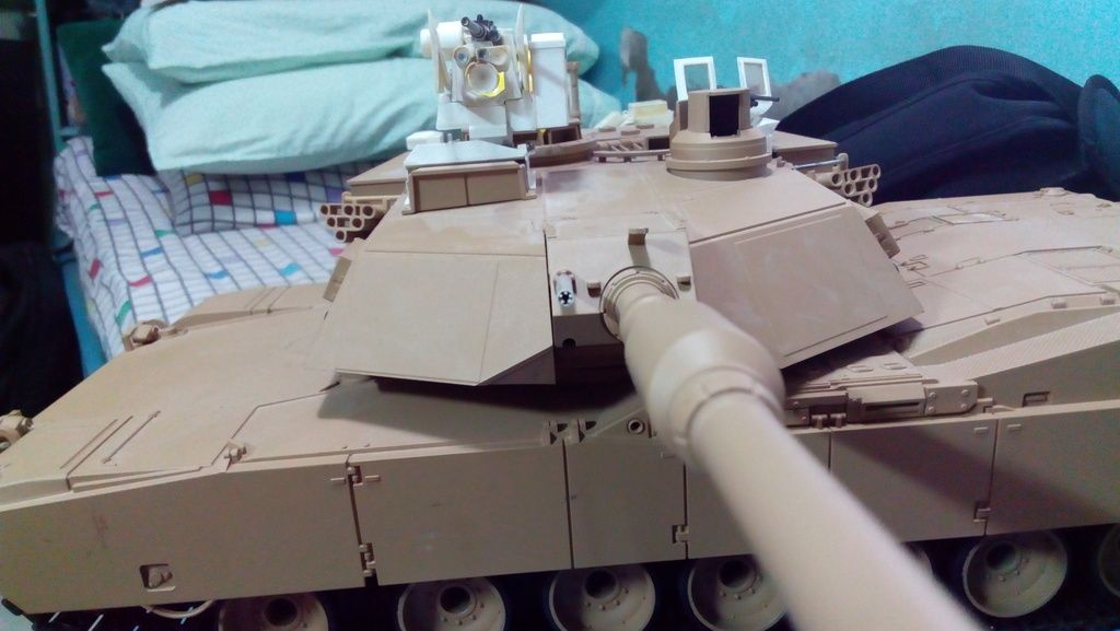

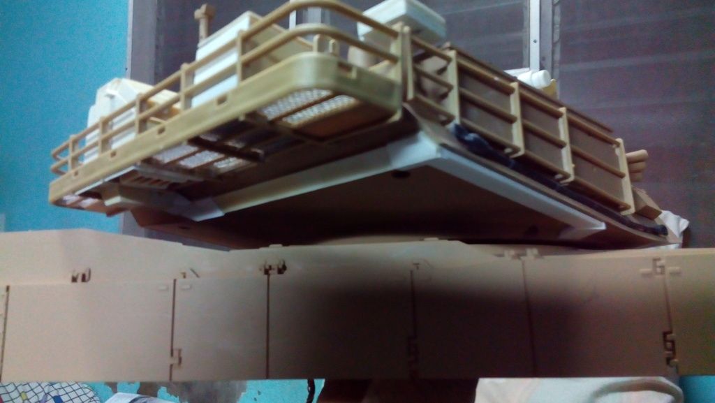

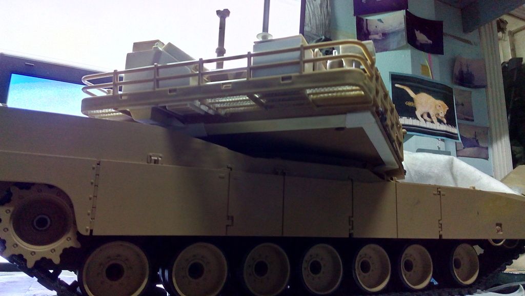

As expected, the extended bustle rack is going to be the second most complicated item to build (after the CROWS 2). Construction of the extended bustle rack is halted for the time being because I don't have styrene rods - I forgot to buy some yesterday. Although I think I'll use brass rods instead as that is stronger. Current state of the extended bustle rack:

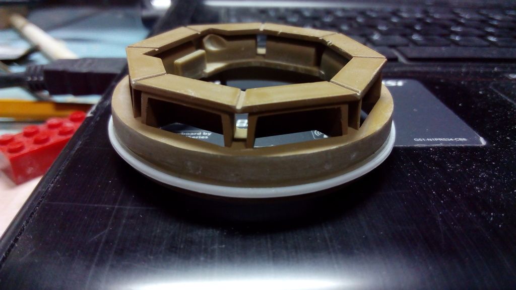

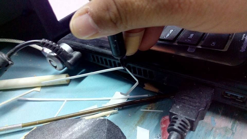

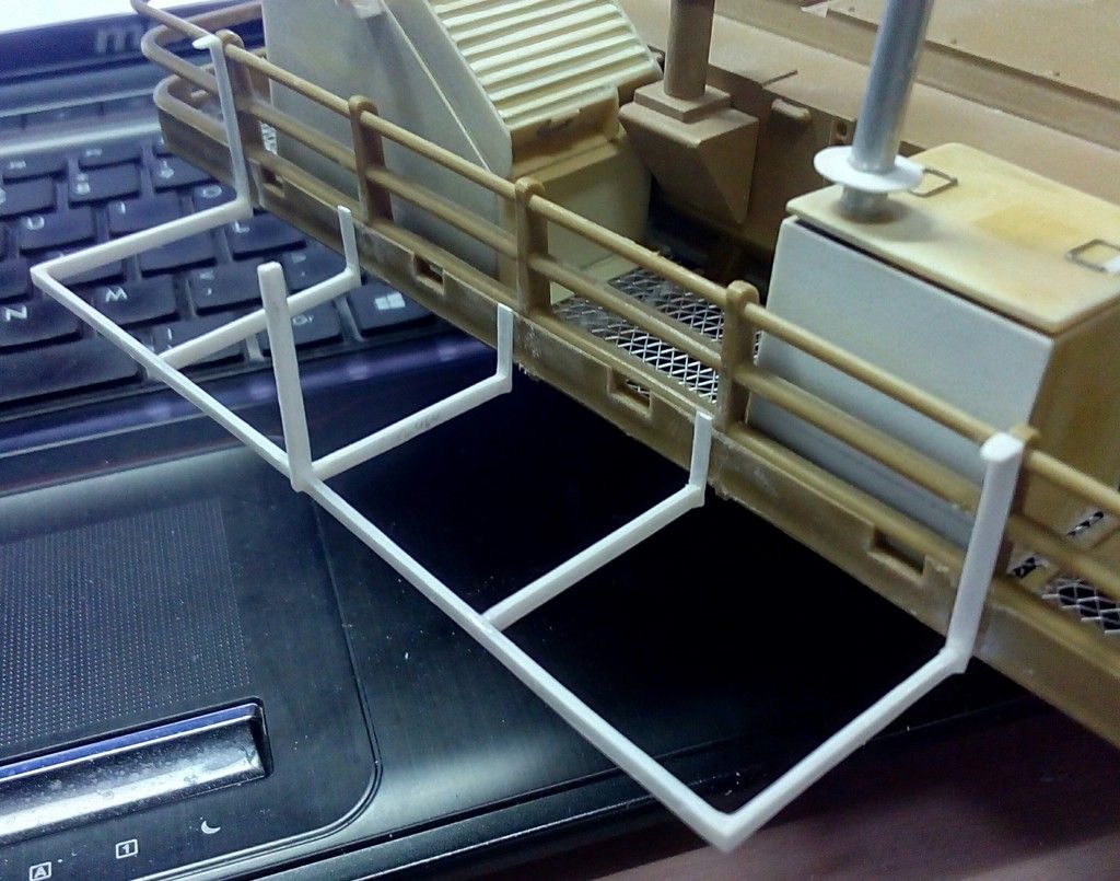

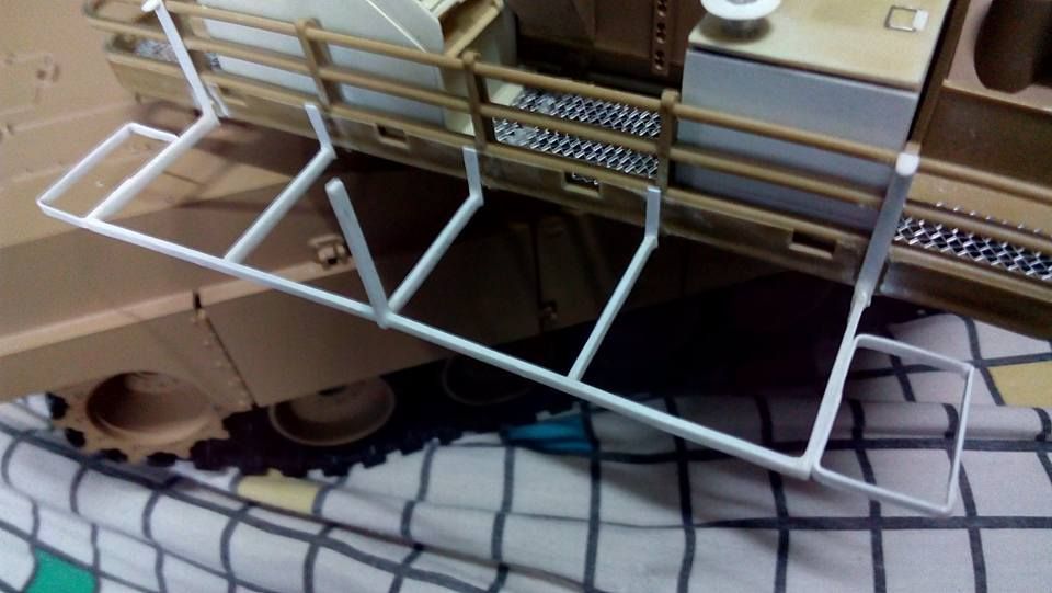

A few more pix before going to bed. Not much really. Have gaming laptop, will heat-form styrene:
In order to make the jerrycan racks at either side of the extended bustle rack:
Construction of the extended bustle rack will have to be postponed until I get brass tubing. In the meantime, I'll focus on the hull stuff.
