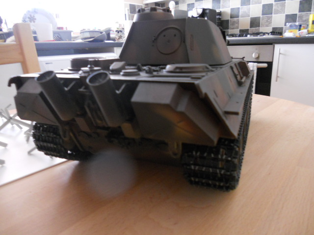

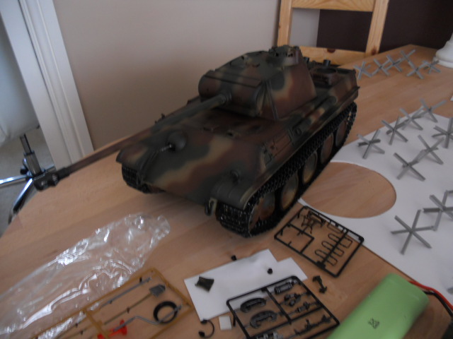

Well that was astonishingly quick delivery, just took delivery. It weighs a ton,
Have to say that the paint is absolutely top class and lacquered, I could not do a better job if I tried. Over the moon with it!

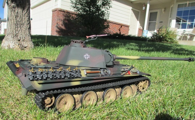

Nice looking Panther, I've had my eye on that one myself. I bought their metal Jagdpanther and am very happy with it. The only disappointment for me is the gun. I am an IR fan, so I don't like the way the recoiling barrel makes the air soft winding up noise before firing. I have done a repaint, installed an IBU2, a TBU, metal hatches, and a metal muzzle brake. Good luck with your Panther.
