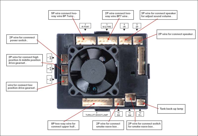

The Taigen set of wires come with two 2 pin ones for the motor which you don't need since you are re-using the motor leads from the WSN....... Also, I noticed that you have purchased a proportional smoker, which means that you will have to wire them up to the motor leads to control the proportion part. The elevation, rotation, headlights and MG all go onto the 8 pin cable but you are missing this piece I think:
heng long rc tank 8 p port.JPG (15.46 KiB) Viewed 4086 times
If you are handy you don't really need it and can try to connect them directly to the MFU. Also this might help as well:
There should also be a 3 pin wires for the volume control. If you don't care for it you don't need it. Just jump pin 1 and pin 3 and you are at max volume.
Michael.

The MG and light needs some soldering anyway, so will skip using that board. Thanks, wasnt sure it could be done.
I found this diagram, I think might work, but instead of soldering/connecting the MG, Lights and rotation unit to the board, I will just make it into an 8-pin connector, yes?
MichaelC
Posts: 2449
Location: Toronto, Canada
Re: Replacing WSN with Taigen 2.4ghz electronics
Post by MichaelC »
For sure. You can snip the connector on one end and just solder the wires to it directly, or if you have the tool just create different plugs and hook them up that way. You don't really need the board.
